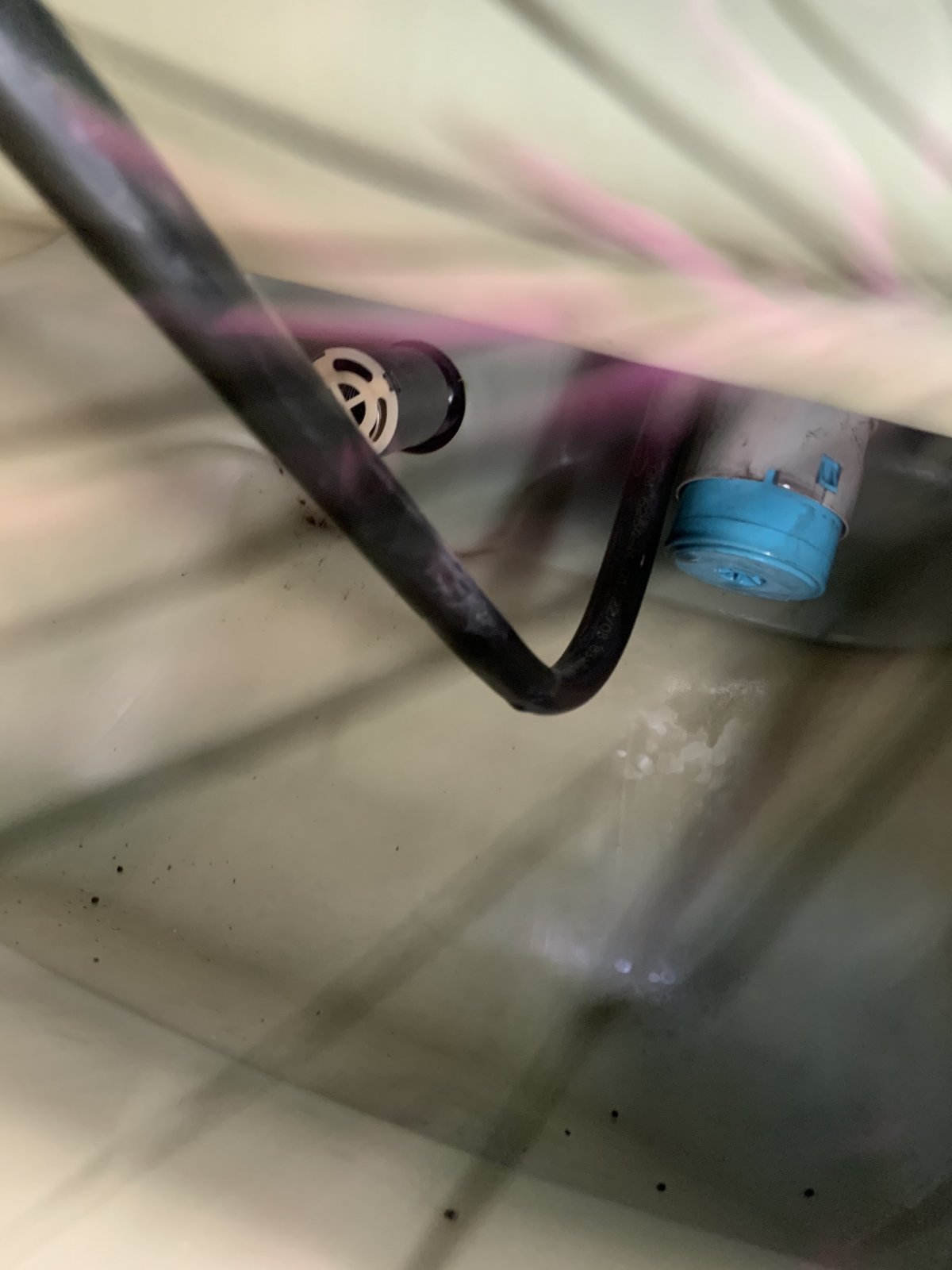

Hello all,
I had the charcoal canister guts all up in my evap lines. I managed to clear them all out after dropping the tank. I still have problems at fill up where the pump clicks off every half second. I believe this is my culprit but have not seen any documentation on it. Anybody know what this vent valve inside the tank is called? The blue one is what has been venting pretty slow when I apply air pressure to the entire tank.

Don't know the answer to your question. Did you replace the charcoal canister or wash it out? Did the vent and purge valves/solenoids require replacing?
I replaced the canister. The solenoids are all working. I disconnected all that from the tank and the main vent (that blue thing) will not let air escape quickly. I can apply pressure to the tank and it balloons up. I removed a ton of charcoal from the lines and that’s the only thing left that I cannot confirm if there is any more charcoal in that blue valve.

That's infuriating after all that work. I'm curious if this was an OEM GM canister or aftermarket. I ask because some aftermarket canisters failed immediately after installation. Hopefully this hasn't happened to you.
