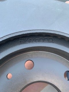

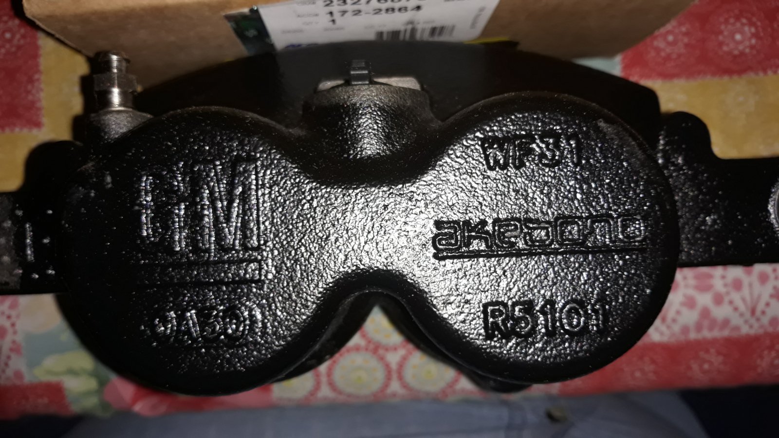

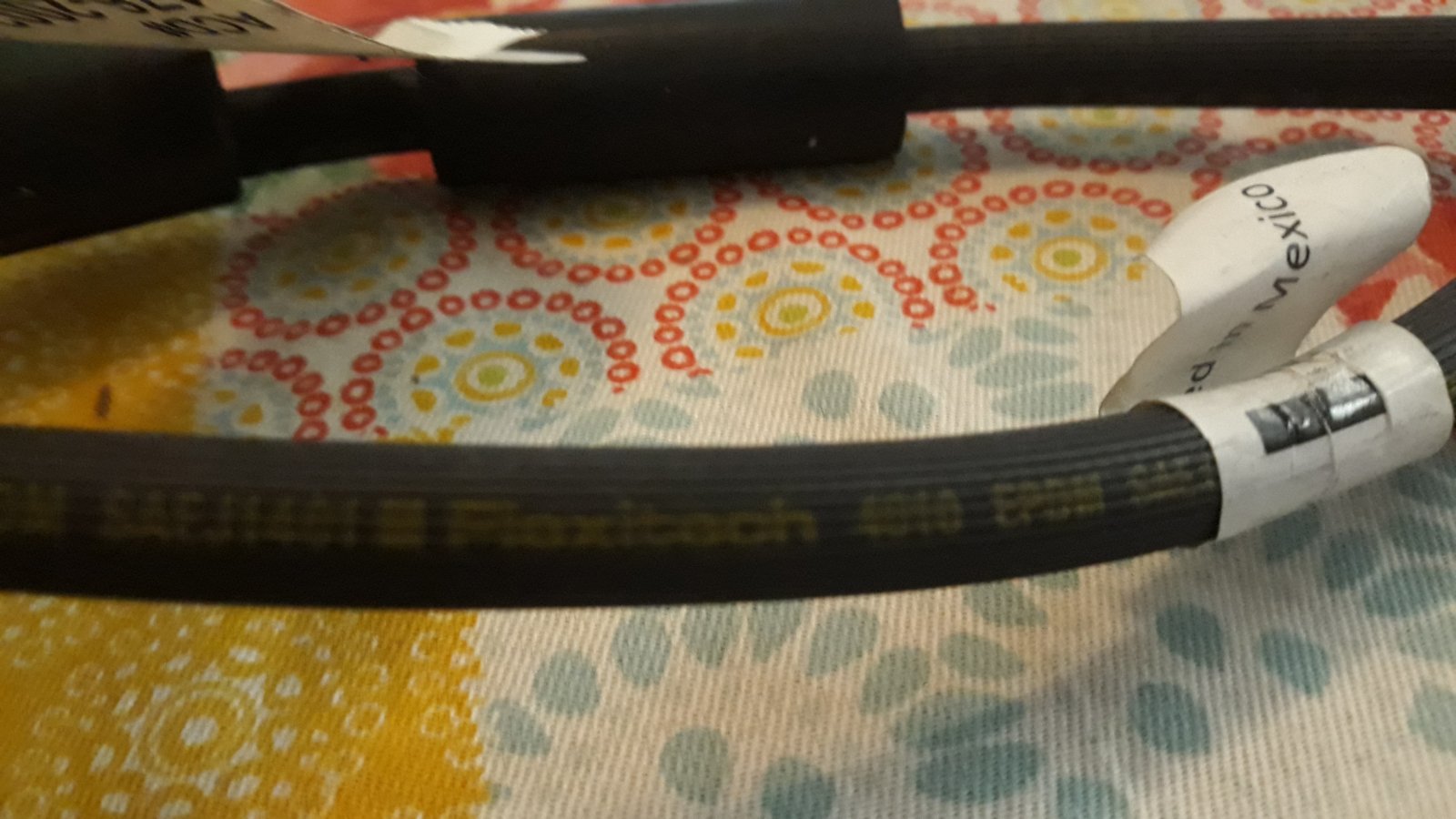

Well, the RR caliper is drying in the oven but I did take photos of some of the front brake parts.
The OE calipers were Australian, from a company called PBR Brakes USA. The new replacement Calipers and Rotors are Akebono. The new OE hoses are Flexitech.
The front and rear pistons are the same. Checking with Rene to see if the seals and gaskets are as well. When the RR caliper comes out of the oven I'll look for makers marks.
