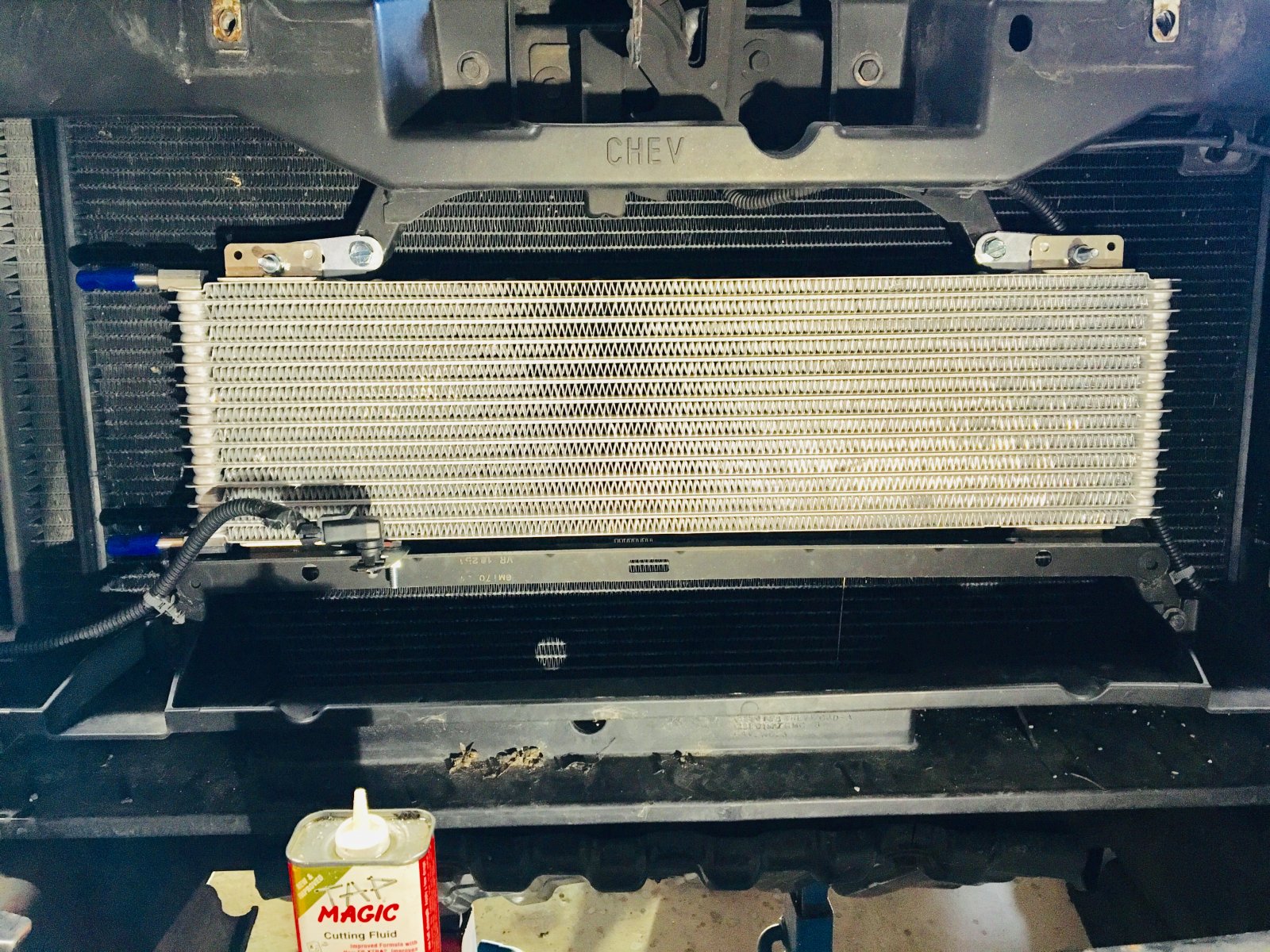

I read about all that stuff before I bought my 18 silverado and then I added a tru cool 40k to it, removed all the internals and tapped the thermostat open, added a b&m deep trans pan now it runs about 140 ish mostly or less even beating on it pretty hard and that's far beyond how normal people drive. It's the same system on the tahoe, yukon, sierra, escalade, suburban, denali

If you tow I’d still consider adding an additional cooling element. For my ‘09 Tahoe I added a Tru-Cool Max external element with a cold-weather bypass valve. Obviously you wouldn’t need said valve. This kept temps way down when pulling my 5500lb travel trailer. This kit was $105 shipped so shop around for similar models.
