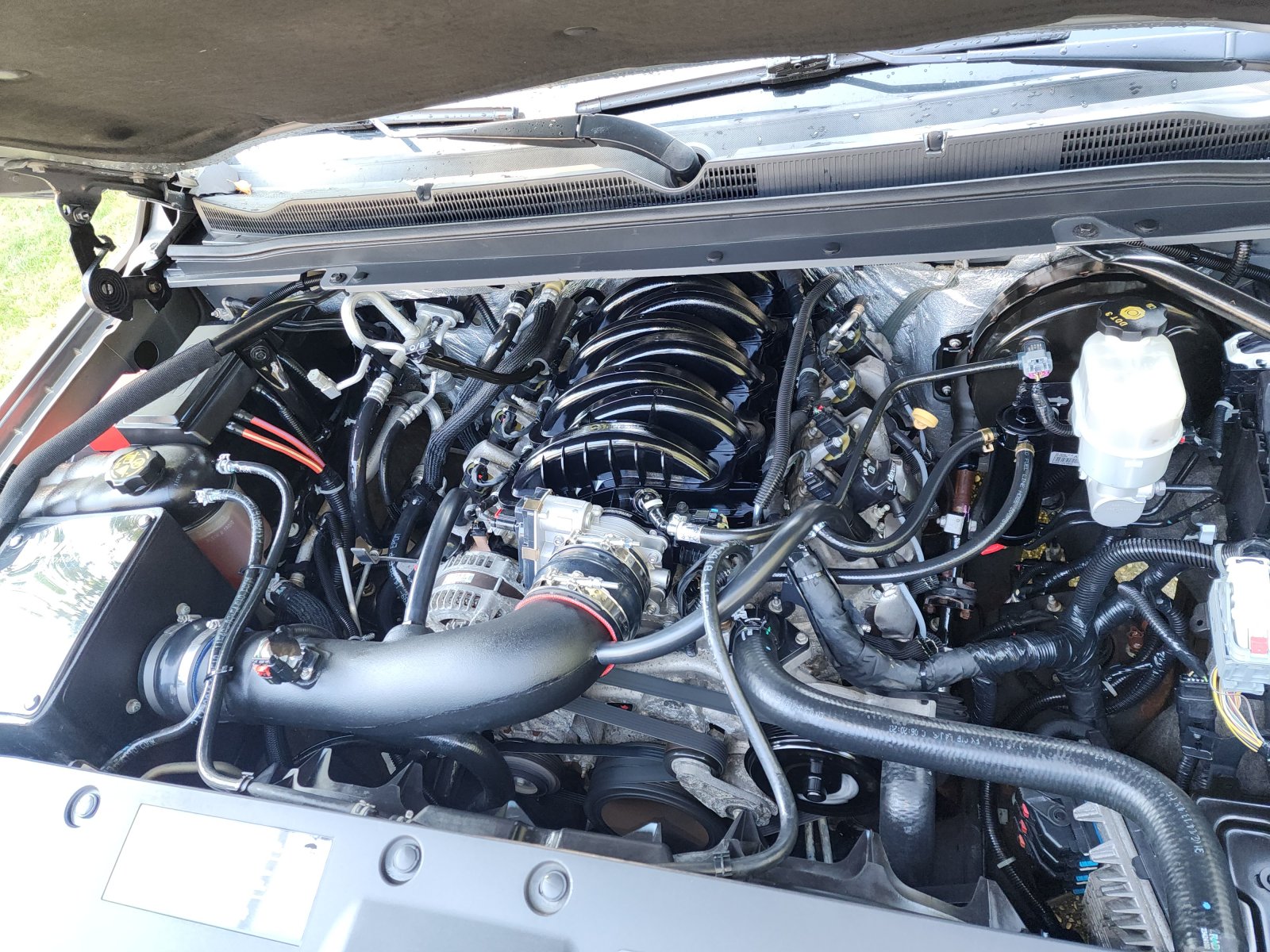

New member long time lurker from long island NY, This site has tons of great info on it just figured I would share my Tahoe. 18 Tahoe LT 74k miles
Has about 100 miles on the odometer since I went ahead and did some engine mods. At the moment I have Black Bear Performance tuning the vehicle with their supplied Autocal V3 so hopefully that goes great if not I might have to look into a local tuner with dyno
Mods
BTR AFM DOD delete kit
Cold Air Intake
BTR CAMSHAFT - GEN V TRUCK - STAGE 2 V2 - 2241023116R1
Specs: 210/223, .540"/.540", 111 LSA, 14% fuel lobe
INTAKE LOBE LIFT @ TDC: 0.04742
BTR .550" LIFT GEN V LT BEEHIVE VALVE SPRING SET
BTR VALVE SEAL SET
BTR CHROMOLY ONE-PIECE PUSHRODS - 7.850" LONG - 11/32" DIAMETER - .080" WALL
BTR GEN V LT VVT PHASER LIMITER - 4 DEGREES - BTR-VVT-GENV-4CAM
DOD conversion plugs installed
ARP head bolts kit installed
LS7 Lifters
L86 6.2 Intake manifold Ported and ported to match 95mm TB
Lengenfelter 95mm TB adapter
LT5 ZR1 95mm Throttle Body
Texas Speed Long tube 1 7/8 headers with high flow cats (arrive late sept)
CORSA Cat back 3 inch exhaust part# COR14859BLK (in the garage will install once those dang headers come in)
have installed Cadillac CTS-V torque Converter GM part number 24045127
Superior STL010 thermal bypass for the transmission to keep temps down
Coolant Thermostat has been changed on engine for 180 deg
Vacuum pump on engine has been removed and installed the vaccum pump plugs
Oil catch can isntalled
New set of NGK Ruthenium HX spark plugs .040 gap
Since I had the tahoe down for couple weeks I also went ahead and did full trans fluid replace with filter, Rear diff, transfer case, front diff all fluids replaced with Amsoil fluids.
