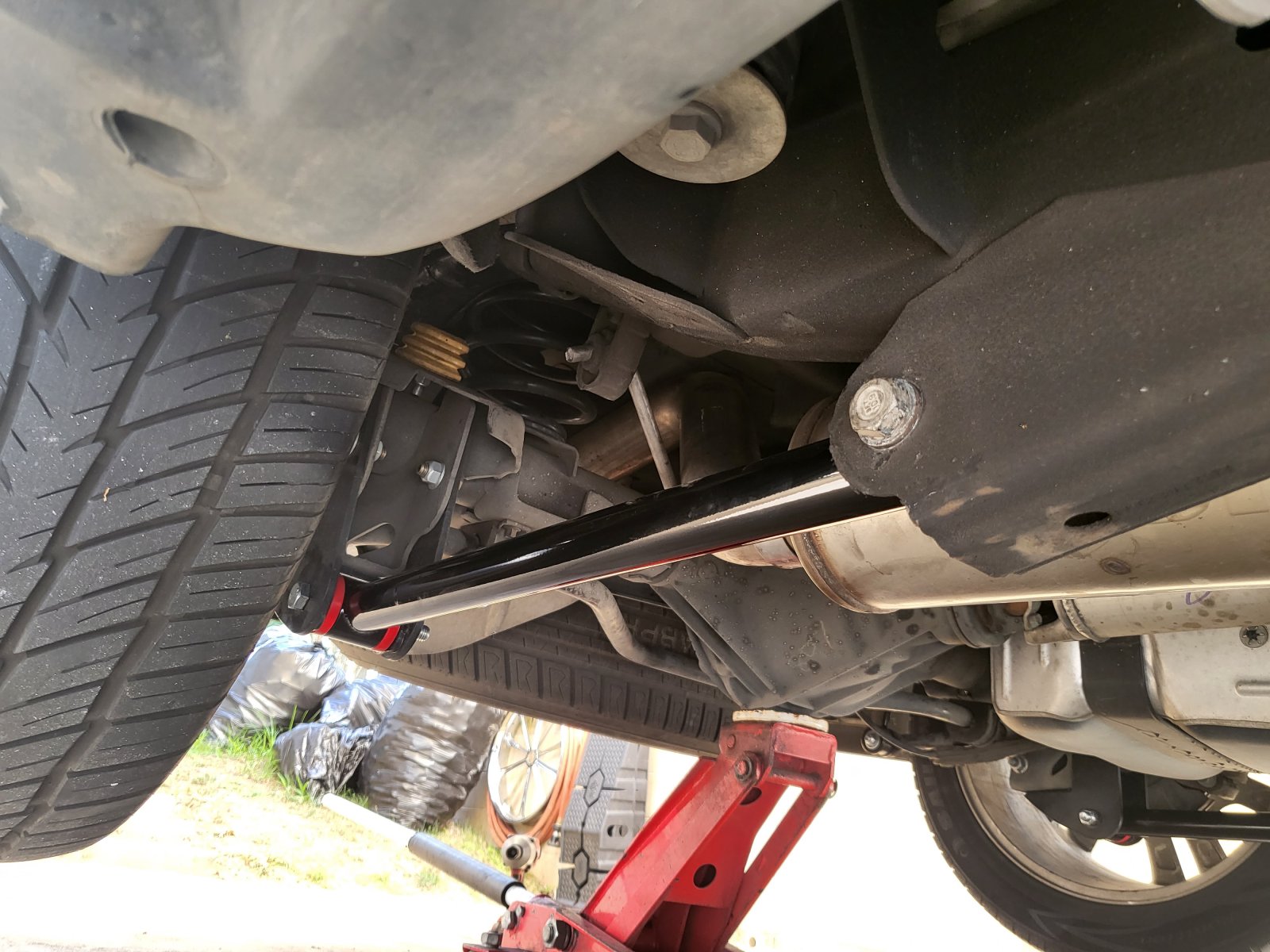

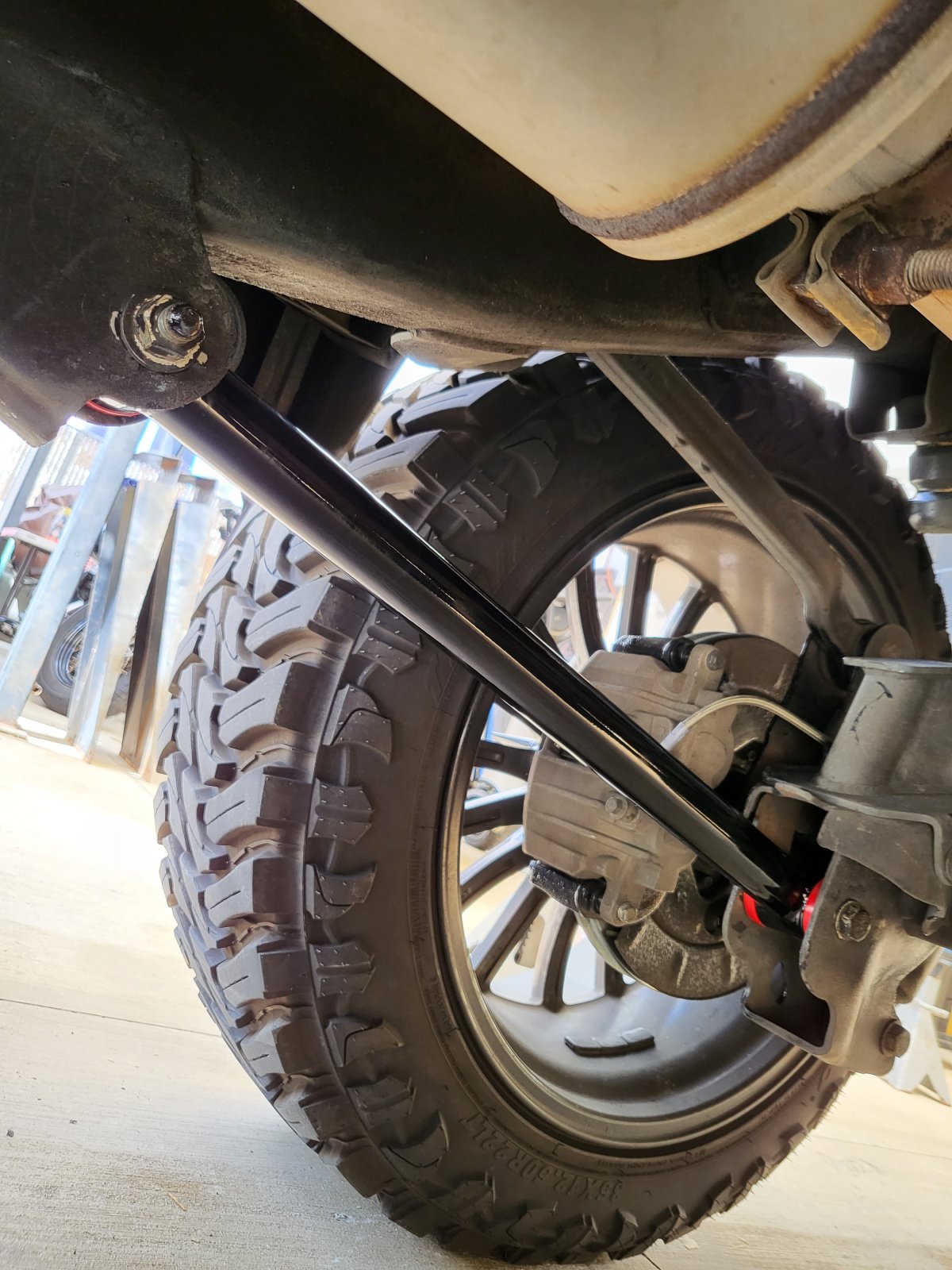

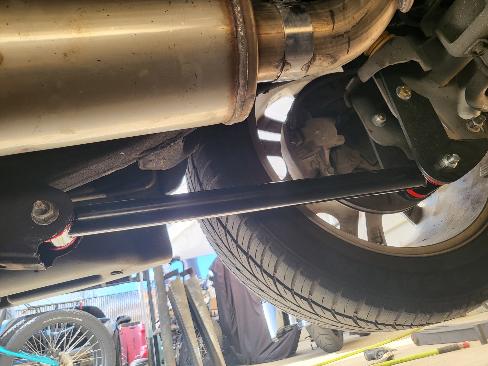

Hey everyone, its been a while and a few cars since ive posted on here. But ive got two suvs and I just did some trailing arms on both of them. I had sphon arms on my escalade and they were good but I was looking for other options. I bought some GM A body control arms and they are a damn perfect fit on our suvs. Some one chime in if this is something thats already been covered. The lengths of the A body arm is identical to our trailing arms at 22" the bushing is 3/16" narrower on the A body so I put washers on both sides of the bushings to take up the space. All in all it was a good fit and gives more options when looking for trailing arms. I bought black arms without the swaybar mounts so there would be no extra holes in the arms. Ive attached some photos of my 2017 yukon xl with a 3/5 drop and the A body arms installed and the other is my 05 suburban that has a 8" suspension and 2" body lift on 35" tires.

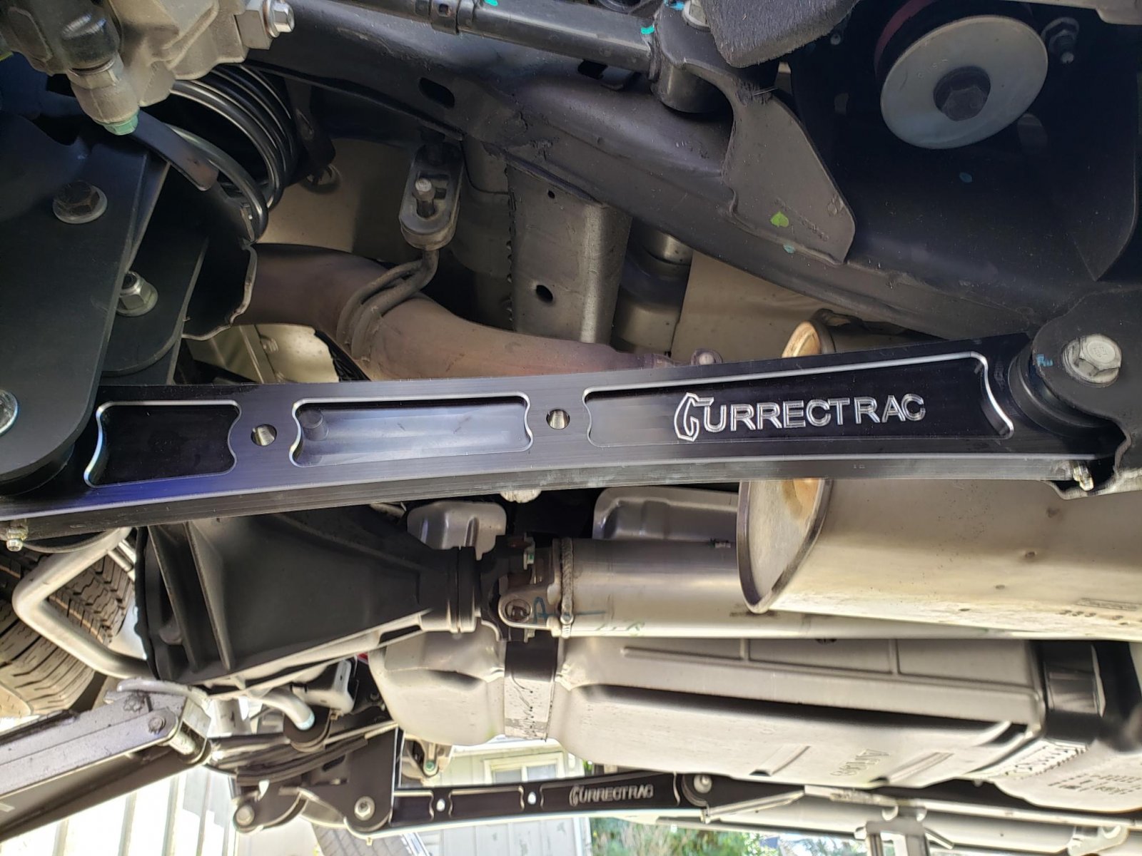

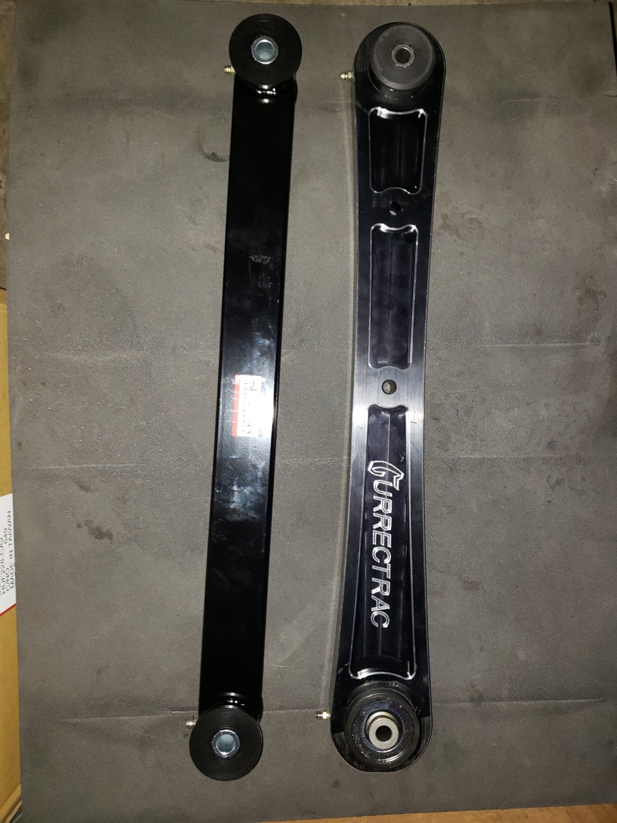

I ran billet Curries made for GM A-body, pictured next to the Sphons. For more of an off-road style, they make them for Jeep Wranglers that are close to the same length with adjustable joints and replaceble skids.
View attachment 352048View attachment 352049

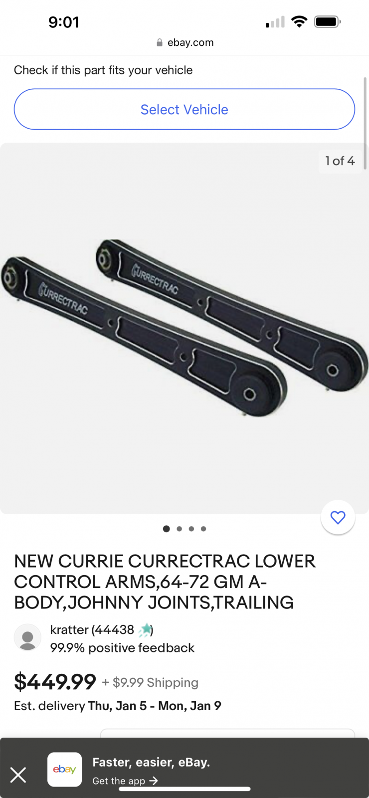

The arms I bought were on ebay and they were Control Arms Lower LCA 64-72 GM A Body Chevelle Cutlass GS 442. There the exact same length as the yukon arms just slightly more narrow.
