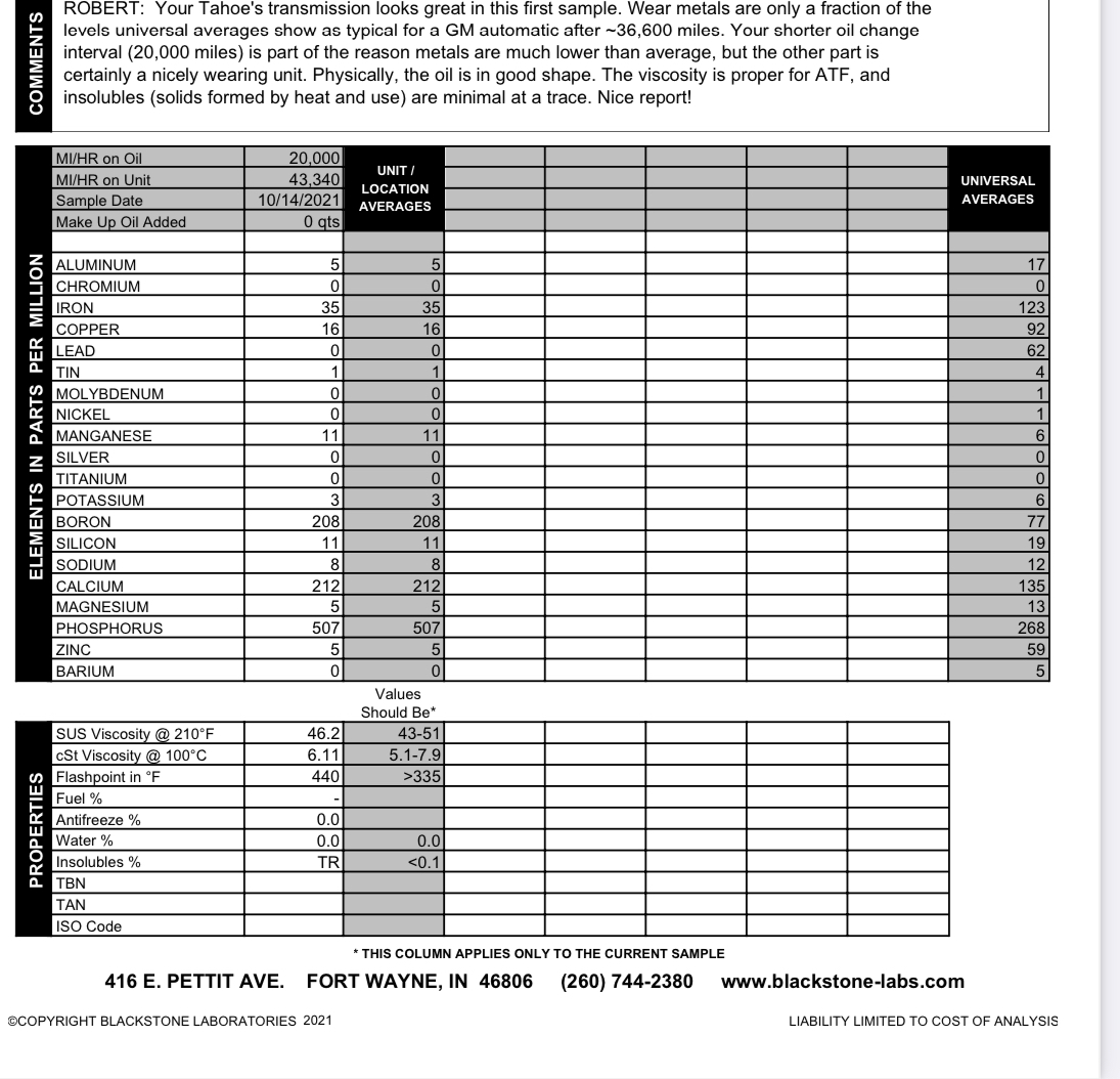

Just though I would post my analysis I had done. Sample was taken during a 5qt refresh after 20k mile run using AMSOIL SIGNATURE. Factory fluid was changed out at 24k miles to AMSOIL. (Approx 10 out 12 qts). Now have 44k miles on vehicle. I am very pleased with the report.

View attachment 354420Just though I would post my analysis I had done. Sample was taken during a 5qt refresh after 20k mile run using AMSOIL SIGNATURE. Factory fluid was changed out at 24k miles to AMSOIL. (Approx 10 out 12 qts). Now have 44k miles on vehicle. I am very pleased with the report.

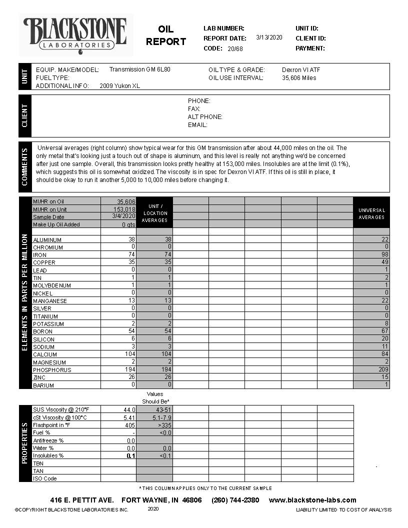

Compared to mine yours looks great!:
Haven't driven much but maybe I'll send off another sample in the spring.
