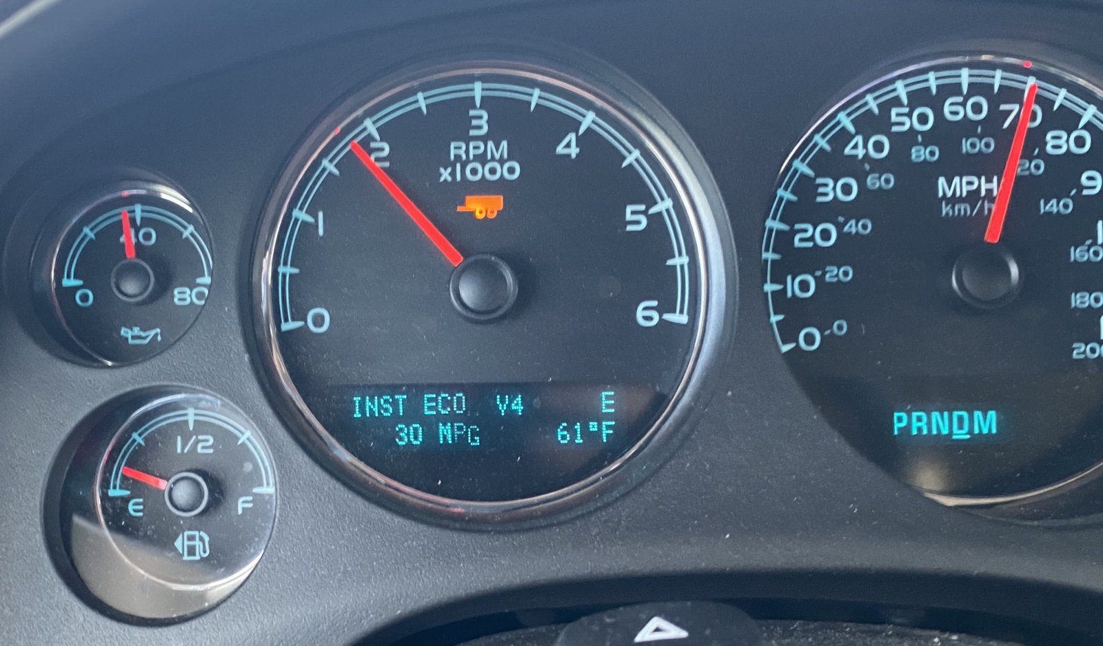

I bet its the AFM doing weird stuff, mine kicked in during lower speeds and it drove me crazy......so I had it turned off. I haven't changed out my lifters yet though, YOLO.
Someone correct me if I am wrong, but pretty the button on your DIC and get to the Economy screen.......you should be able to see it go into "4cyl" mode, which indicates AFM is active.
It doesnt show that at all..just shows trip monitor and trans temp and a couple others
