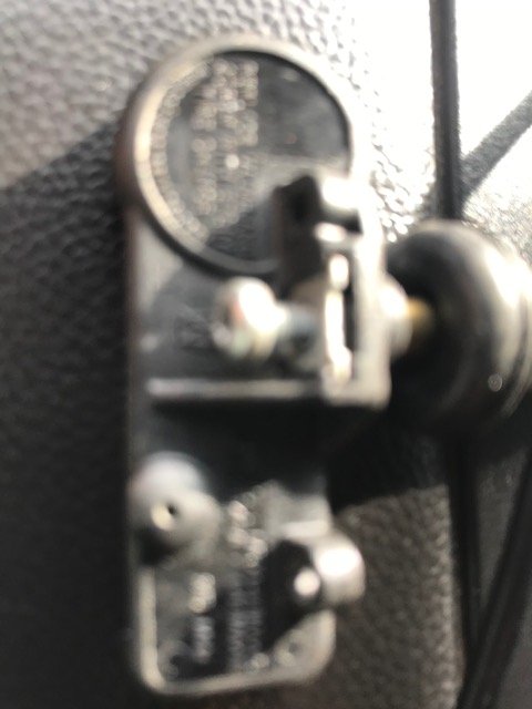

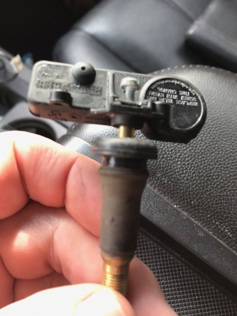

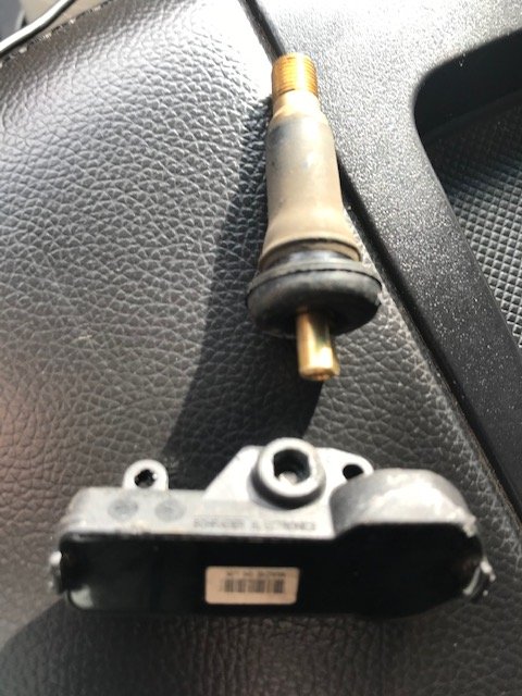

I kept the old sensors and can post some pics if anyone is interested in seeing them? Most people are probably familiar but to me it was interesting to see how the setup works. The stems are a replaceable part and just thread onto the sensor.

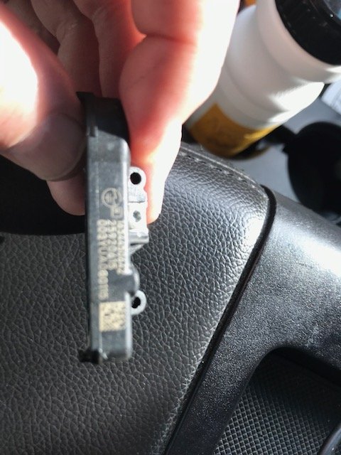

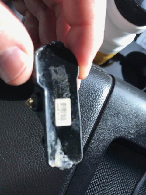

2009 Chevy Tahoe. I am not sure about any part numbers etc for new ones as Discount Tire supplied and installed them. These pics are of the old ones and I am pretty sure that these are original TPMS units. The pics did not come out very clear but there is a note on the sensor that states to change the stem and screw at every tire change. The units are 100% sealed so there is no way to just change out the battery. These were manufactured in the UK.

Thanks for taking the time to post these pictures. They're really helpful! I'm starting to wonder if I can just replace the stem with a rubber one from RockAuto. They sell those there. I need to get my TPMS modules out of my old rims to verify that.
