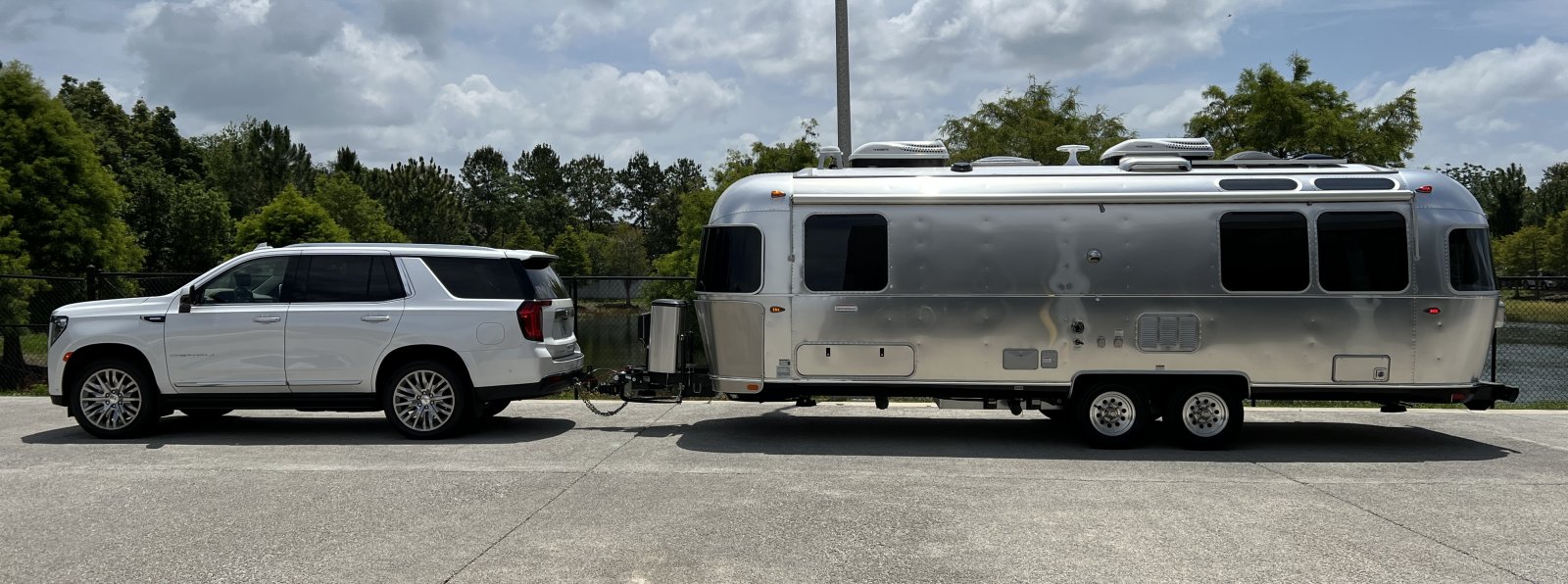

First of all, modern IRS with upper and lower control arms maintain constant camber at different loads so that is not an issue.
I tow a 27ft 2021 Airstream International that could weigh up to 7,000 lbs with 2023 Yukon Denali Duramax and Air Suspension. Use a ProPride hitch that eliminates trailer induced sway. Airstream has a 3” lift kit installed. Rig rides perfectly level and is steady on the interstates.
I would expect so, but my tires beg to differ. We'll see what the alignment shop says this week. Taking it to the guys the Porsche and BMW clubs recommend, since they do a good job on my modified Volvo C70, smh. I don't know of any other good shops.
