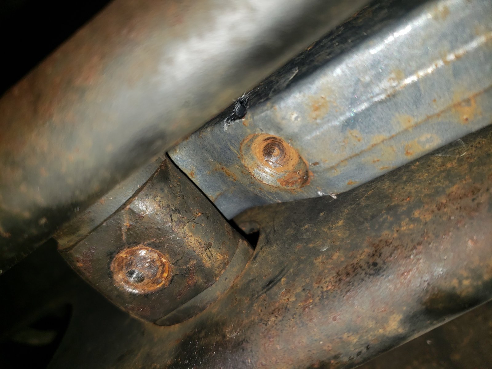

So im no mechanic my friend helped we with brakes once, but im very eager to learn. I went underneath it for the first time since i bought it and i was ashamed. I think it all started with the 2 inch rough country level kit, and i didnt put enough effort into fixing it. i think i took it to shops about 5 times. it had the tire pull and uneven wear. its like trying to ride a bull getting on the freeway. for years. i also did dumb stuff back in the day as well but its time for some love. ive read that the jounces need to be against the lower control arm, and mine are definetely not. i was gonna see if i could loosen the tortion bars until they made contact, and the driver side bolt is snapped off. while i was down there nothing looked happy. i think the coolant has a leak somewhere as well. the right rear shock has a cut wire, for the bottom plug thing. probably why the service ride control has been on for years, or maybe its the ground. seems like everyone is saying that swapping to bilstein 5100s and ditching the air ride. ive had electrical problems too. probably because of my terrible audio wiring which may also contribute to the pump. the heated seats sometimes constantly cycle, and often when its raining. so any insight would be awesome. ive always loved cars but never new anything about how they work, but lately its been really awesome looking stuff up and just getting in there it really starts to make sense. im also new to forums so if this is wrong place or im doing something wrong just let me know.

also it kinda seems like my tortion bars might pop out is that gap normal?

A little gap is normal but I saw yours and thought the same. The keys are wound up and you said it is lifted.

Because of that gap, you may need new lower arm(s). Put some MOOG 81069 rear coil springs in it and some good Bilstein or KYB shocks on the rear and a set of matching on the front. I did the rear springs/shocks swap on my Z71 and could not be happier. Make the suspension and brakes primo and then do a Black Bear tune and you will get the seat of the pants feel you are looking for, especially if you do the Hellwig Performance bars, front and rear. See my build thread.

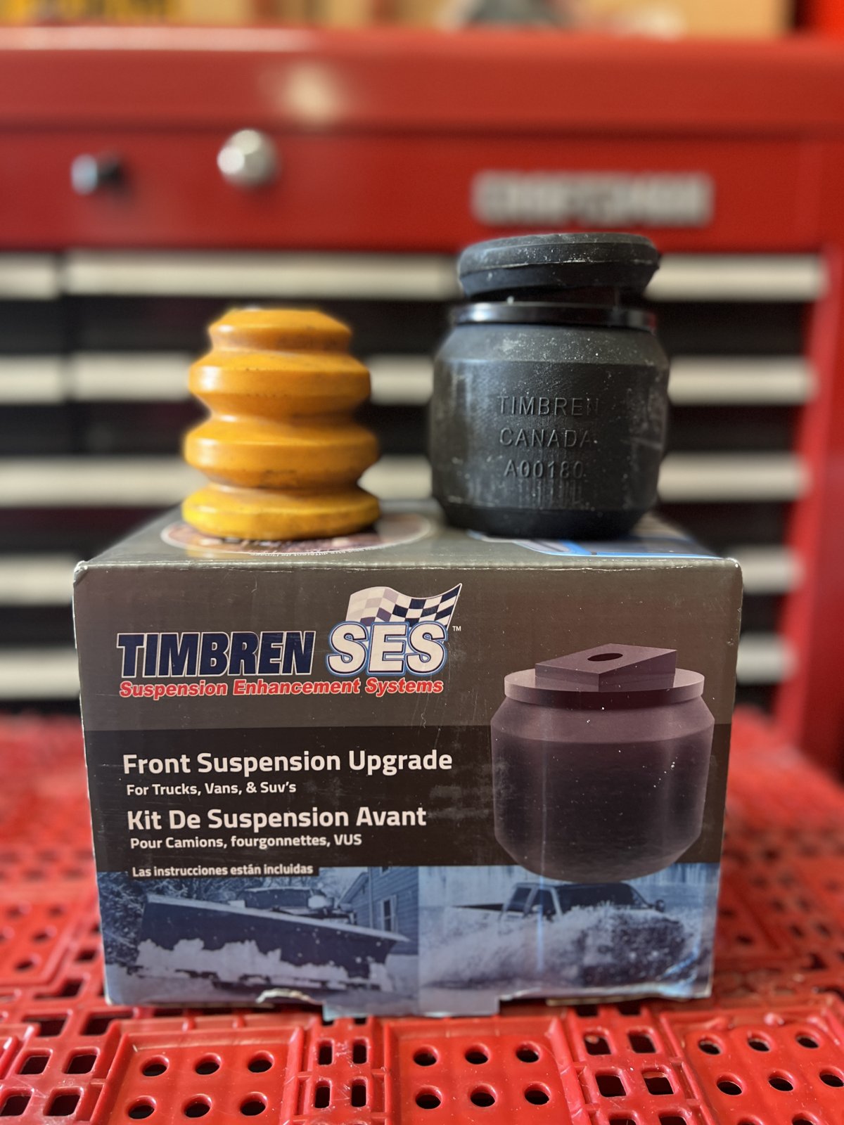

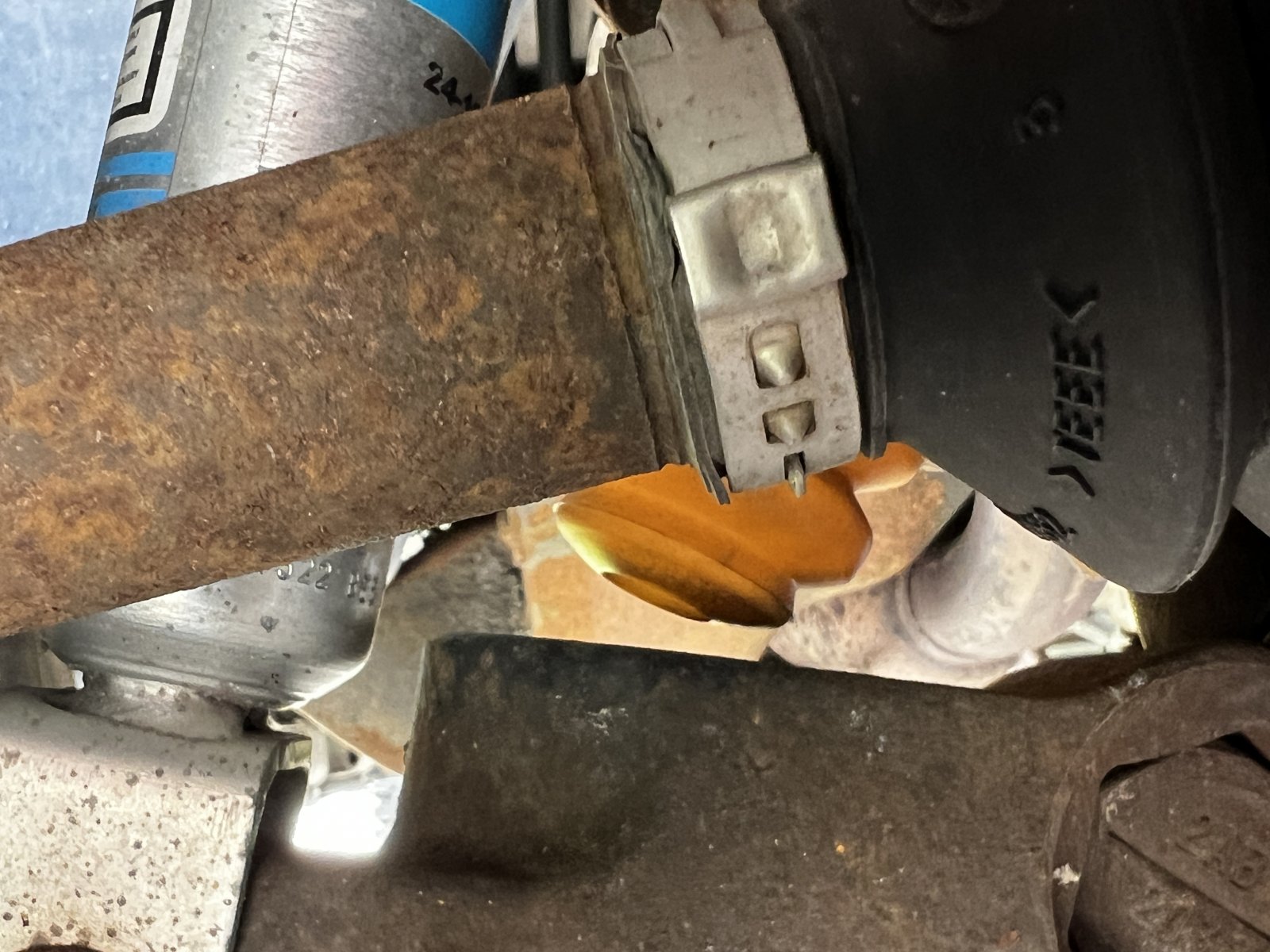

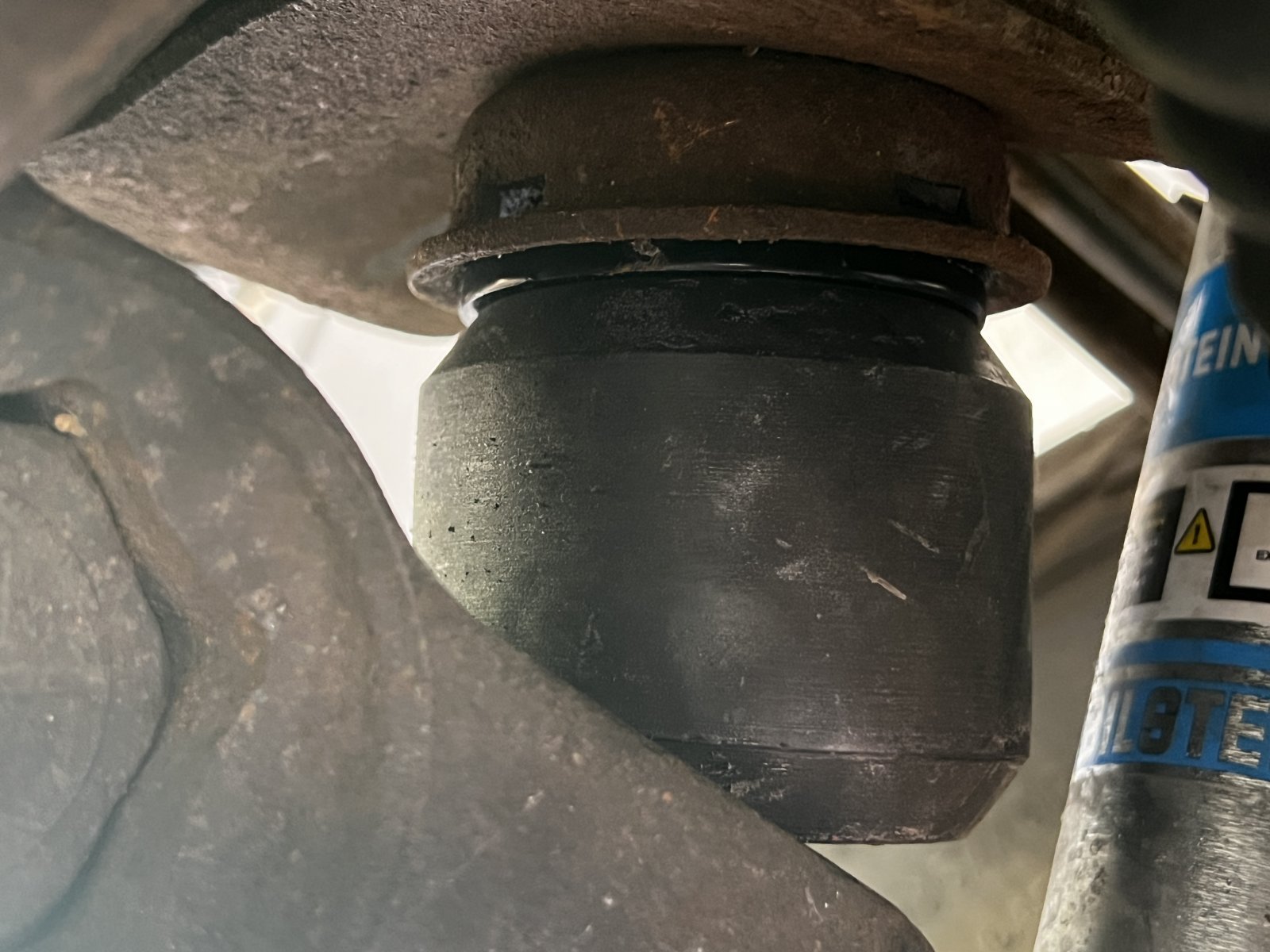

wondering if it would lower it enough to rest on the jounce.
Photo shows a shock extension. Along with the referenced 2” lift kit, you may not get the suspension to rest on the jounce.
When I leveled the front of my 2003 Z71 (stock key adjustment only / no shock extension) I used larger jounces from Timbren. They are pricey, but worked for me.
Stock height jounce:
Timbren SES jounce:
Side by side comparison:
The Timbren product has very little give under compression.

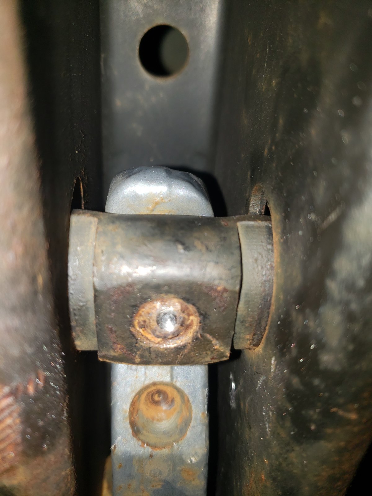

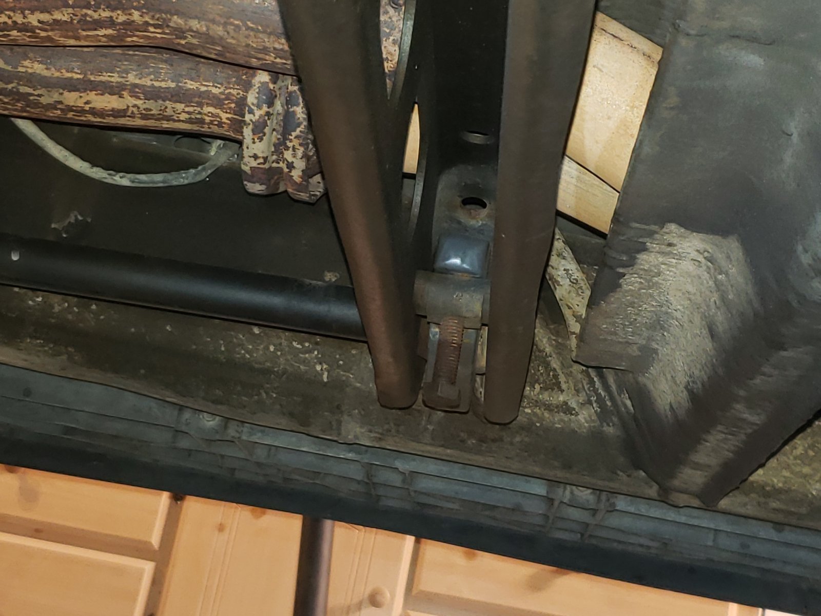

its broken off, and barely sticking out the other end. i loosened the other one all the way so both of them are as low as they can go. that thing is thick! looks about perfect, but i read someone else has a gap just like it and it rides fine, but they swapped out for bilstein shocks. maybe its been my shocks this whole time?
If you want just the bolt, you might try FB Marketplace/Craigslist for a truck getting parted out. Or a junkyard. These are not parts that typically go quickly. You can also look at those trucks to see how stock might should look, to better understand what you have. Finally, if the bolts are the same on both sides, pull the good bolt and take it to the parts store to get two new ones. Even if the bolts are $5 each (which they should NOT be), $10 going into your suspension is nothing. Also, see if you can determine the maker of your lift kit. Contact them and get information from them.

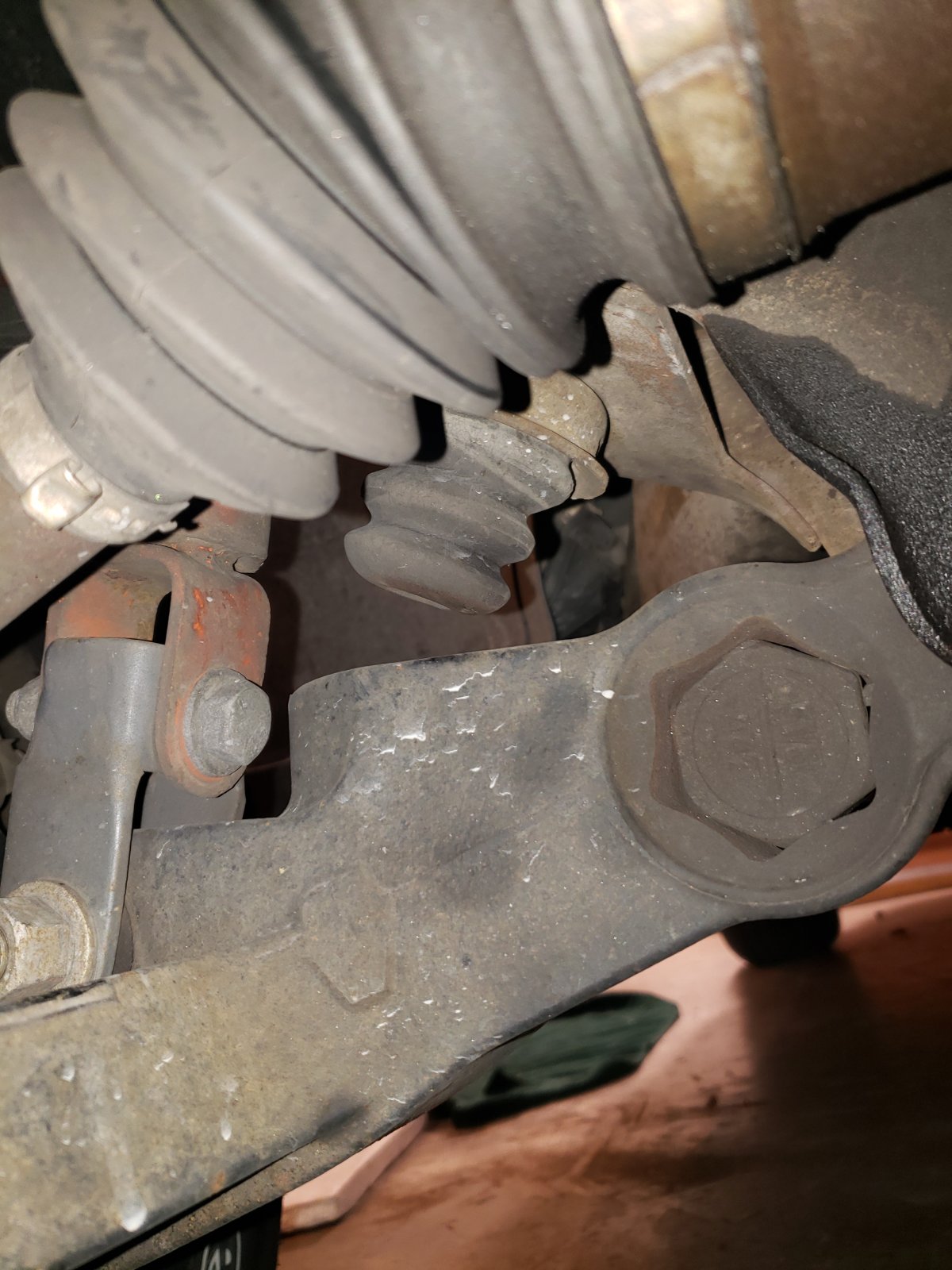

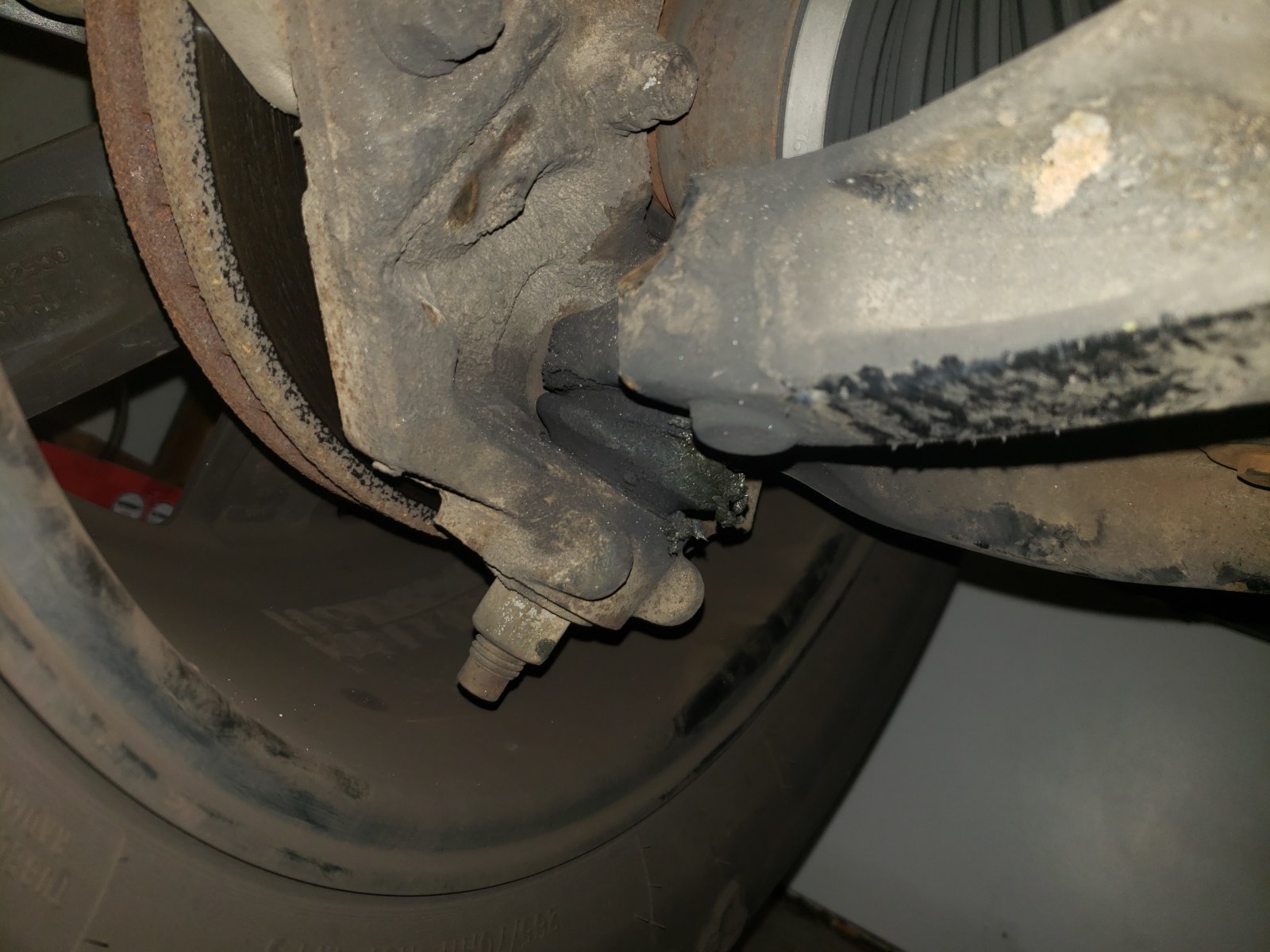

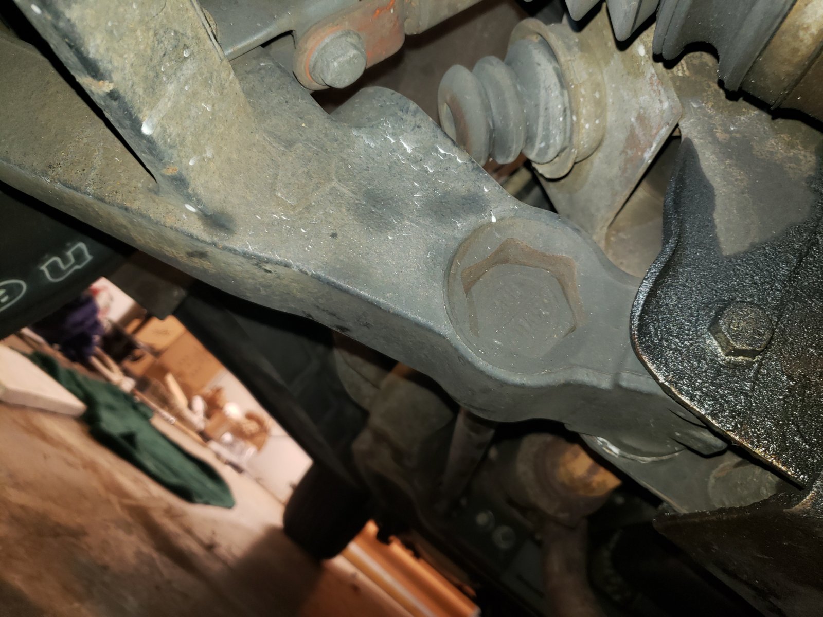

Do you have a link to your build? and those hellwigs are pricey lol. i noticed one of these are loose, i believe its the front suspension stabilizer shaft link. its the thing going straight up and down. and then i have a pic of this rubber thing on the lower control arm its smushed but im having trouble finding it. also, what do you think about hp tuner?
The "link" is one of the sway bar end links. The "smushed" thing is the boot of the lower ball joint.
