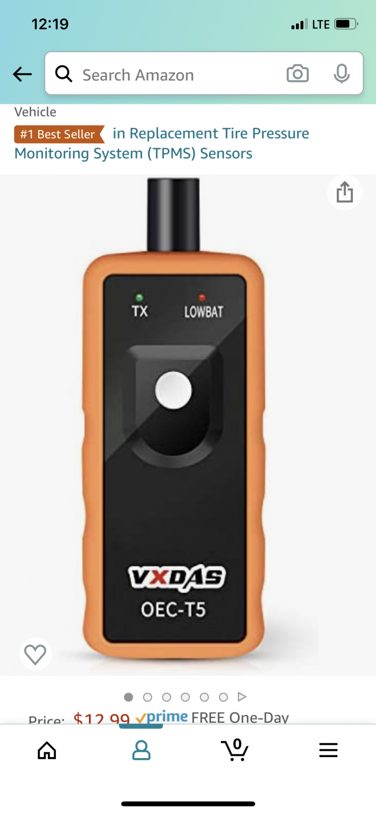

I bought new sensors on Amazon, 4 for $40 (mine are aftermarket "Roadfar', but you can find AC Delco on Amazon as well). I also purchased a VXDAS Auto Tire Pressure Monitor for $10 which allows you to reset the sensors. I had Walmart install them for $20. My sensors were preprogrammed for my vehicle, but Walmart would have been able to program them. I think the AC Delco sensors are around $17 each. Might be worth a try as opposed to the dealer. Mine are working great.

Hello! I bought the $11 Red tool in Amazon also. It did not work. Is there a difference between a 'reset' tool vs a 'relearn' tool? I need it to swap between winter and summer wheels, etc.

Does it look like this? Color shouldn’t Mater

OK, I'll order another
I have one of those same tools and at first I couldn’t get it to work. Make sure the battery in it is new and touch it to the valve stem or at least put it within a fraction of an inch of it.

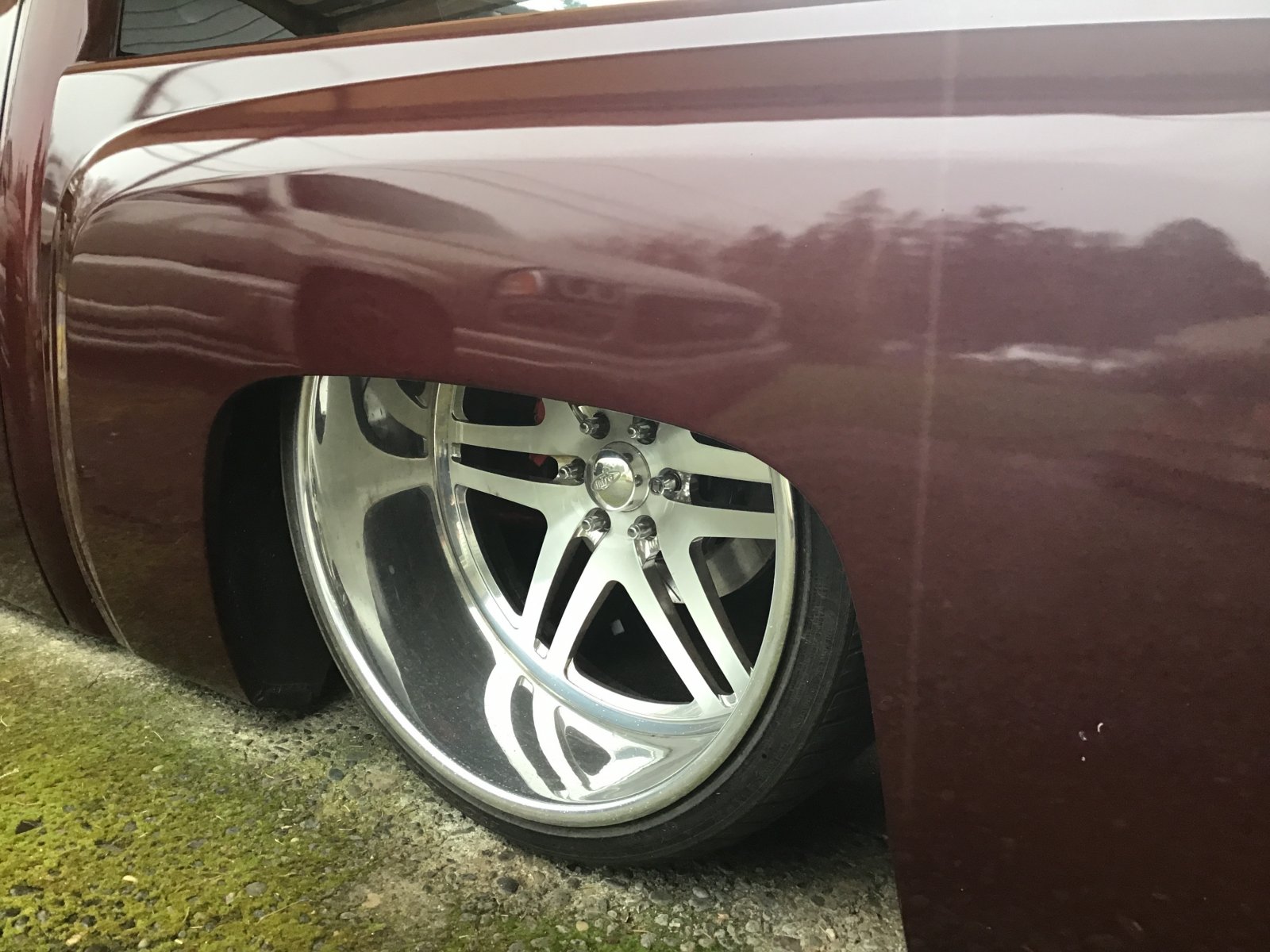

They have their place. I appreciate having them on my Silverado for sure. Damn billets have a reputation for getting corrosion around the bead and with these stretched tires it’s hard to see if they lost air. It’s saved my ass a few times. But I’m kinda glad they’re not on my 02.
