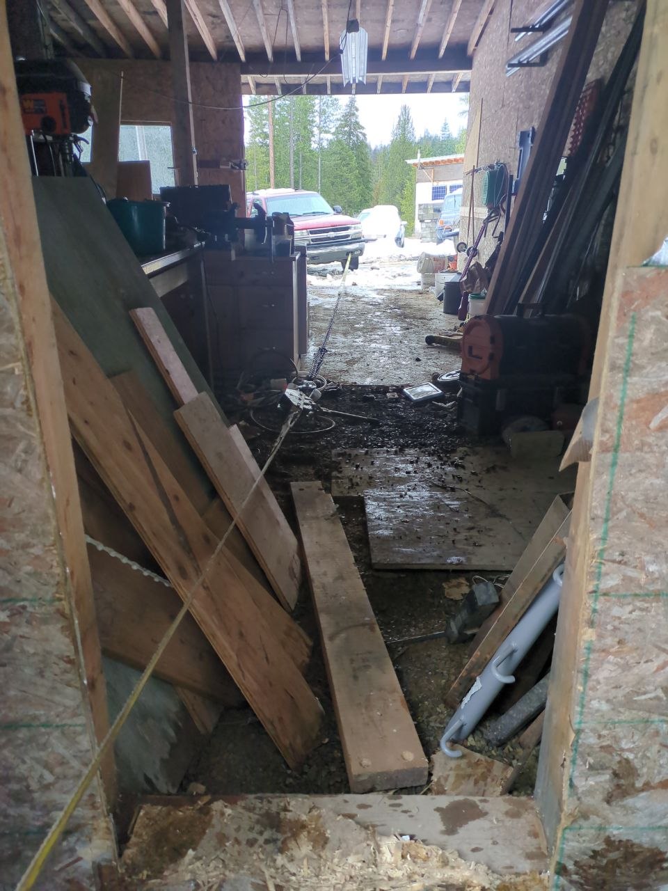

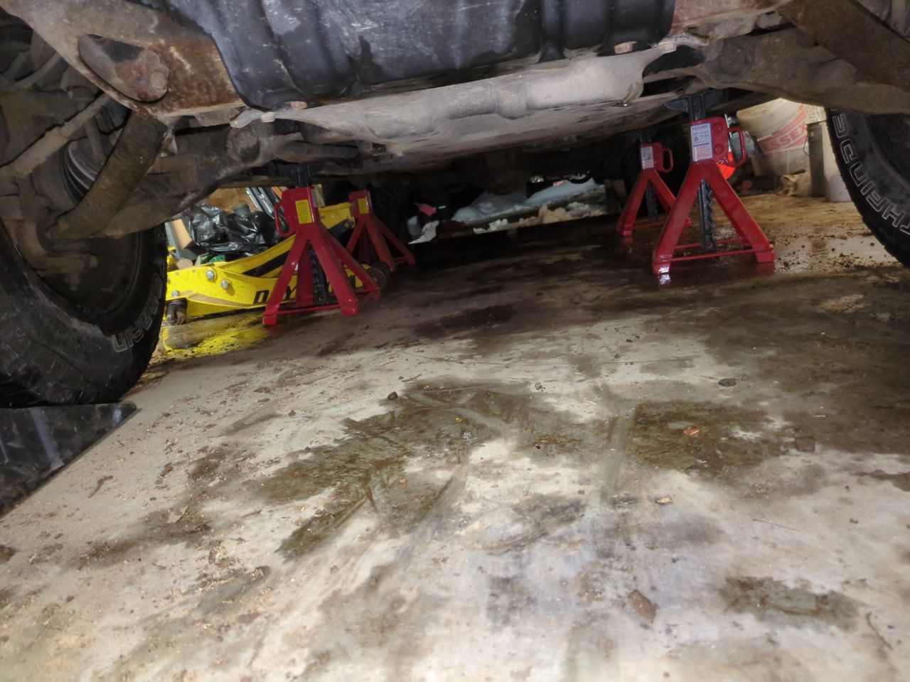

Here's a few photos I took yesterday.
Had to pull the Tahoe into the shop with a come-along.
Here it is up on jack stands. I think I need to lift it a little higher.

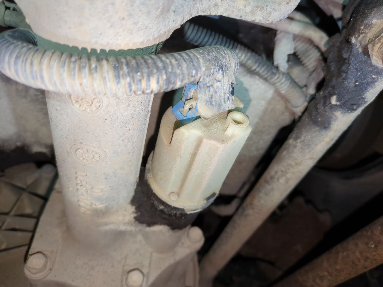

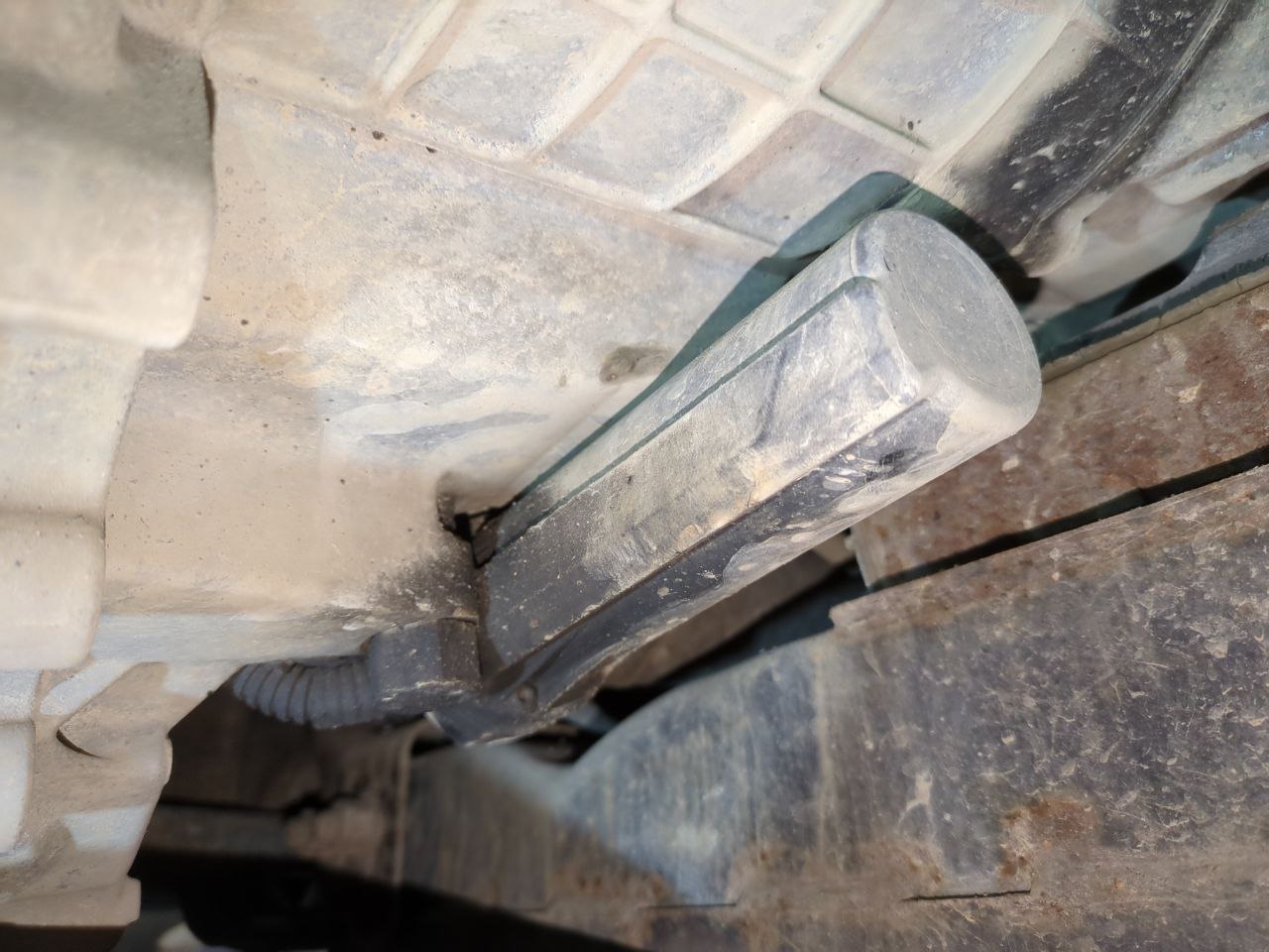

Is this the motor that controls which gear the transfer case is in?
I believe this is the motor that connects/disconnects one of the front axles. Is that correct?
Yes - it's called the transfer case encoder motor assembly. Inside of the motor there is a sensor, which often goes bad. The T-case motor's job is to shift the T-case in and out of gear (2H, 4H, 4L). If it goes bad a chassis DTC will set / store and you will lose transfer case functionality (you've already seen the 'Service 4WD' message in the DIC).
You will need a scan tool that's capable of reading and clearing chassis codes - plug the scan tool in and read the code. Then post it here. There's only a few different codes that will set for the 4WD system and most will cover the motor and/or its sensor or the switch in the dash. Once you replace the sensor (or entire assembly), you will need to clear the code prior to attempting to use the 4WD system again.
You may also want to drain the transfer case fluid to see if there's any metal pouring out w/the fluid - if so, the Tcase itself will need overhaul.
