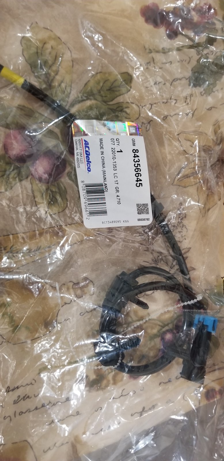

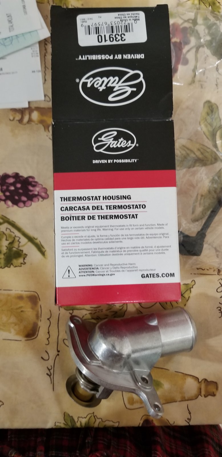

Got my thermostat and another abs sensor in.

I'm glad you did. I wanted to pay my son to do it--he said he didn't want to spend all day doing it. Rusted brake lines would def take some time.
