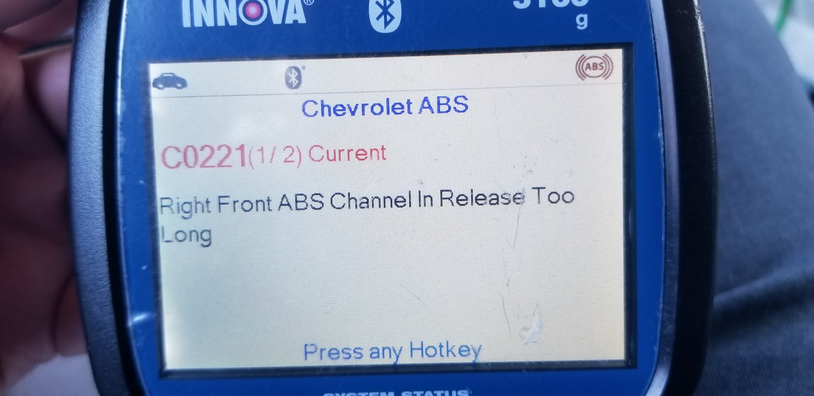

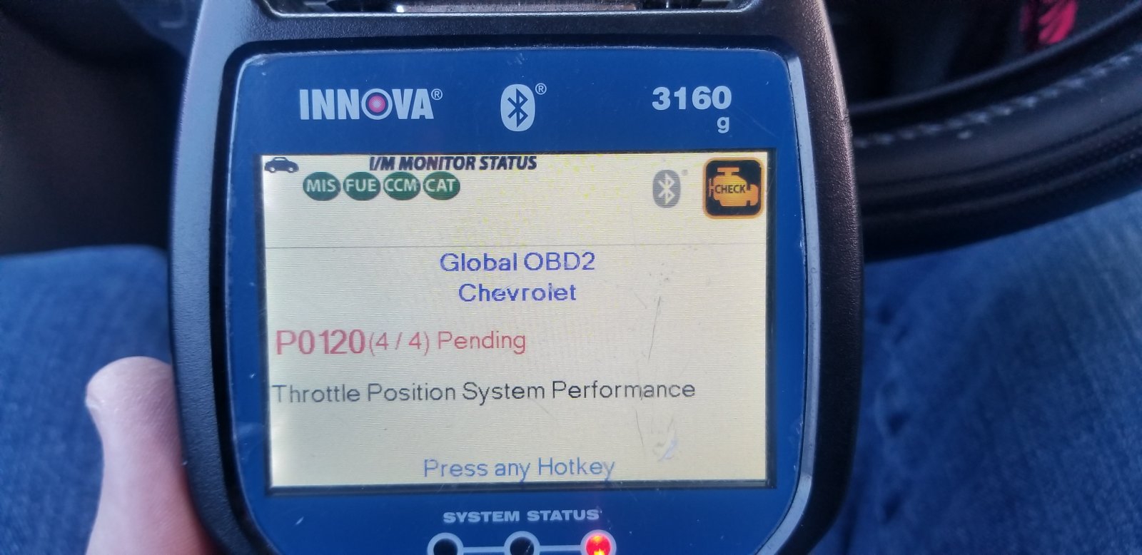

Got this code yesterday. Cleared it and it hasn't come back yet. Now I wonder if it is the battery slowly giving up the ghost. 20220315_131139.jpg

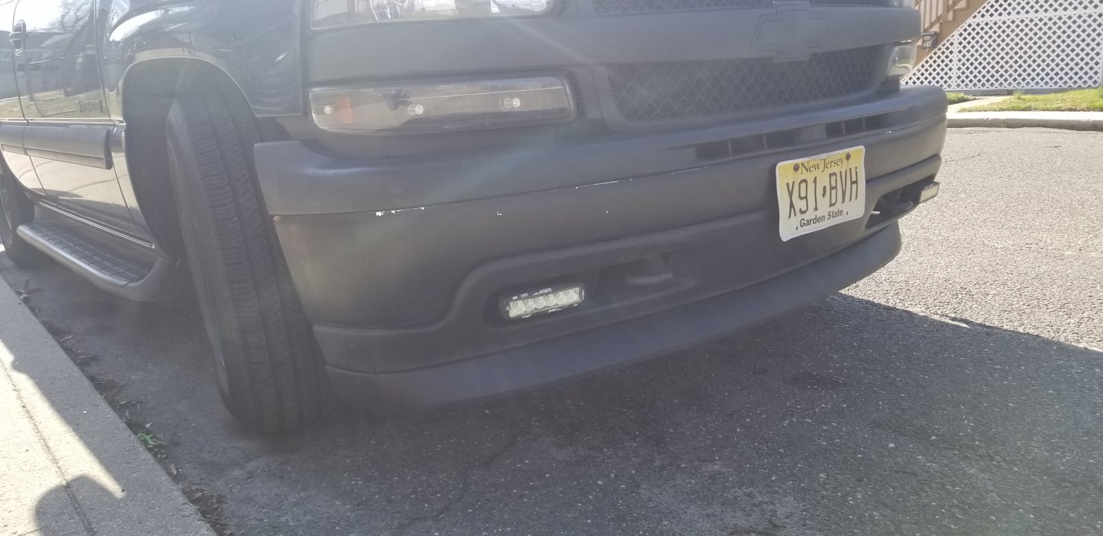

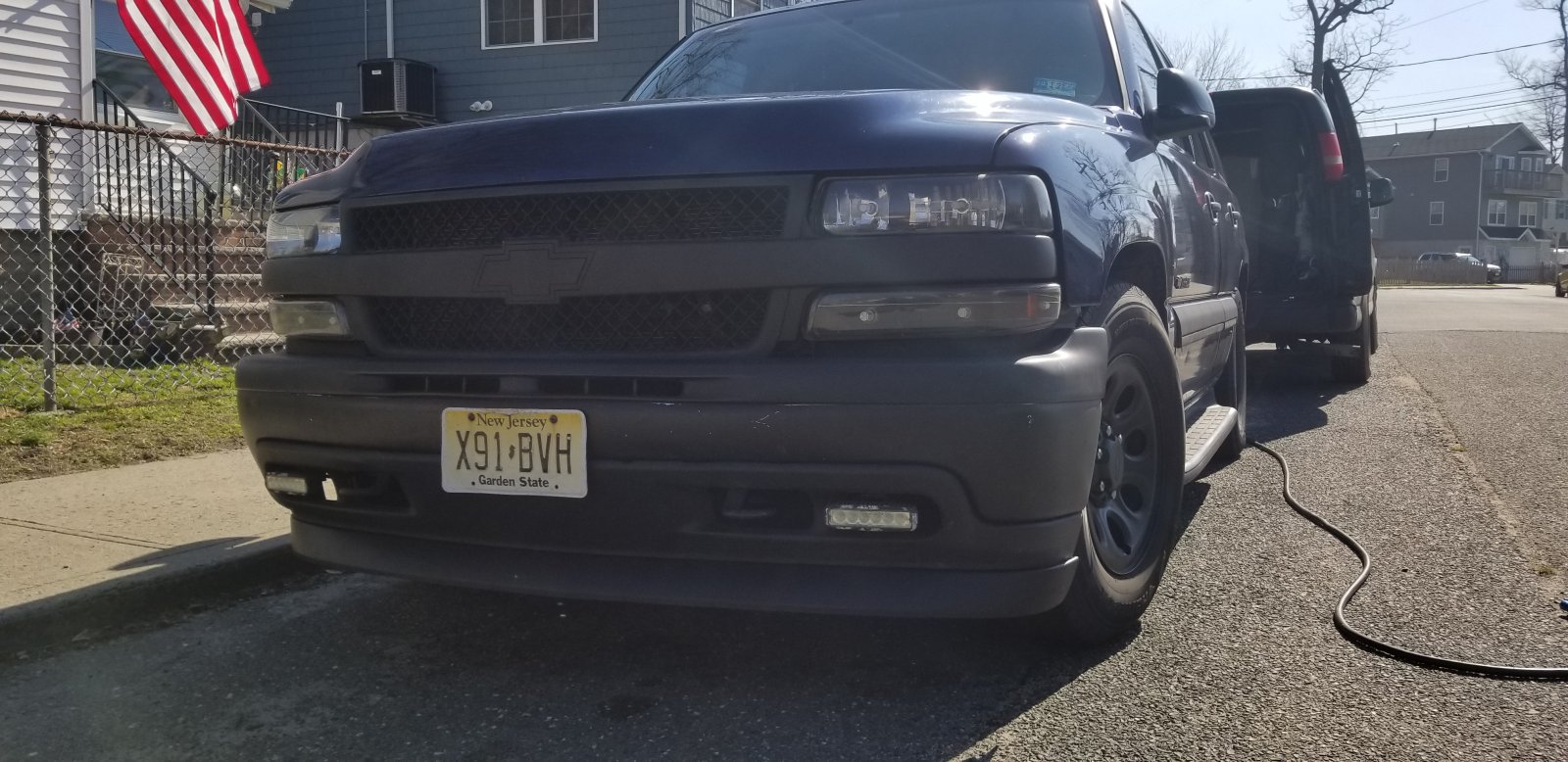

1 step forward. I finally installed the lower air dam.20220318_152622.jpg20220318_152700.jpg

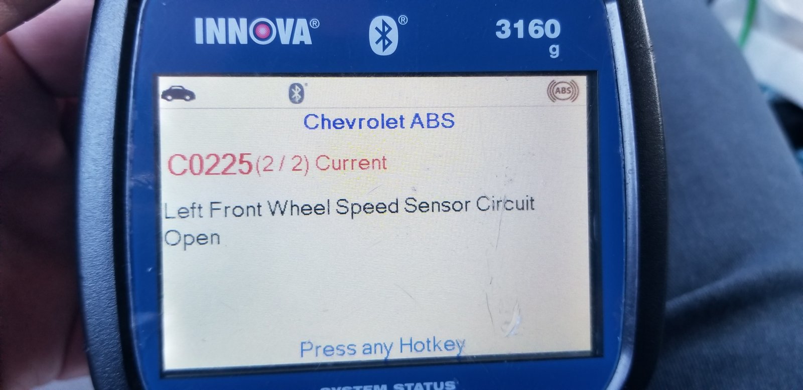

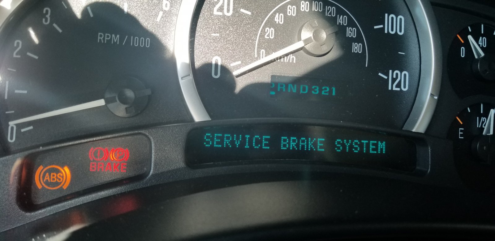

At 1st just the abs light was on. It was the ds front sensor. Changed it out with a different sensor and now both lights are on. I tried clearing it with a regular scanner and it comes immediately back. I blew out a bunch of grease in the ds hub before putting the different abs sensor in. Everything appears plugged in correctly, and brake fluid level is fine.20220318_154552.jpg

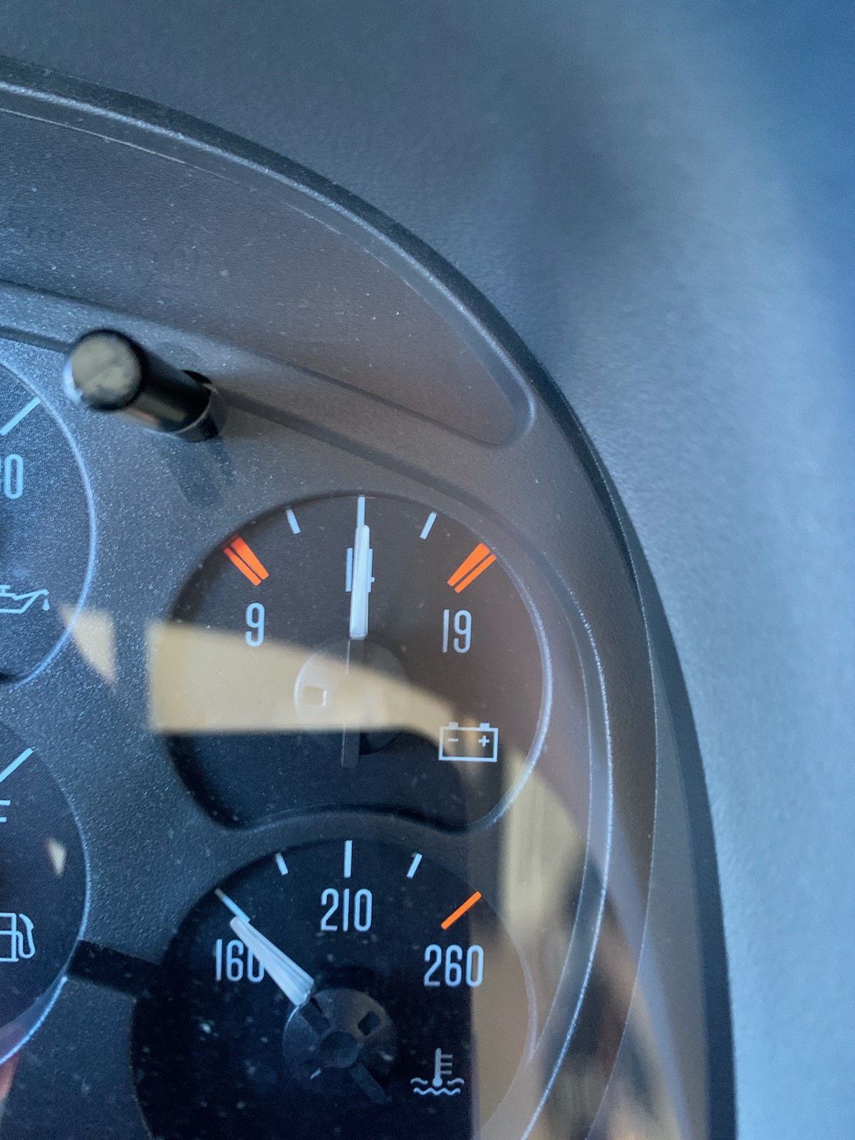

I think I might've figured out why it's running like crap once it's "warmed up". It's been going on for a few months now. When it's cold it runs fine, and once driving it's running really rough. You can even hear it in the exhaust. I noticed the temp gauge doesn't go past 160, even if it's been driven for awhile. I'm thinking the thermostat is staying open, not allowing it to go into closed loop--just a theory. I haven't been able to confirm the temp with the tech 2, but I'm pretty sure that's what's going on.
Opinions?

So now the temp gauge appears to be working all of the sudden, not sure if it's fully working tho, but still running like garbage. Almost sounds like a miss.
Gf said it was throwing off alot of heat too, just radiating heat. Felt like the heat was on, but it wasn't. Gauge shot to 210, then went back to what the pic is showing, and stayed there. Opinions--temp sensor? Thermostat? I haven't been able to put a scanner on it yet.
