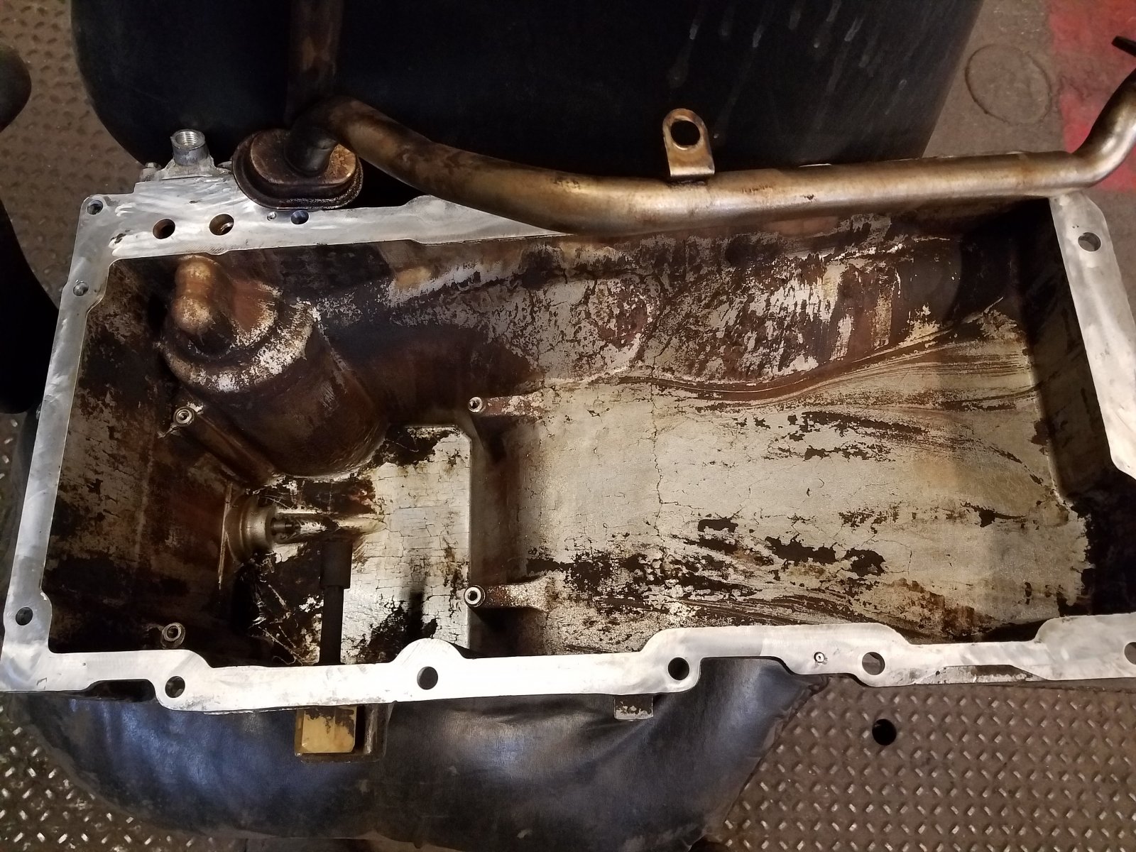

I would do the oring for sure. I did the Silverado on ramps, in winter in a non insulated garage and took 2 days. But it was 20F and part of one day was washing the pan out at work( bonus of having a high pressure wash cabinet at your job).
I wish I would have been able to get the pump relief spring shimmed. But that requires pulling the front cover.
Oh, if you do pull the pan, take pictures! Always fun to look at those!
Before washing. Not bad for 395k miles and never being opened.
