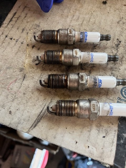

OH...and here's what the 4 that finally came out look like...not bad, eh?

11 - 15 ft/lbs. wouldn’t go too much tighter than that.
If they have never been changed in 180K then, yeah they’re going to probably feel like they’re welded in place.
Hopefully you did the passenger side first. lol.

Yeah, they look pretty normal to me.
I've never torqued spark plugs, don't even know if there's a spec (there probably is?)
I just snug them up. I use a 12"-ish long ratchet. I do always apply a bit of anti-seize on the threads. They do seize in there after thousands of miles and heat cycles. And a dab of dielectric grease on where to wire goes.
