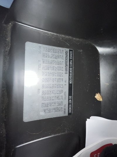

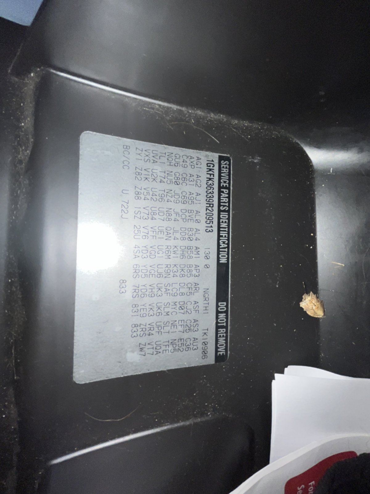

There’s the rpo sticker in the glove box. It has gu6 and g80 but I do not see the k codes

According to the bottom of that manual you sent it says all 4wd Yukon xls came with 3.42 gears and have a towing capacity of 7900lbs am I missing something? Cause that tells me it’s 7900 not 5400? This is too complicated lol

Welp I did some more digging and I’m not confused anymore lol I see how it’s only 5400lbs which is kind of a bummer but oh well thanks for all the help man!
