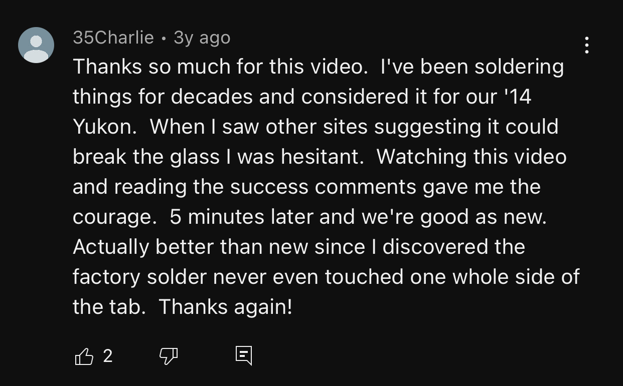

I also went to open the rear glass and one of the defrost contacts came off the defrost grid so if anyone has any solution for that that would be great lol
As for the headlights, those things are nice but a bit pricey. I had a set of LED headlight bulbs in my Tahoe that made a night and day different when driving at night. I may buy another pair of those to brighten the night driving a little
Frost Fighter comes highly recommended by many members: https://frostfighter.com/

There’s the glue repair kits or simply solder them back on. I’d do solder.

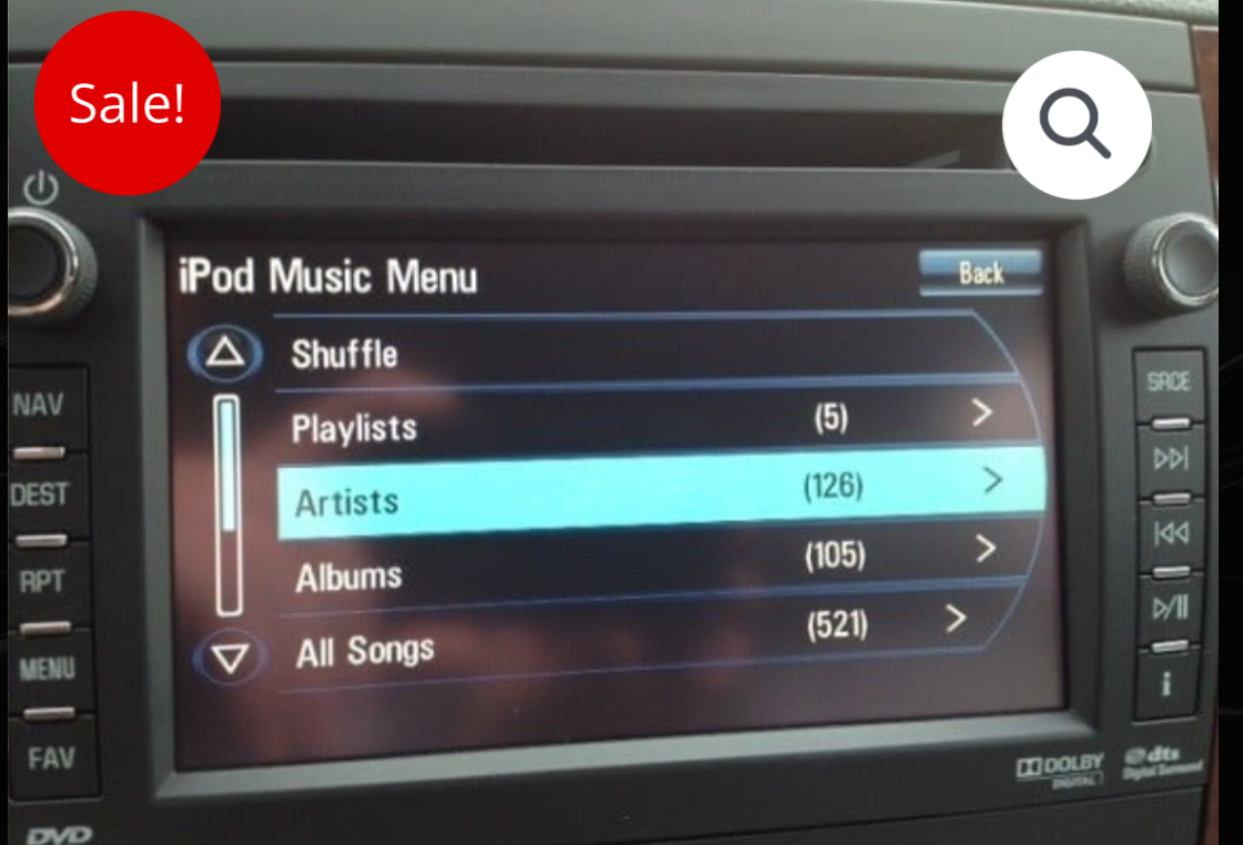

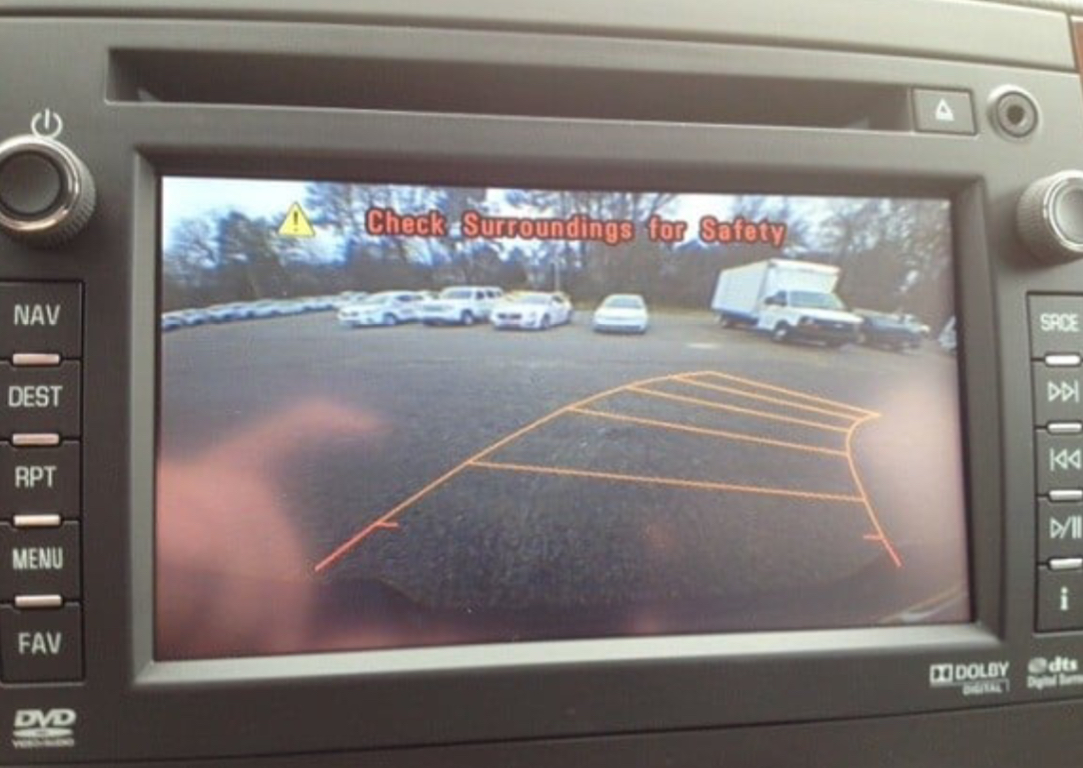

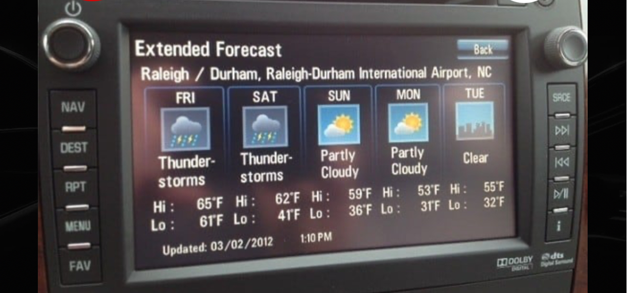

The HDD Navi w/ 30 GB hard drive for music storage pauses live radio and has its XM tuner separate and behind the glove box door. Only the HDD & Escalade Navi accept the $69 A2DP music BT module. Bummer they just raised the price to $104
Expect to pay about $150 for 3 yr weather & XM live traffic report announcements. Unlimited XM best price is $99 for 3 years (after your free trial).
Line in for iPod/ music and storage screen.
The back up grid lines on the 11/12-14 HDD Navi units.

that video was very helpful! thanks man! will definitely be doing that in the near future. as for the oil leak i found that plug i was talking about in the side of the oil pan wasnt tightened. put a 17 on it and cranked her down and no more leak. and looking at your pictures of the hdd navi unit im pretty sure that is the same unit that is in mine so will definitely be doing that interface module you were talking about. and as for the seats yes it is heated and cooled seats which is awesome!
