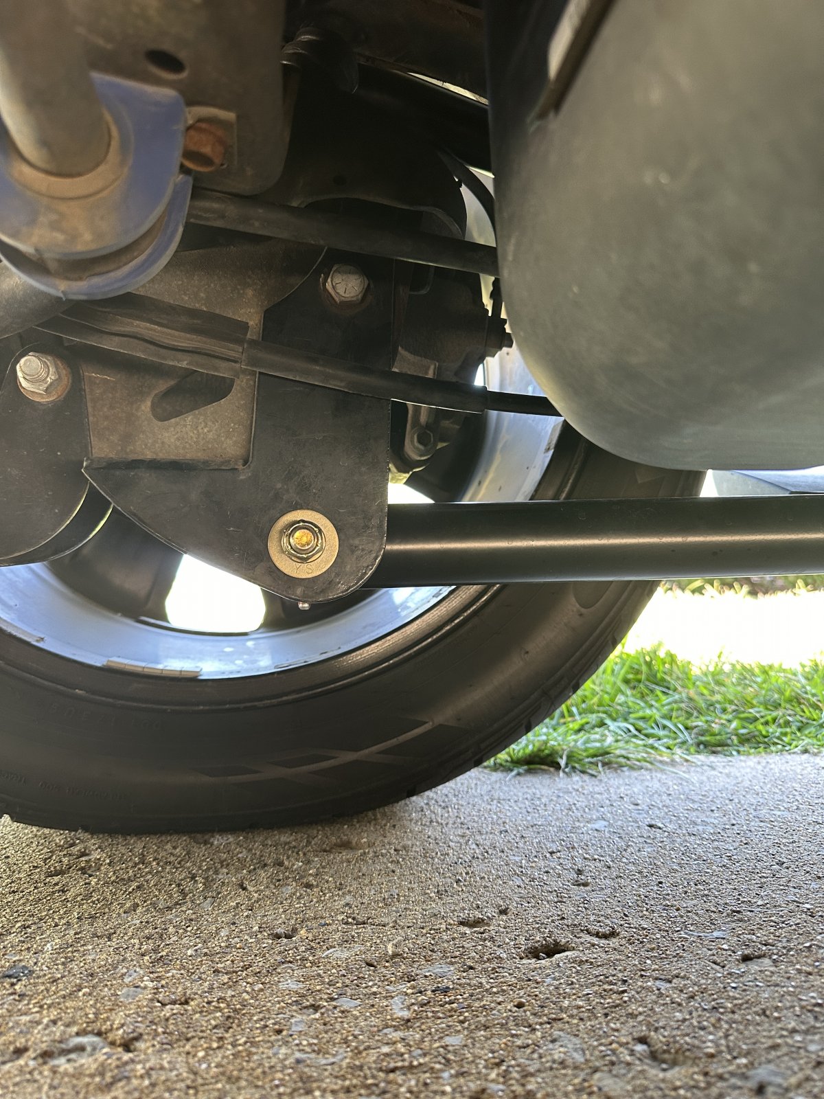

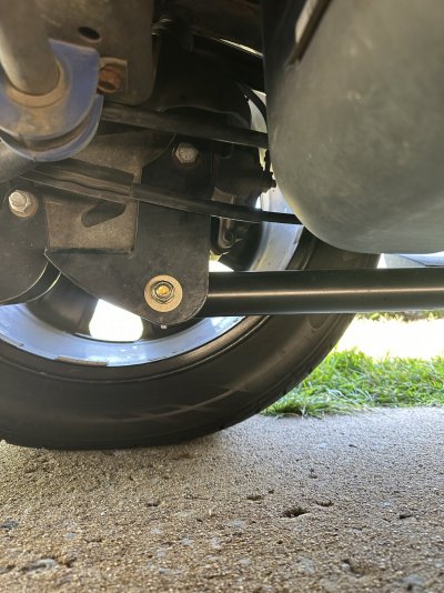

Aren't drop shackles for leaf springs?
May be the wrong terminology. It’s what I’ve always called it though; it’s used to drop the location of the shock, and another to drop the location of the lower trailing arm. Pic attached of the trailing arm shackle

I still have my sensors and whatnot. Did you keep the factory air shocks, or did you retrofit bags?
If you kept the factory air shocks, I'm assuming you're using a 4" drop shackle?
I do have the axle relocation brackets similar to the ones pictured.
I researched and found an aftermarket air shock with the same collapsed/extended length as the Belltech drop shocks and ran those.
They rode nice, my only complaint was if you get into a situation where there is a repetitive bounce, like when coming off of certain bridges, they were softer than I liked.

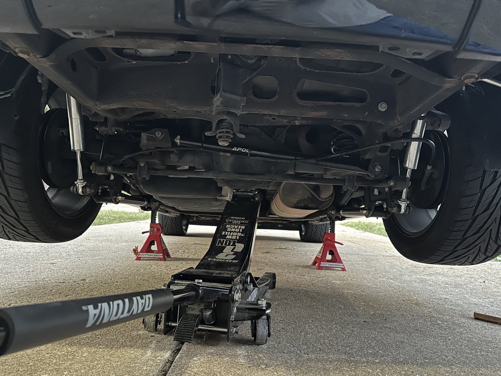

Pictures as promised. This is with the axle sitting at ride height.
Here’s the clearance on the diff cover. It’s around .200-.250
View looking up, top of picture is forward.

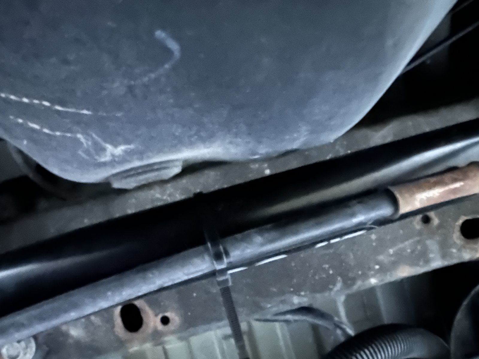

Hey remember when I said I needed to re-route the cooler lines? :banghead:
Saturday we took my step-son to the Wolf Sanctuary, about 40 miles from home. On the way back, I started seeing smoke behind me and pulled over.
Tranny line--wrapped in DEI heat sleeve--had shifted over slightly and was rubbing against the tail of the stud from manifold to crossover pipe. It rubbed JUST enough to make a pinhole and spray ATF all over the undercarriage, exhaust, and COVER the entire rear.
I spent Sunday re-running new lines. This time I went above the transfer case, then against the splash-shield, and straight up. Pics incoming...
