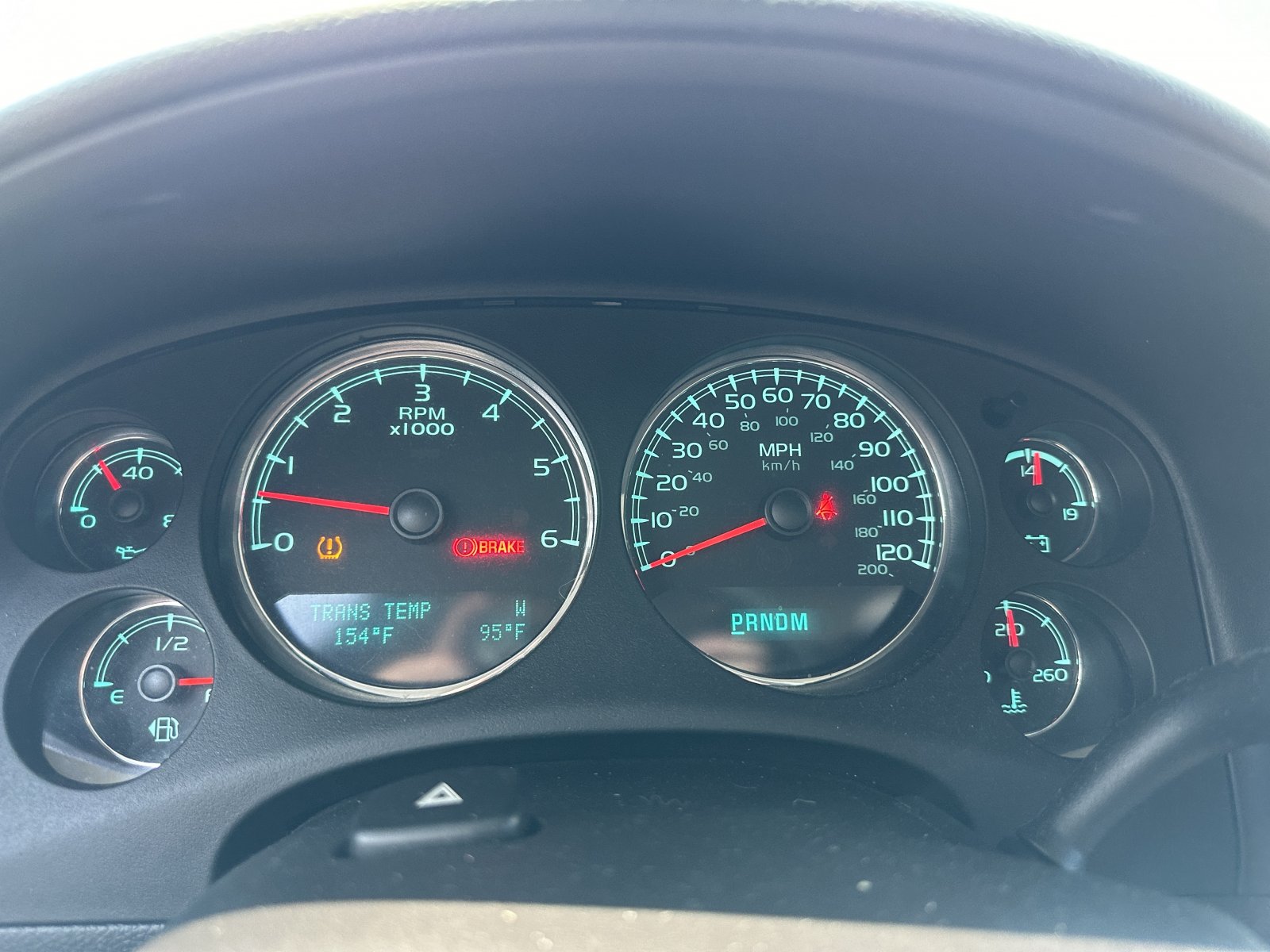

It’s been a week. I’ve yet to see 170° on the trans temp, and the ambient temps here have been mid 90’s. Photo is after my 21 mile drive to work, ROMPING on it, trying to see how hot I could get it.
I think it’s safe to say it works! It almost works too well. I think I’d have been okay with a 34k, and probably even a 24k. I went with the 40k because it uses 3/8 inverted flare fittings instead of a brazed-on 3/8 hose barb, meaning I can convert to AN fittings later.
To whomever it was that said that a 3200 stall would produce more heat than "even a 40k" could relieve...:fca5278e:

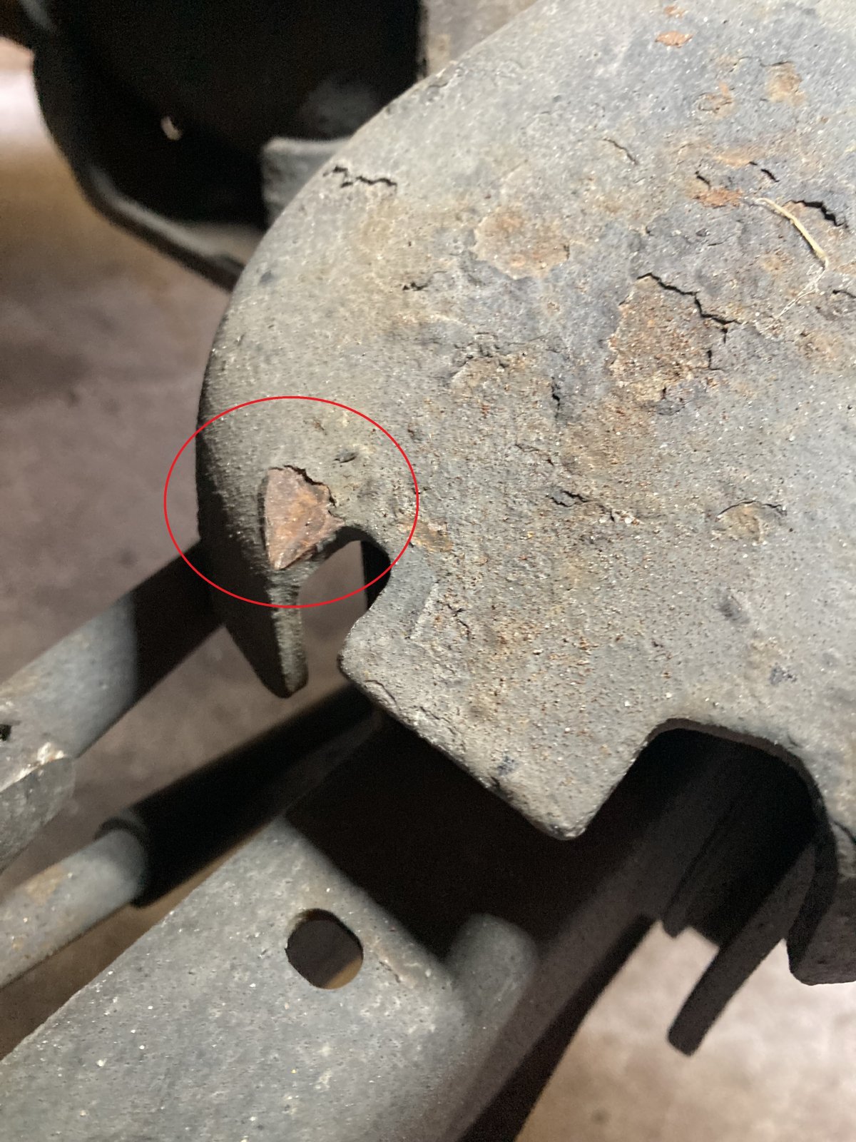

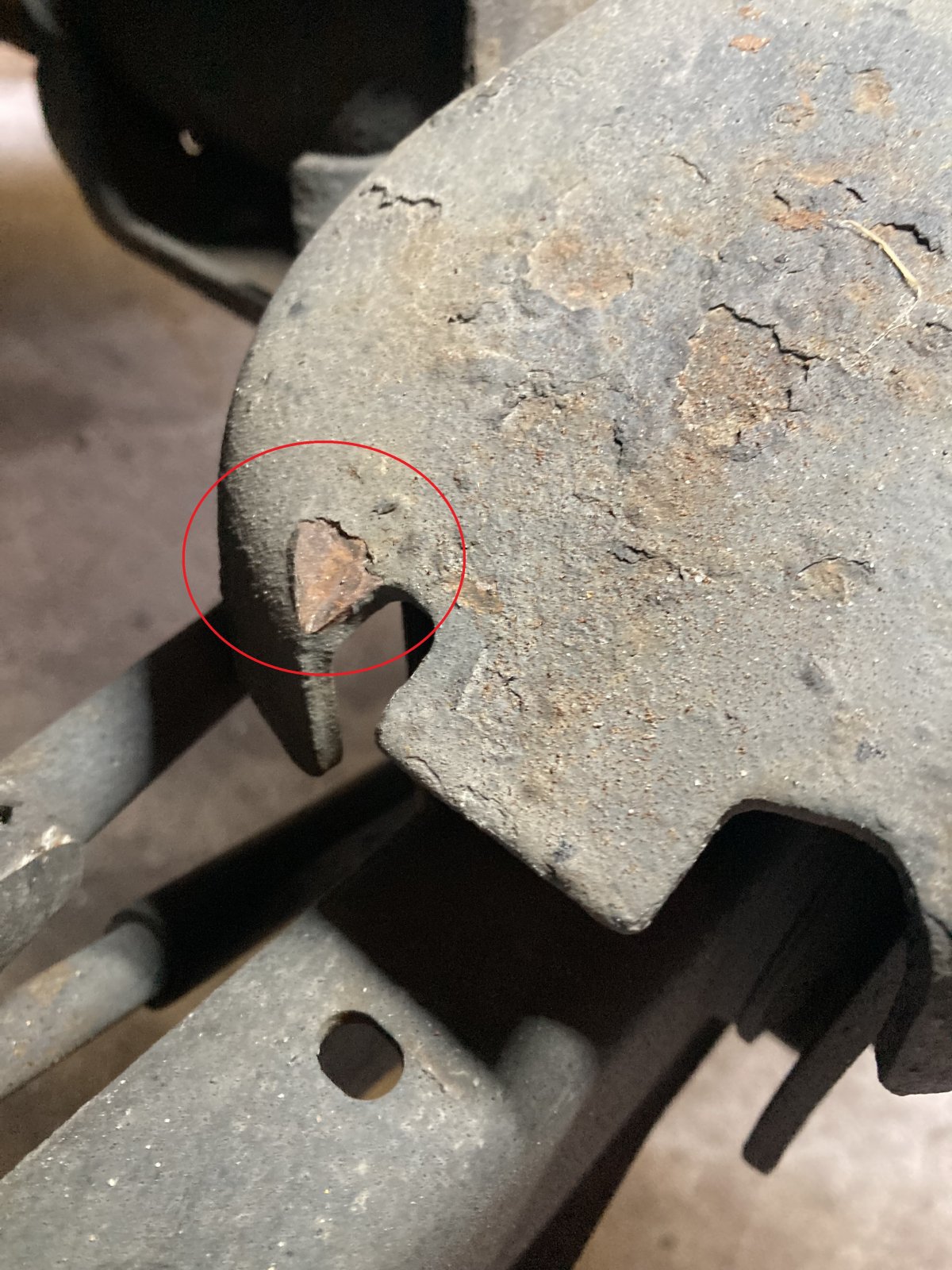

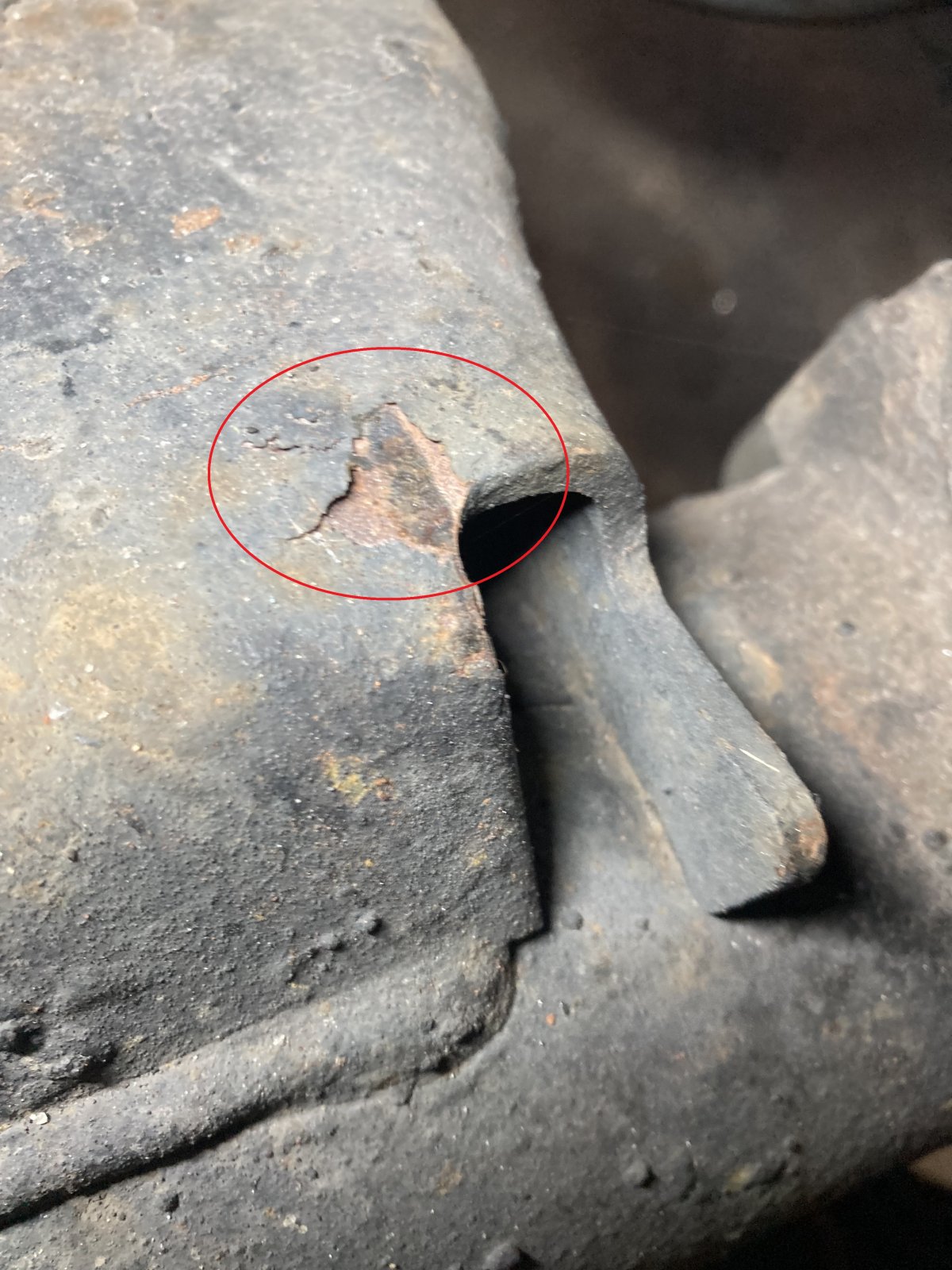

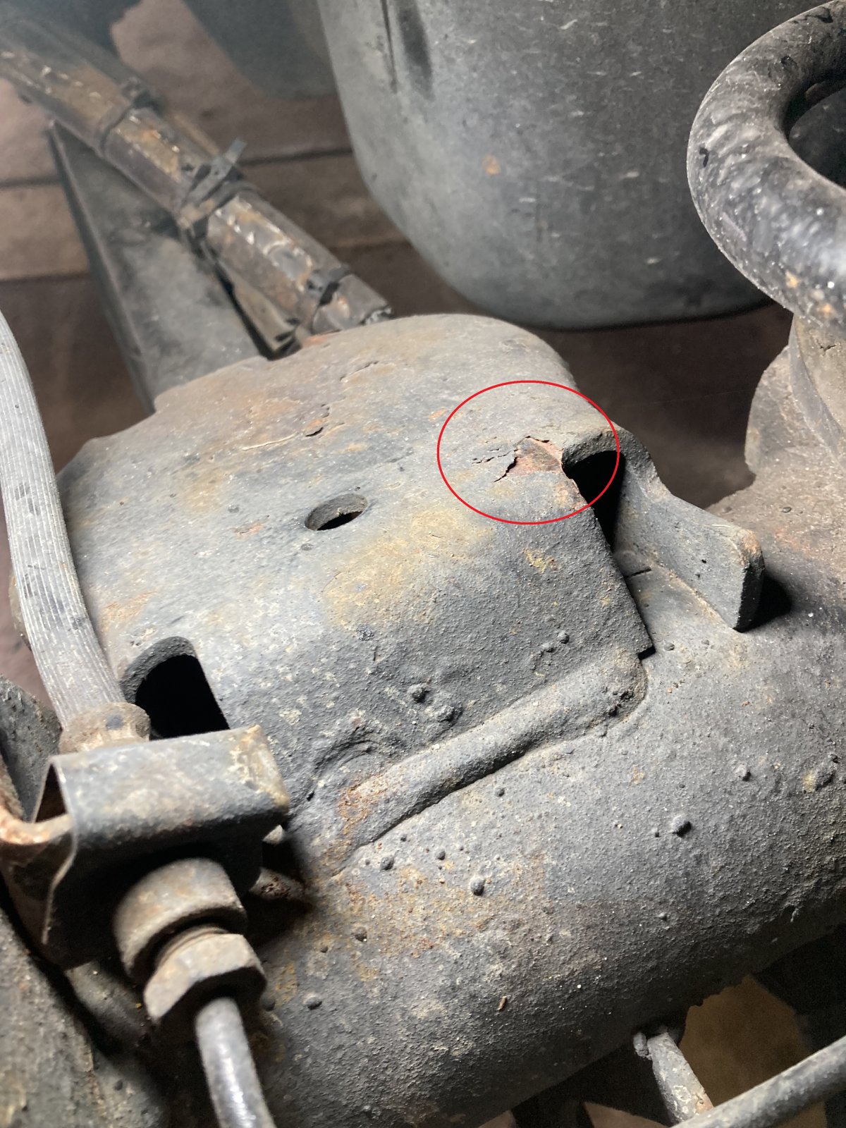

Well you certainly called that one. I didn't get the fender measurement yet I keep forgetting. Both axle pads are hitting the frame for sure. This is the driver's side. When I did the free travel mod I left about a 1/4" to 1/2" of flange hanging and that's what it is hitting.
I cut the rest off yesterday and see how it does this week. I already hit the one bump I know always bottoms out on the way to work this morning and it didn't do it so I am hoping I got this under control now. If it still does it I may notch those pads. I don't want to remove them because it looks like its part of the structural bracket for the lower control arm mount.
View attachment 434494View attachment 434495View attachment 434496
