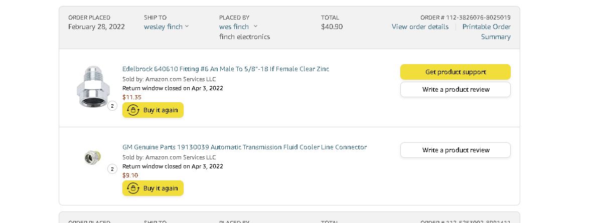

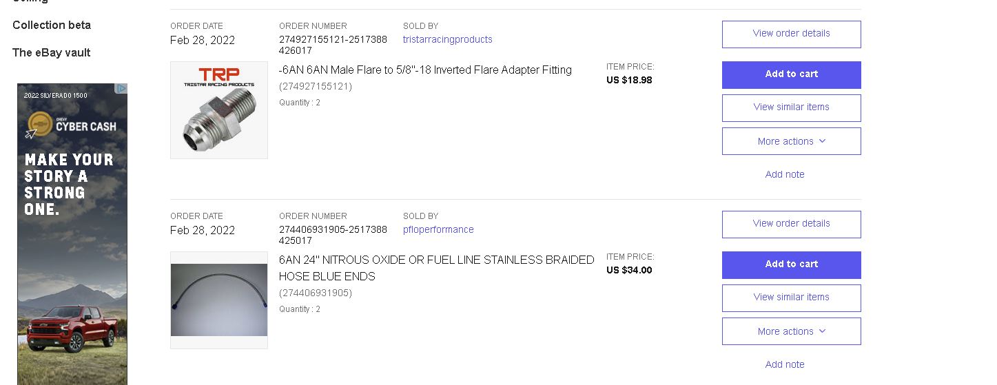

top one is parts off of amazon, bottom one is parts off of ebay
you need 2 of each, these will let you bolt the trucool right up in-line with the existing radiator cooler & lines

30,746
48,428
Not terribly concerned with reusing the factory lines since I’ll be switching to 6an lines toward the end of the year
the factory lines do not connect to a tru cool, you have to use adapters or the rubber hose and screw clamps that come with the tru cool which in my case decided to work there way loose and start leaking. the tru cool fittings are 5/8-18 and the factory lines are a flared pipe.
so the adpaters I noted above convert the flared pipe to 6an and then from 6an back to 5/8-18
you can just use what comes in the tru cool kit, but you might not want too.
it's just a option for a more secure fitment.
