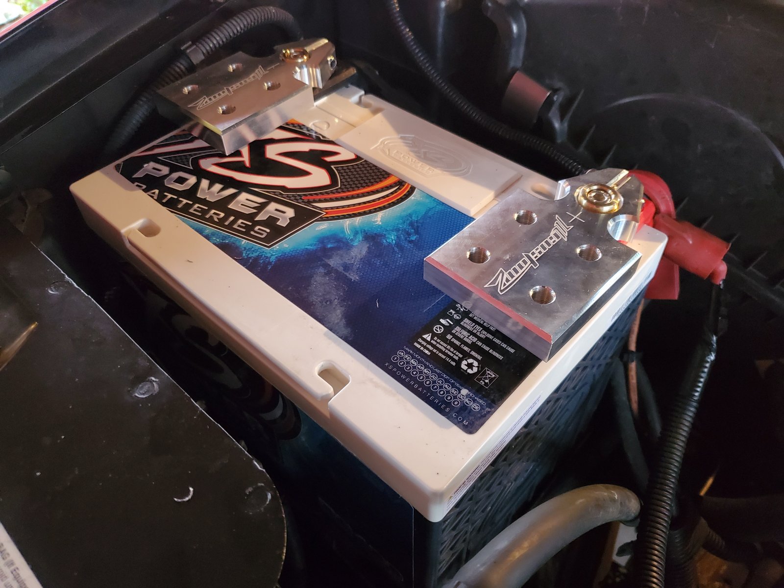

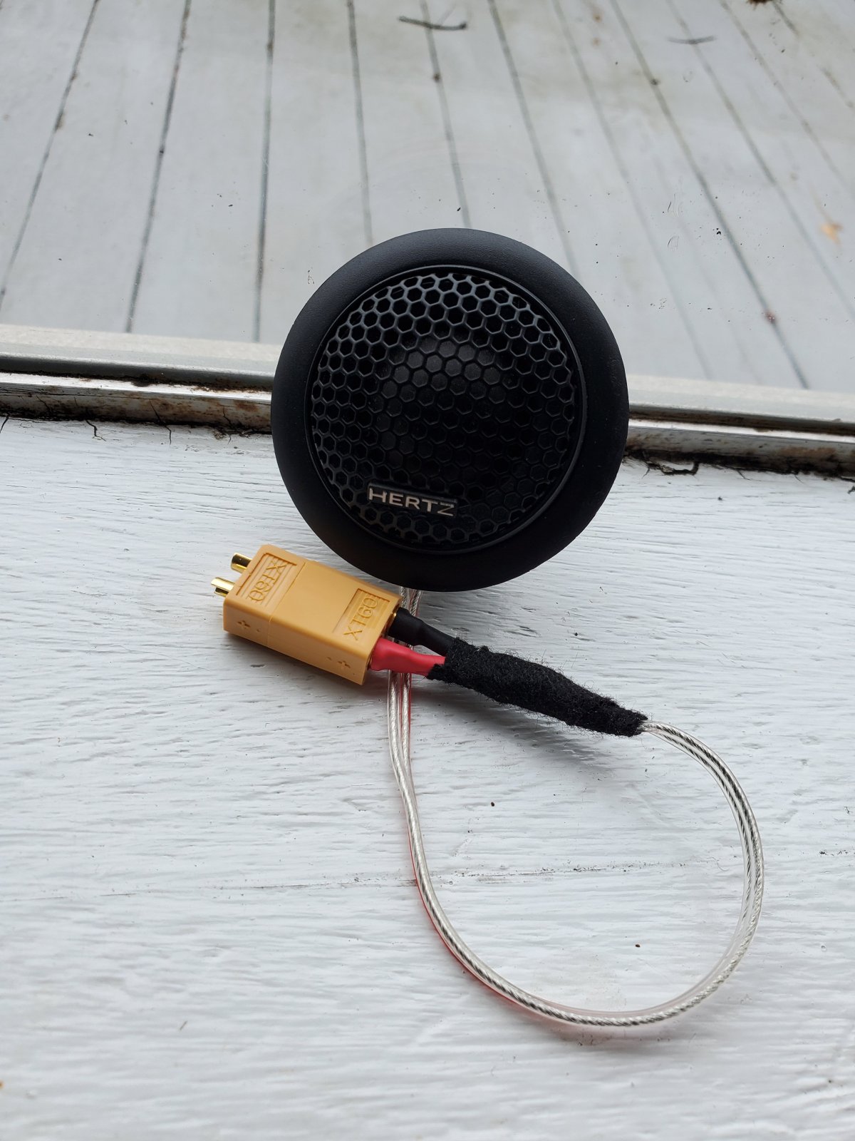

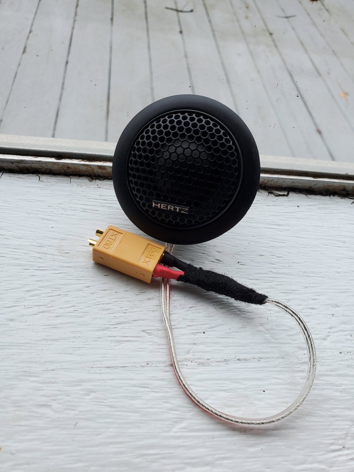

Got my terminals. All the stock off the rear and stereo plus big 3 off the top. Got some quick release plugs on my tweeters too

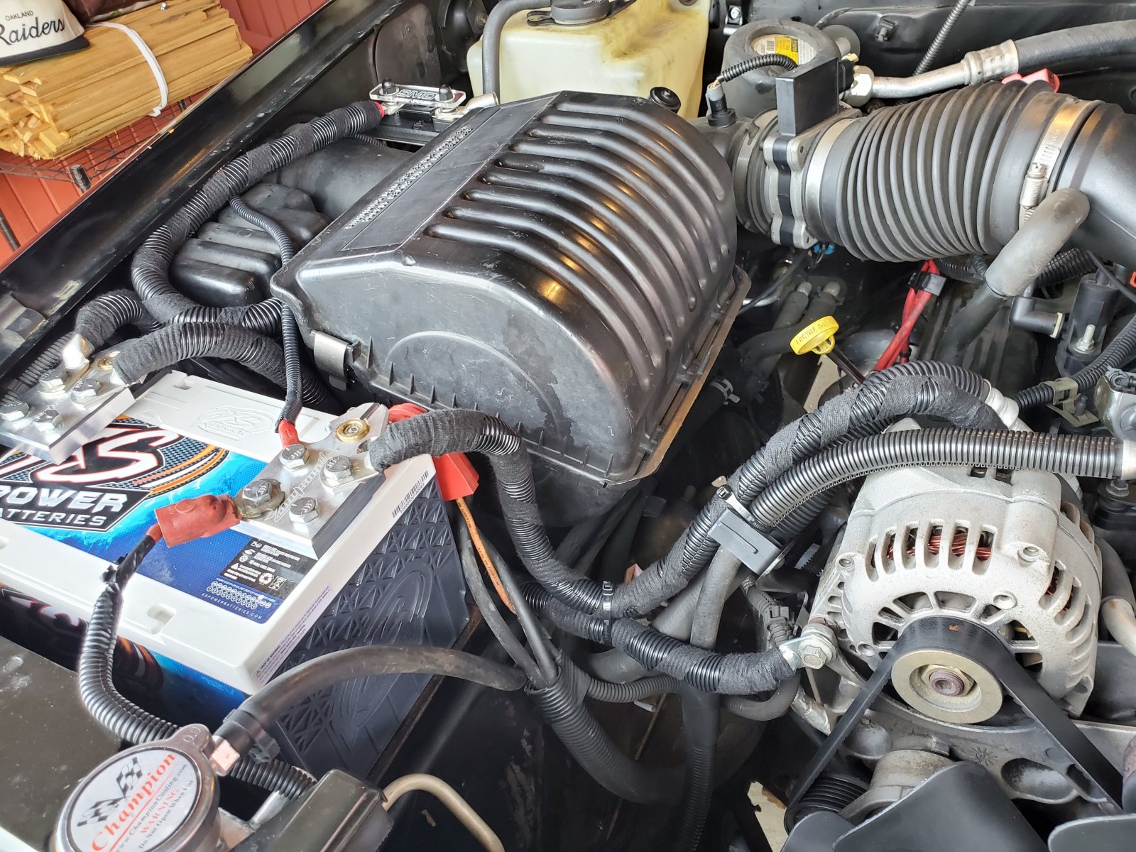

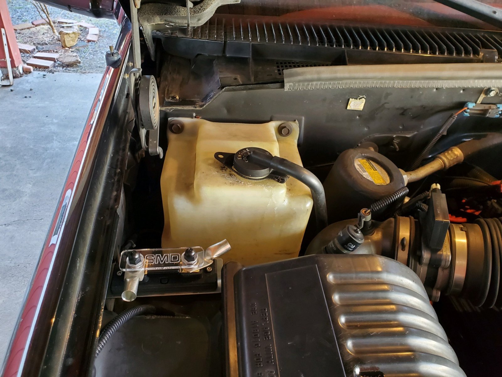

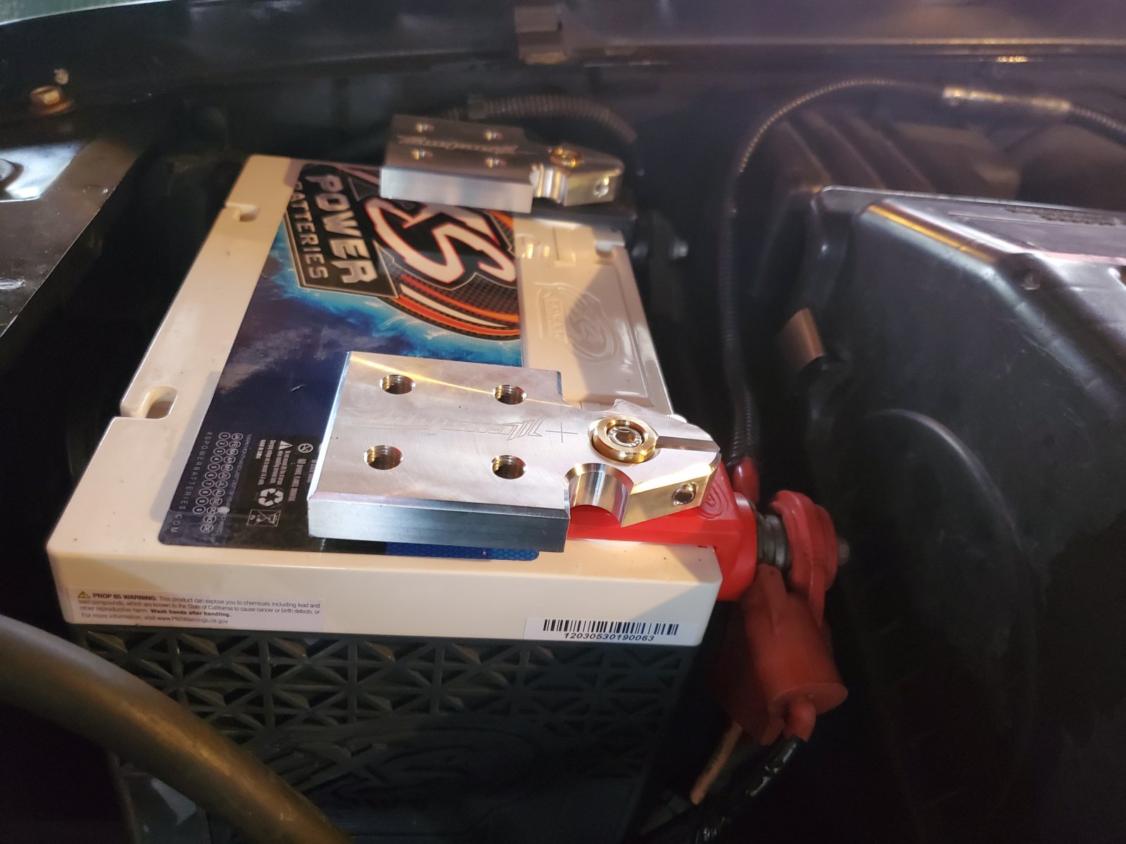

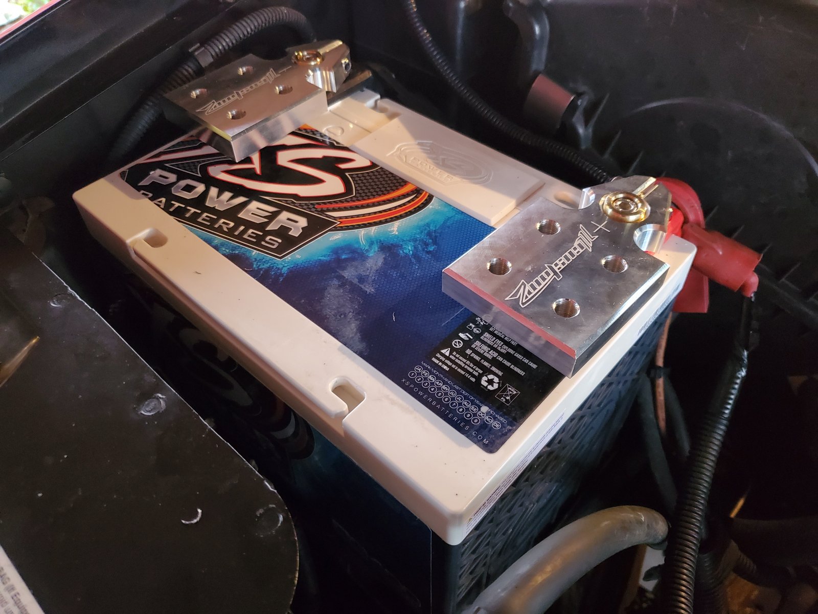

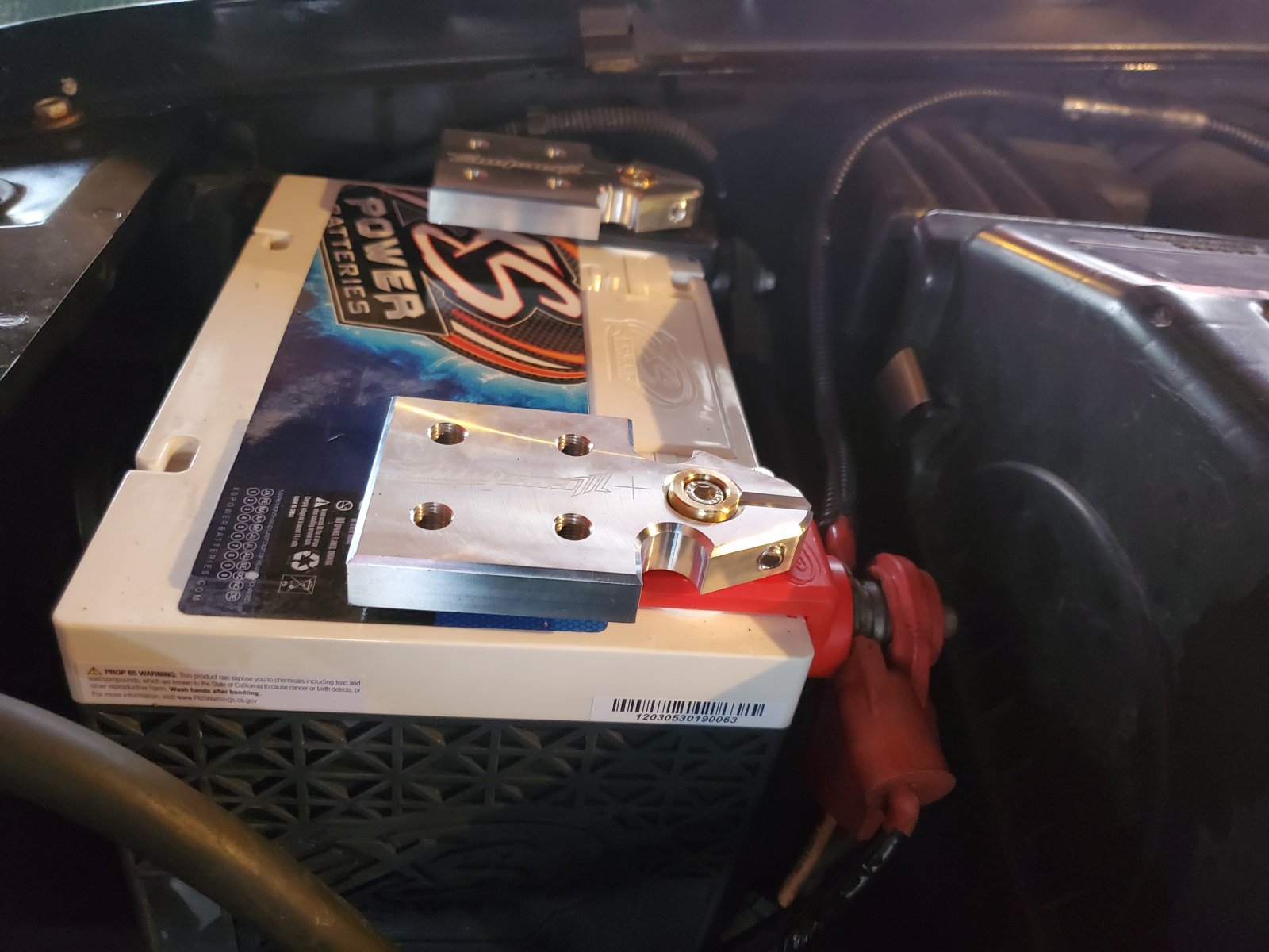

Big 3 pictures. Battery negative to ground, battery positive to alternator, battery negative to alternator bracket. There is a lot of ways to do this and i dont know that im in love with how i did it but it works.

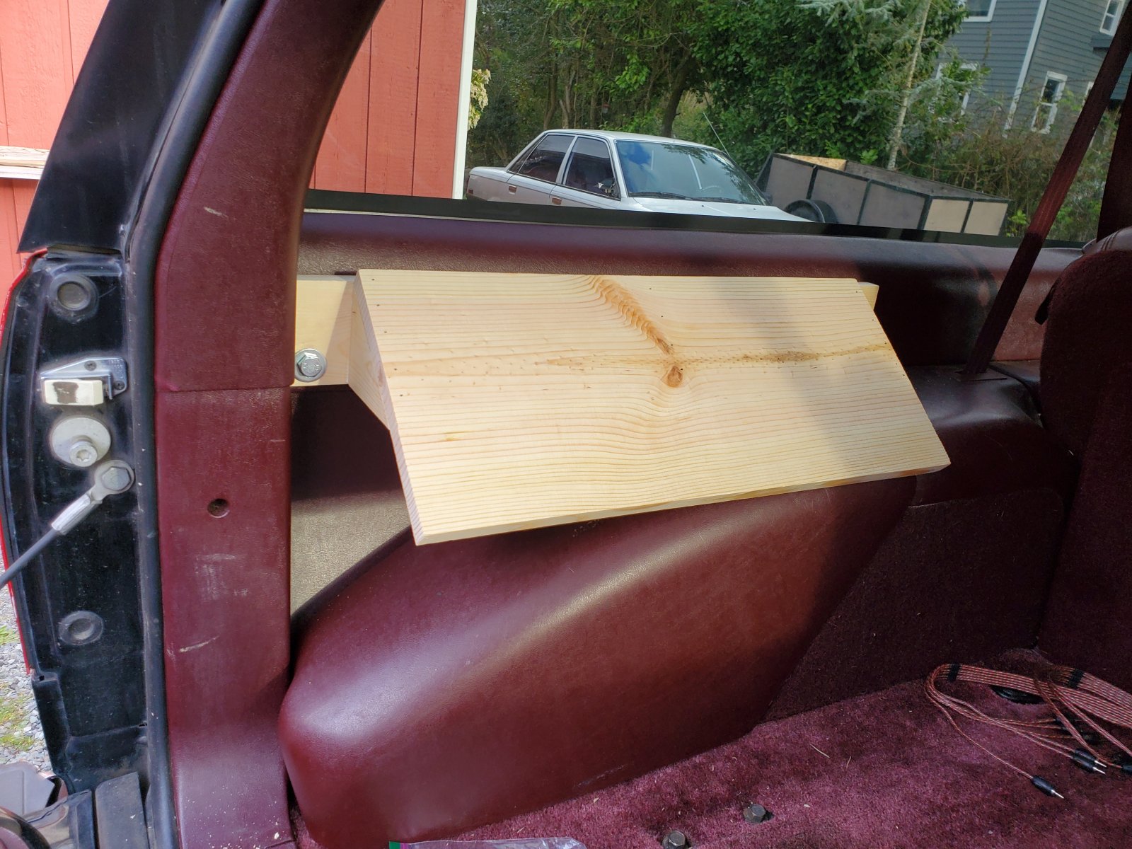

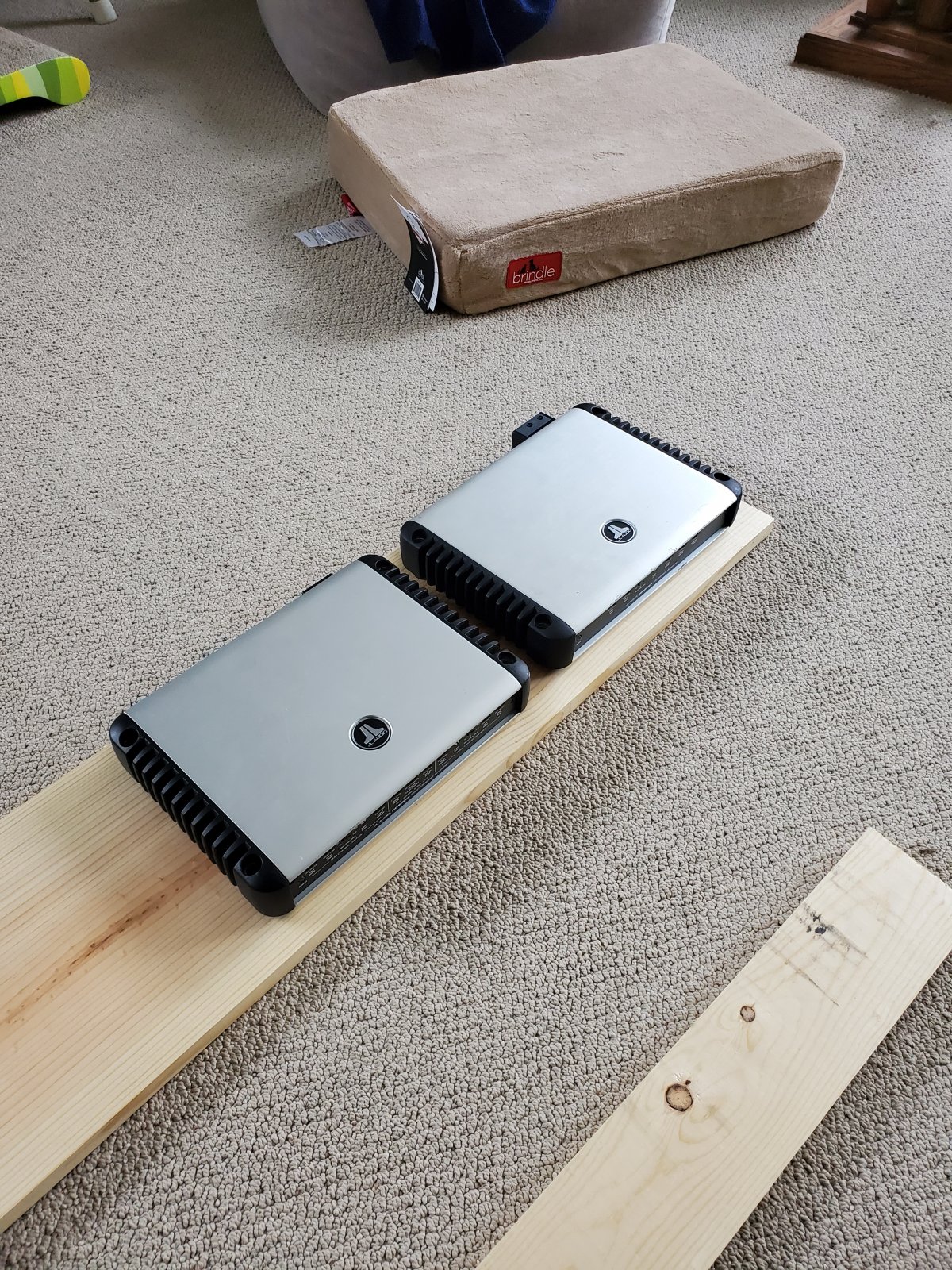

I was gonna make a amp rack out of some sheet metal but the longer i sit at home the more this wood i bought to make a dog beg starts to look like a amp rack

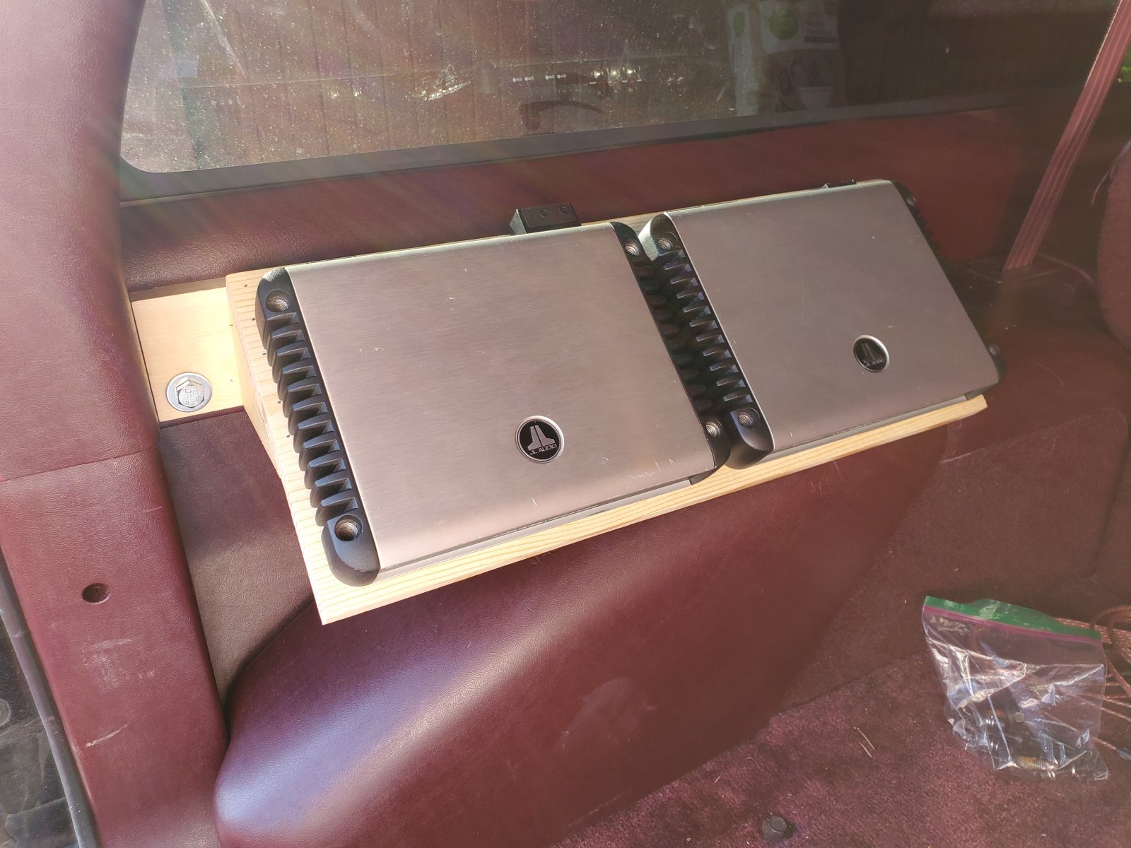

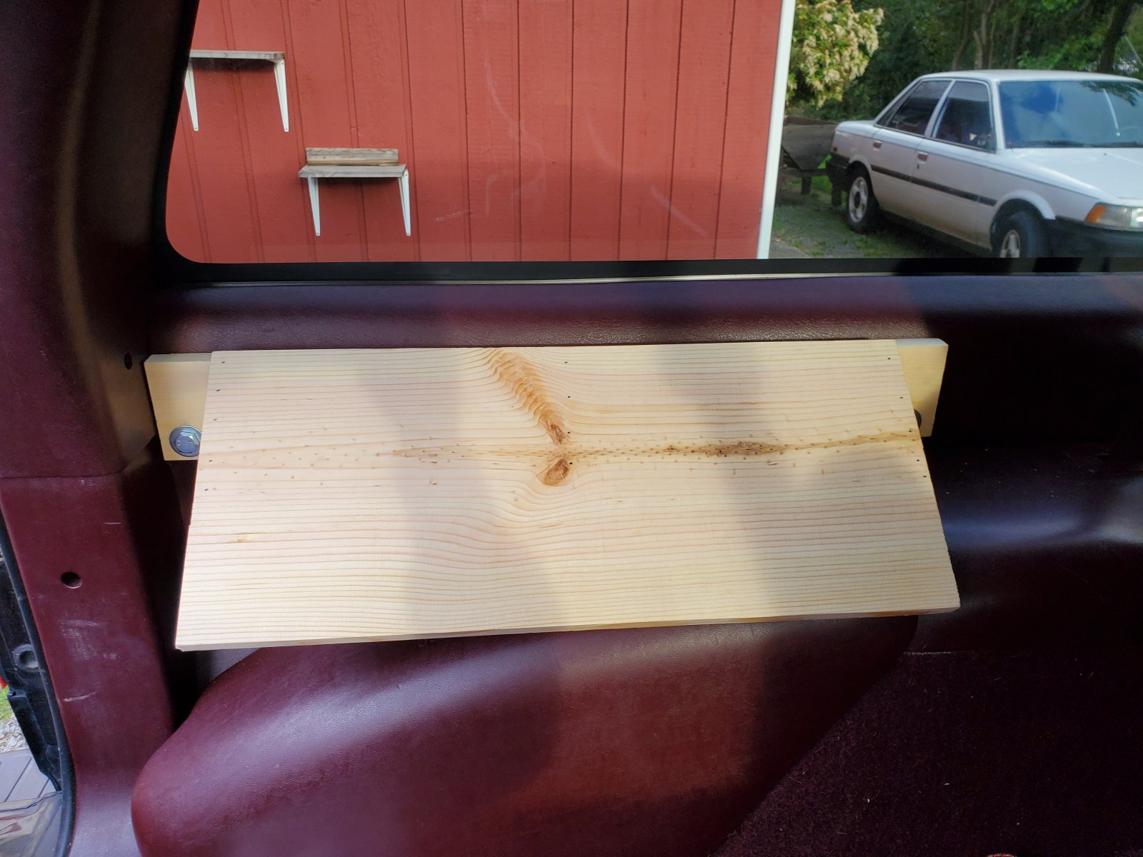

Well i have outsourced my amp rack to a friend of a friend that does really nice work. Gonna run me $300 but it will be worth it. Stay tuned for pics.
