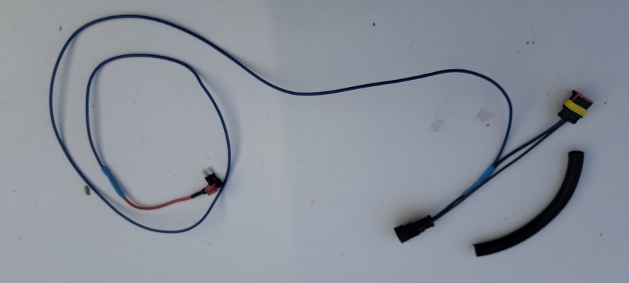

The 104 Harness has all 4 of these wires, but I only needed two of them, the Brown (F) Field Wire , and the Blue (L) Lamp Wire. The fuse tap comes off of the Lamp Wire. The female end goes to the factory alternator connector on your Tahoe, male end goes to your alternator.

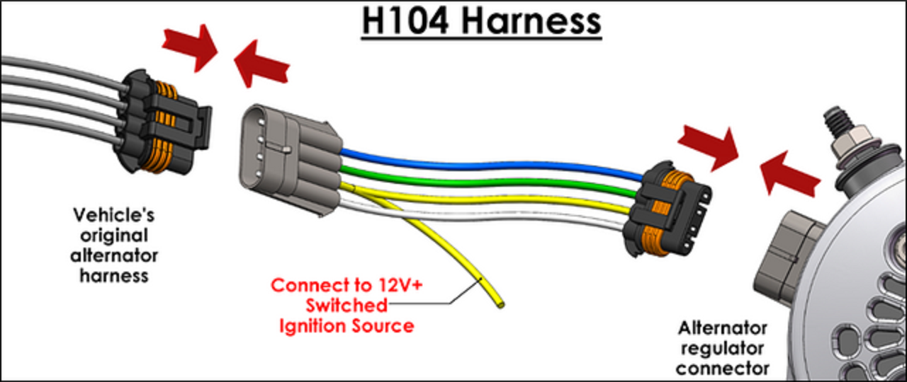

Here is the diagram I used for building mine. You may need all 4 wires, or just 2. If you face the back of the alternator, your 4 wires from left to right are PLFS. Pulse, Lamp, Field, and Sense. Lamp will be the spliced wire on the harness. It's important to note that you do not want to connect it to a constant 12v source. IGN E is the safest source for your fuse tap.
