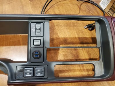

Small progress. Double din is cut and usb's added

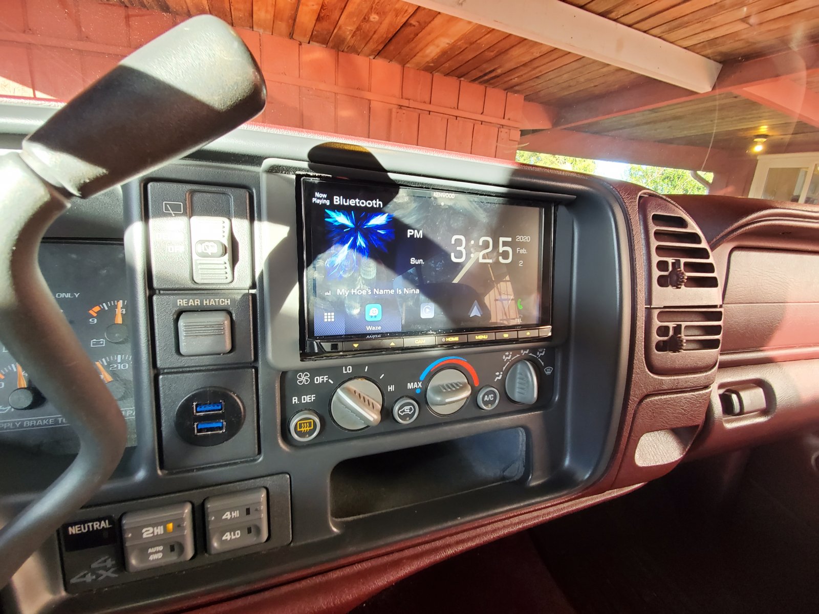

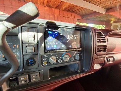

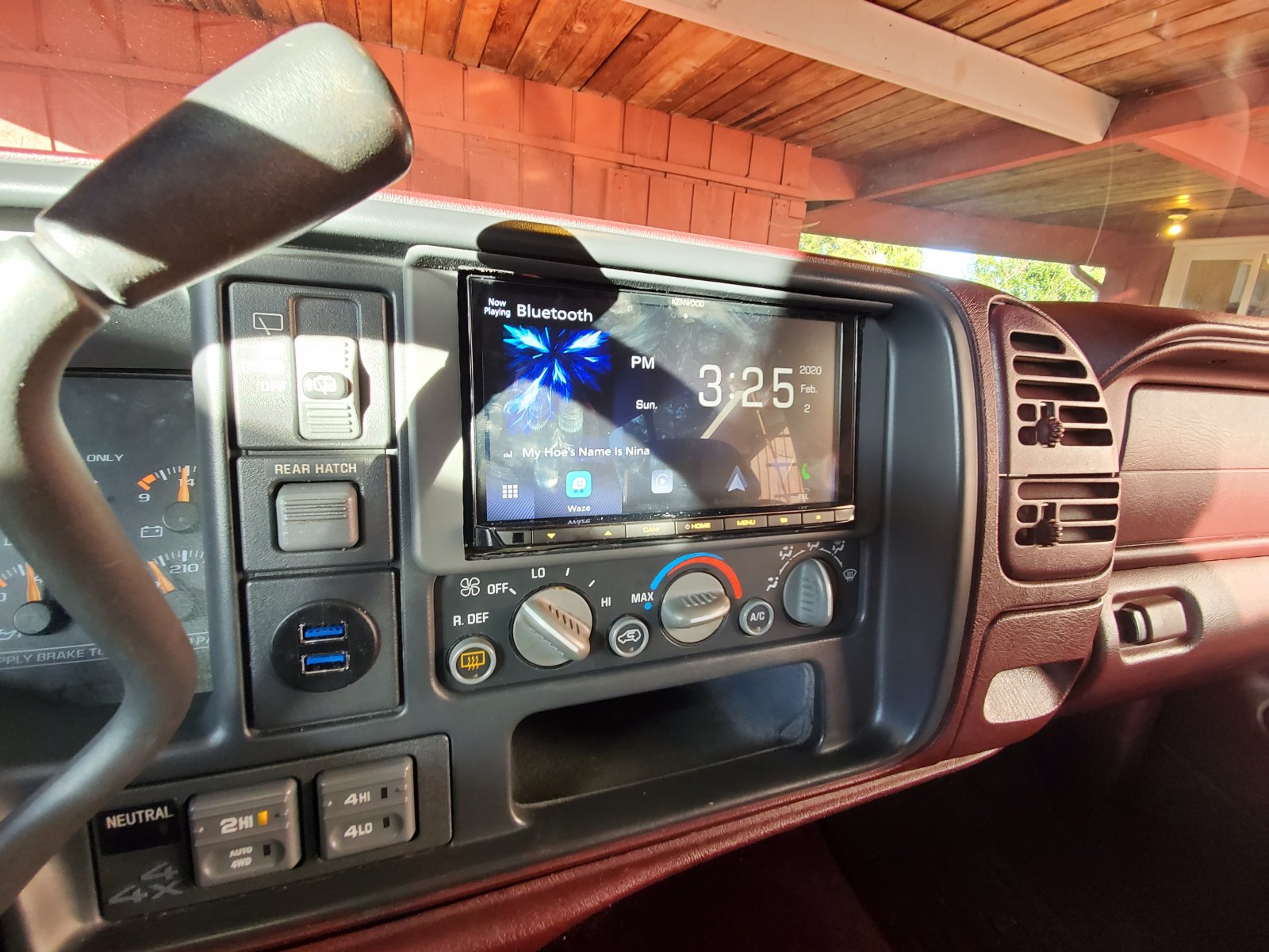

Got the reciever in. Dont mind the gaps, i though the deck would slide in and out through the hole so i trimmed the snap in bezel, i'll glue the new one in to fix the droop on the top too. Got another one on the way. Just a temporary install until i put in the rest of the stereo but i really like it!

Looks really good. Gonna utilize the cubby for something?

Looks good, what head unit is that? I’ve got all my parts to do mine, just deciding on a head unit
A kenwood with a lot of numbers and letters after it. Its pretty sweet so far. It has a motorized face so it can take a cd wich i like. Whatever technology the screen has seems to be the same as the modern smart phones. The image and touch screen abilities are simular to my samsung note 10

Figured out my android auto wouldnt work because i didnt hook up the parking break wire. So i didthe bypass mod by splicing it into the ground wire. Works perfect now!
