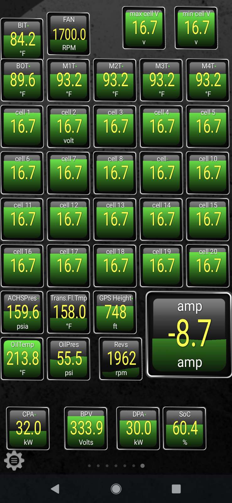

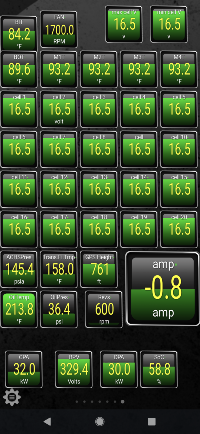

just cause of curiosity, I logged mine today, mainly to see but also it does seem to be a good idea from an earlier post, to know what normal for your truck is, so you can compare later. this is up to temp, 215deg oil temp, but I believe that's calculated 80ish deg day. was a good hour drive time, 41% left on the oil change meter. 5w30 m1 about 4 months ago.
oil and rpm are lower middle of the screen cap. I know it's busy haha
600 rpm 36psi
1000rpm 48psi
2000rpm 55psi and probably on the bypass around there so I didn't do the 3k.
that is with the afm plugged off, but seems unnecessary high by traditional ls standards. this pump might be good for guys with low pressure that the o ring test doesn't fix. still wonder what the point is, unless maybe with all the stop starts this builds pressure faster after a start? I bet this thing starts 30 times or more a day on a normal drive cycle.
