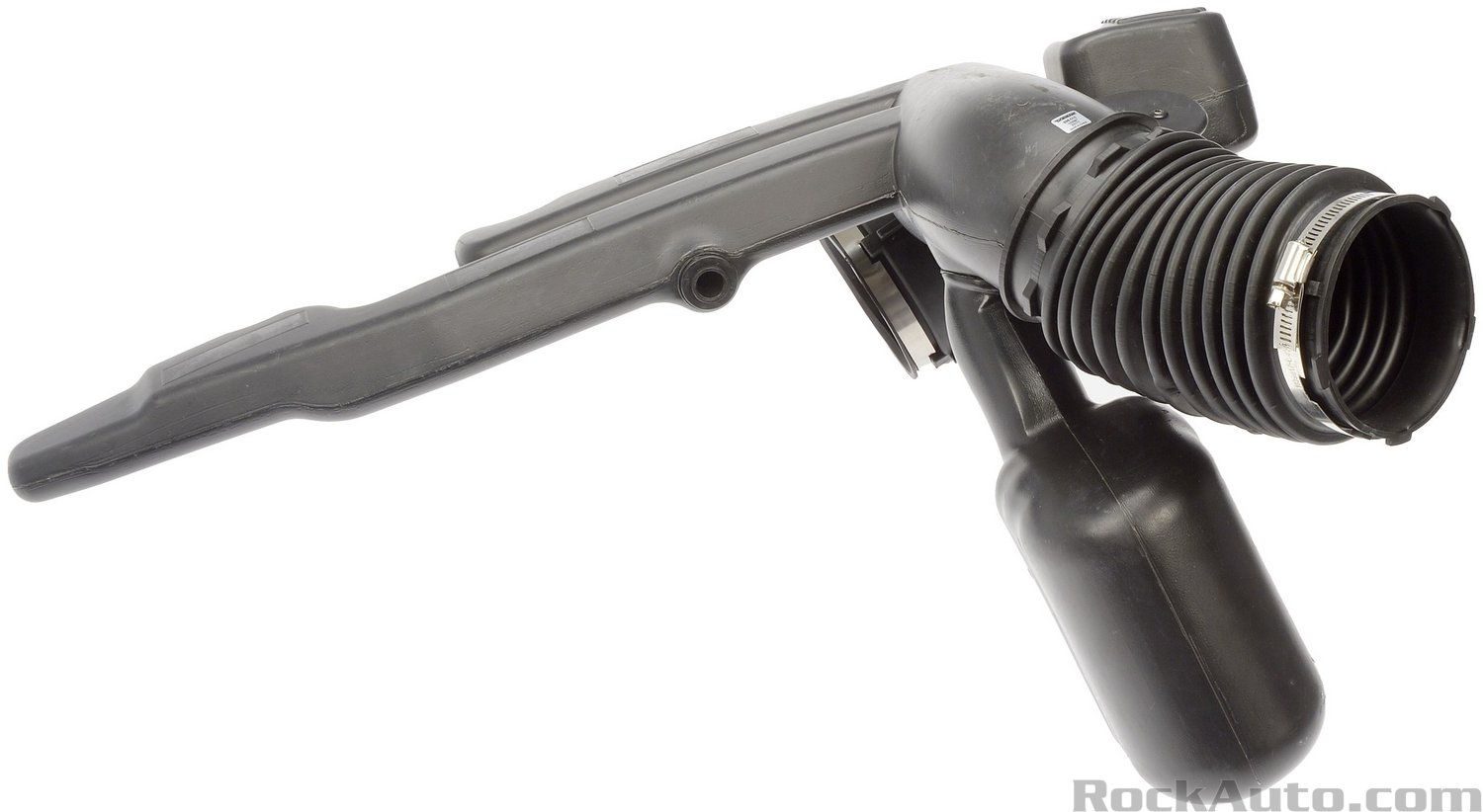

That said, on the big plastic intake snorkel there is a what is tantamount to a catch can near the Helmholtz resonator, but it is dry as a bone.
What does this catch can looking thing look like?; post a pic of it.
Any chance you took a pic of the underside of the driver's side valve cover when you had it off? If so, please share.
It's just a dingleball that hangs down on the intake... another frequency tamer.
