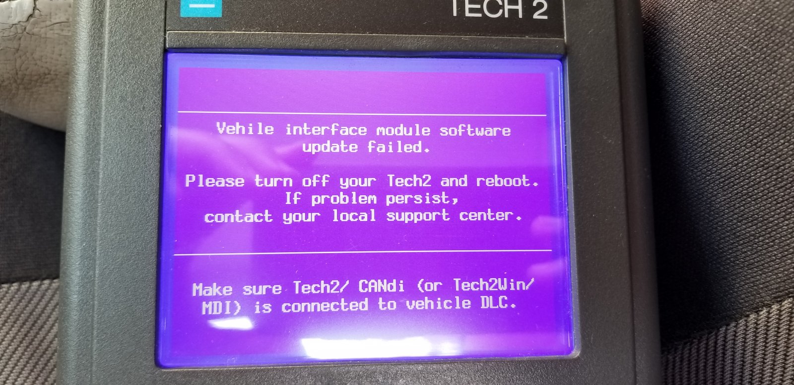

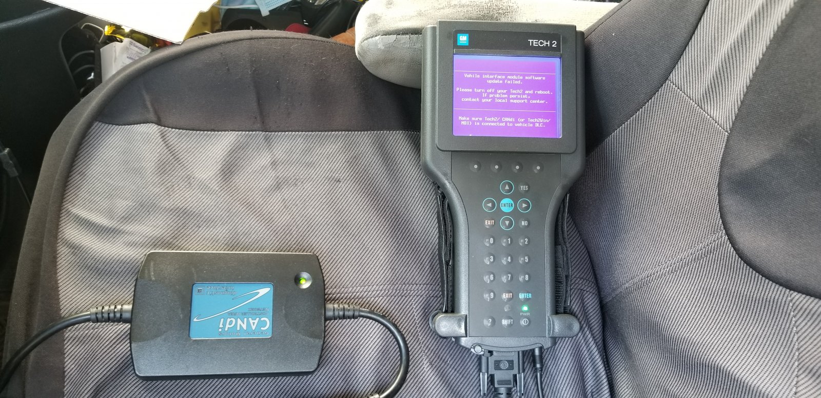

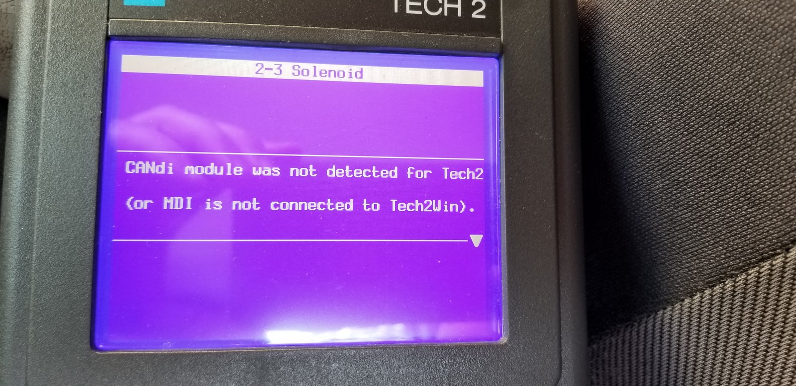

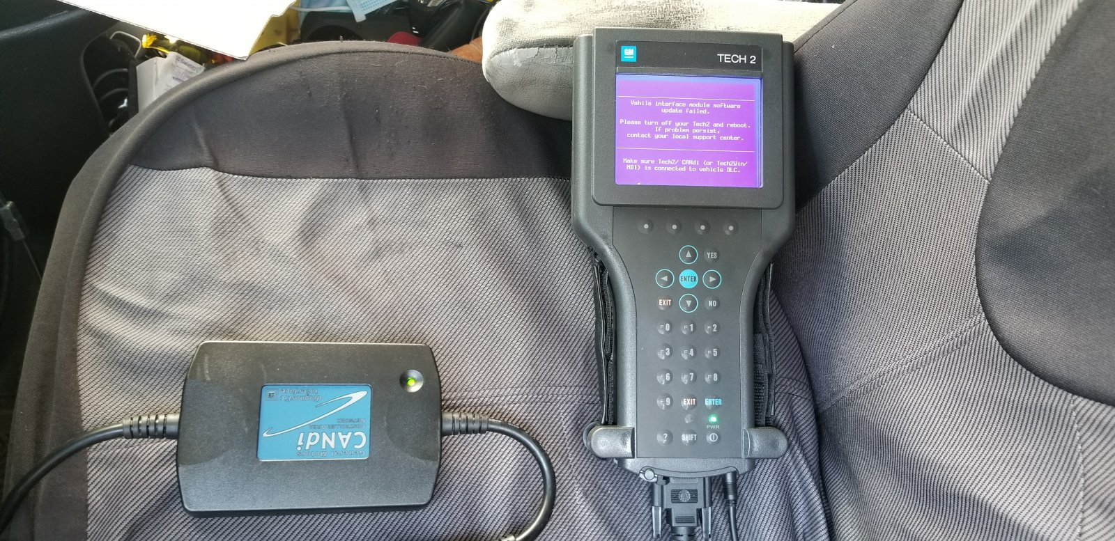

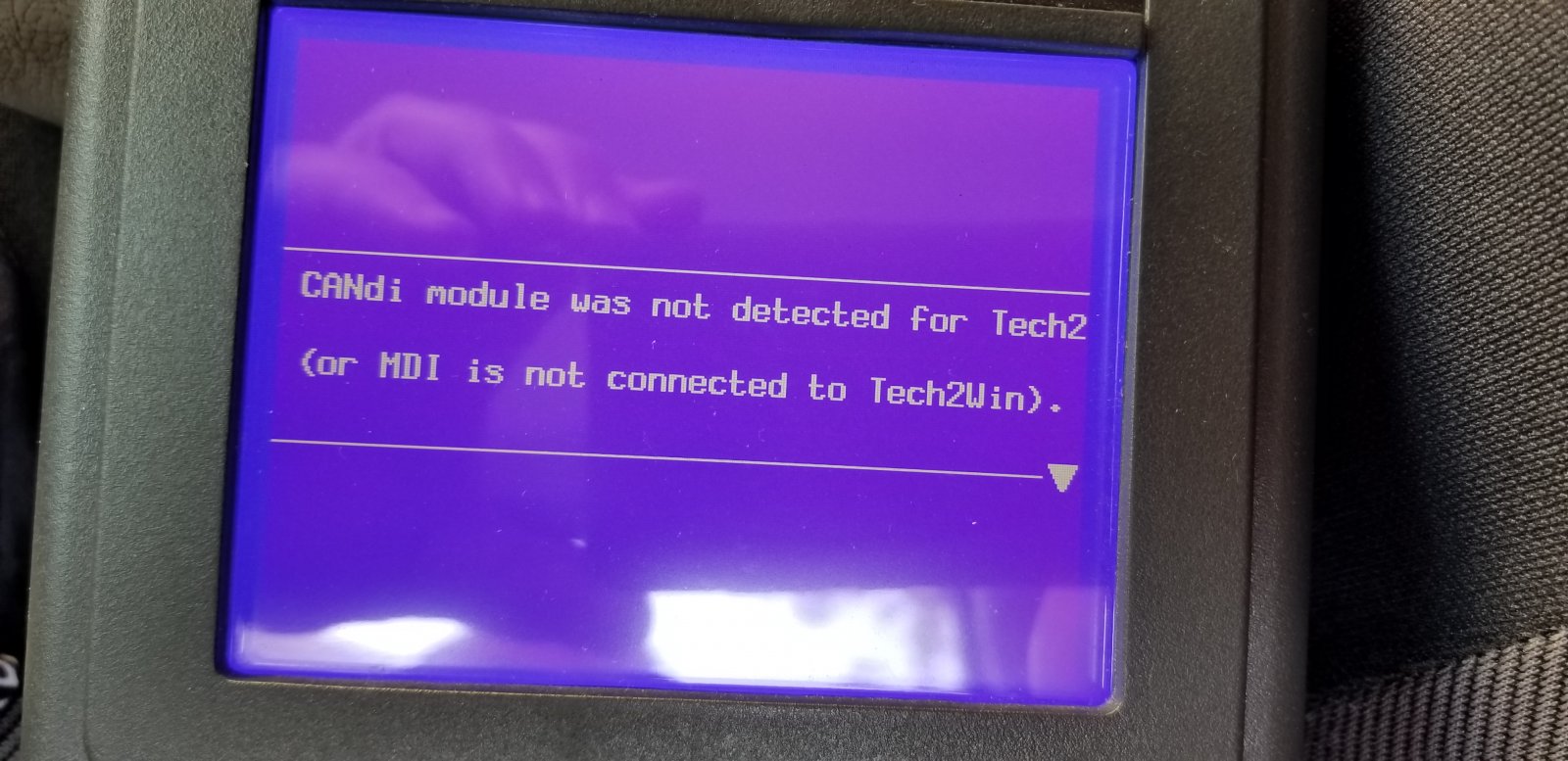

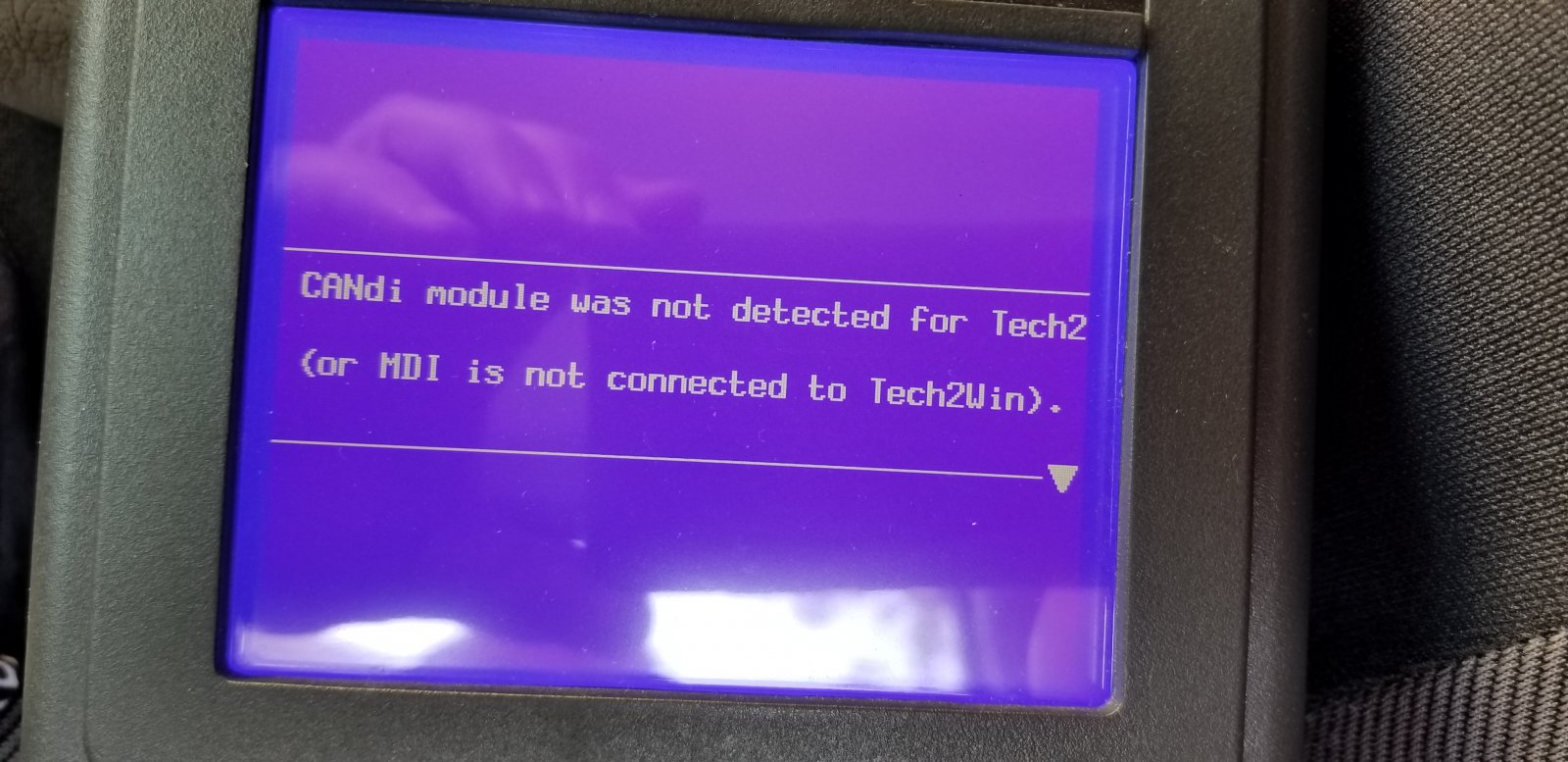

I tried mine out today, but I think, MAYBE the candi module might be bad.
I tried running trans codes for my work van. Kept getting this.
I scanned 1st without the module between the tech 2 and obd. I did get engine codes, but no trans codes. Then with the candi module in between. Is the candi needed to get the trans codes? I tried getting the tech 2 to test things--wouldn't do it. Am I doing something wrong? And how are you supposed to know what designation to use for the vehicle?

The red screen looks weird
When the Tech2 first boots up, it does a bunch of self tests listes on the screen. Do they all pass?

the vehicle selection goes by the vin code, I don't remember what position it uses on my 03 silverado it wasn't what is was supposed to be, anymore I just guess there is only so many choices and when you select one it usually list's some vehicles if your vehicle is not listed then just backup and go the next one
