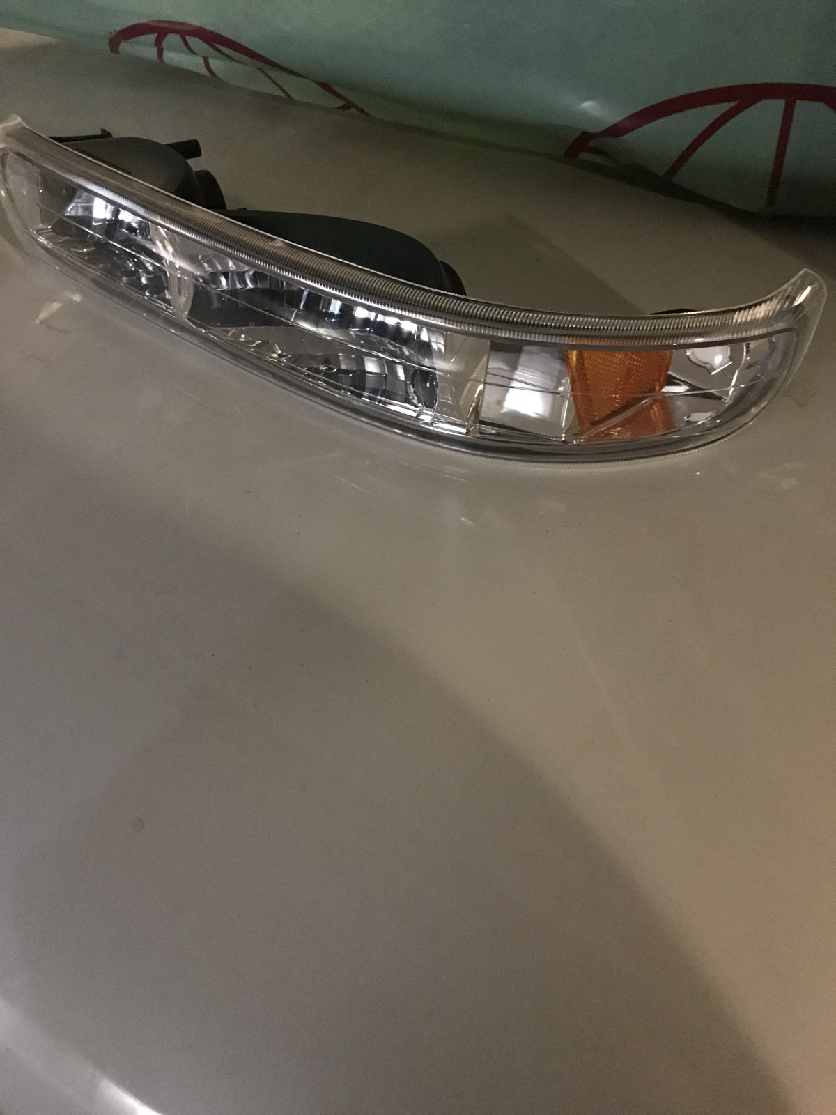

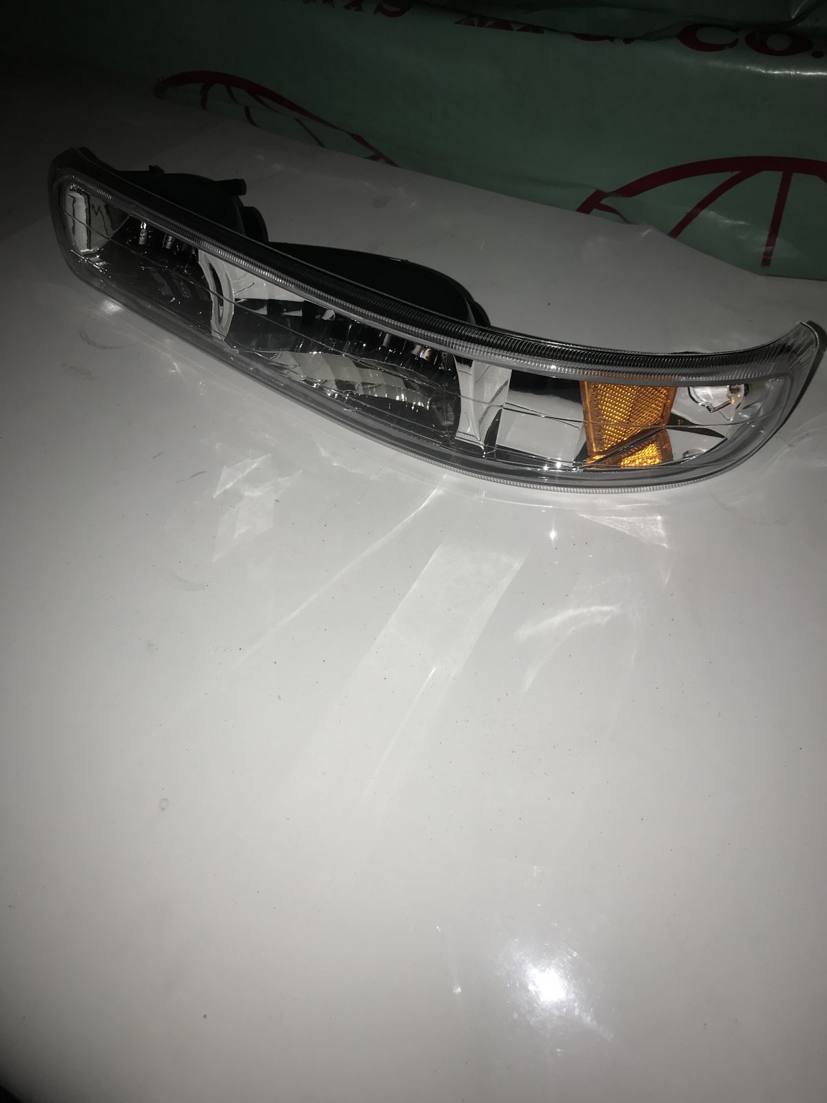

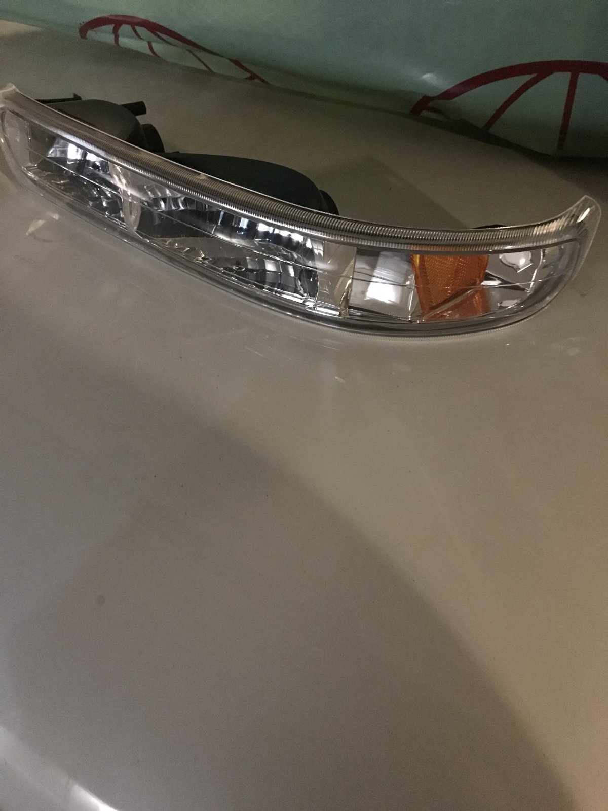

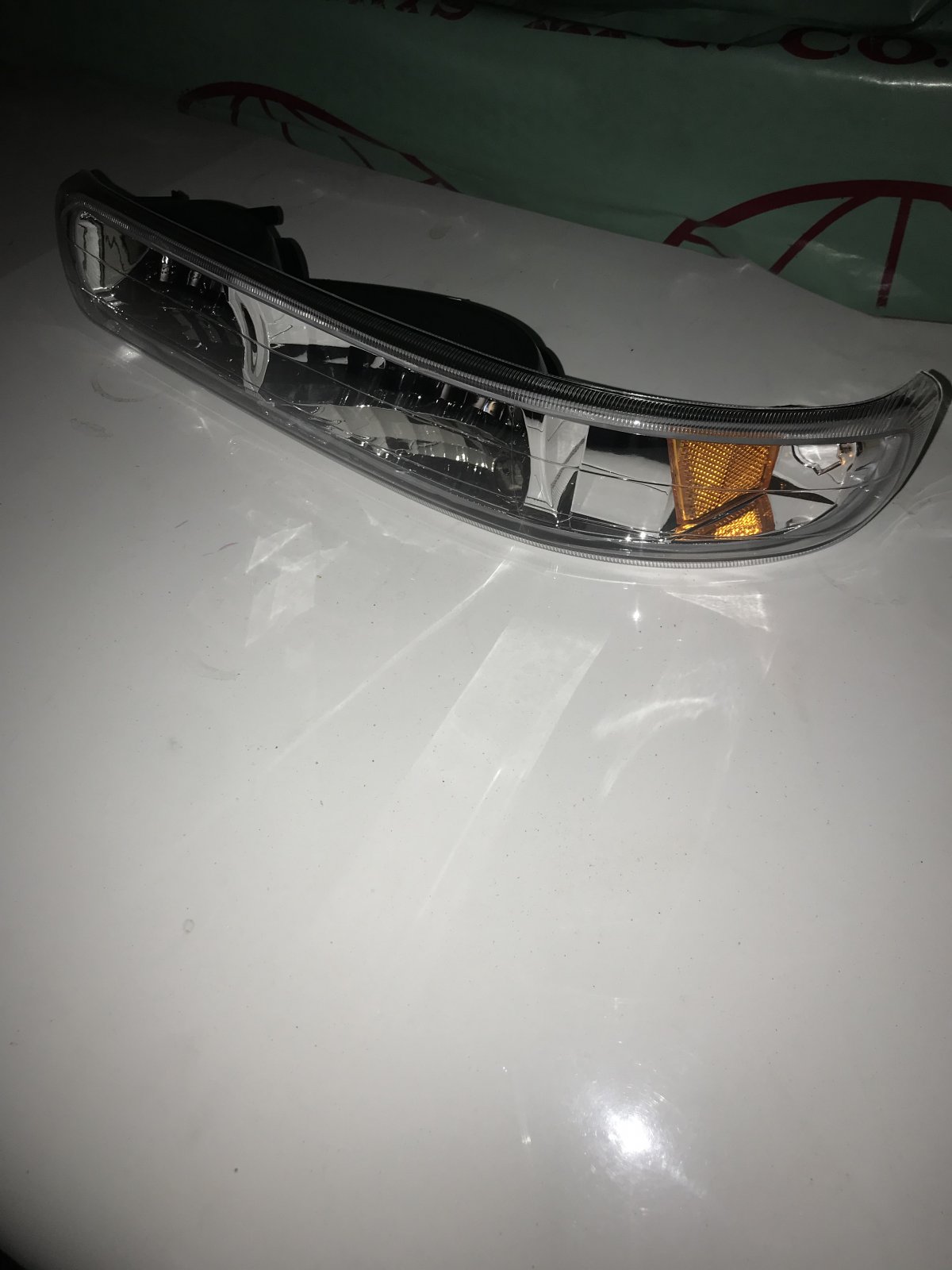

Ok @Tonyrodz, corner lights showed up early ....check the pics and tell me if it's worth baking and trying to remove the amber reflector. If i try to take it out is it worth it, or will it ruin the housing? What if I just don't put a light in that corner where the reflector is?

My answer is always remove any trace of amber. It won’t ruin the housing, it will just be missing it. Just depends on what the owner likes. I will say this tho, not having an amber reflector is illegal in all 50 states, same with not having a side marker. But I’ve never been harassed for it in 20 years of amberless driving. Every vehicle Ive ever owner I removed the amber. But I’ve never lived in states with those strict vehicle yearly inspections.

@05Single Yeah bro I am the same..."ANTI-AMBER"!! Alright I'm going to give it a go and attempt to remove of it!! @Tonyrodz @Thatsquishykid717 @05Single any pointers before I get started? Don't want to melt the lights or ruin them. What's the best product to use to reseal them? Appreciate it guys!!:thumbsup:
Never go above 250 for more than 10 minutes. Lots of videos on YouTube . I use a butter knife and several flat head screwdrivers for prying . Be patient, don’t expect much movement first time around out of the oven. Start on the outside. Use gloves . I use retrorubber . But I’ve used interior/exterior sealant from Home Depot . Black for black and grey for yours because they’re chrome

Also you can push the amber out and just open the corner of the light just enough to slide the amber reflector out then close it back up and put it the over reusing the same sealant. No need to open them all the way up if you’re not gonna do stuff like paint or strips etc

I agree with @05Single he is a little more ballsy than I am though I just always bake my lights at 170° for 7-10 min at a time. I always use morimoto retro rubber. Used the Home Depot stuff before but didn’t have the best luck with it. I did get lucky with a set of corner lights before I was able to get the amber reflector loose, get some small side cutters in the 194 hole, and cut the amber reflector into small enough pieces for it to fall out. Only tried that on one set though but it worked pretty good
