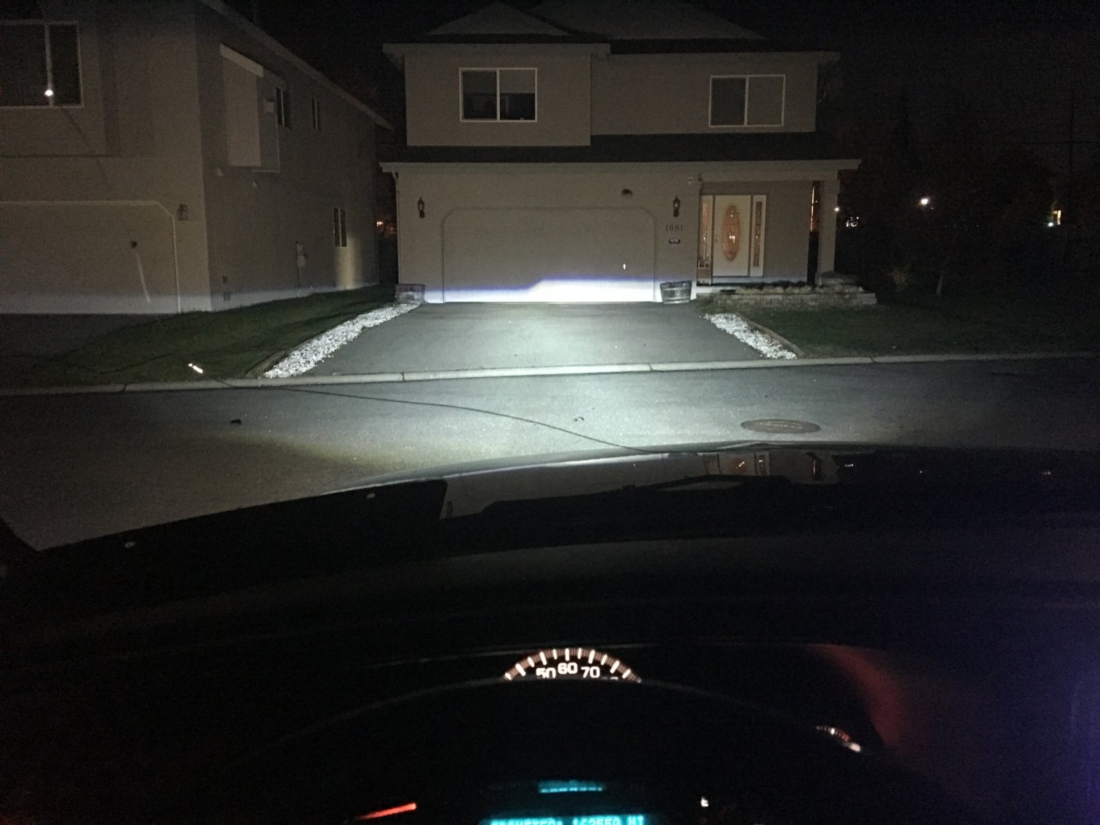

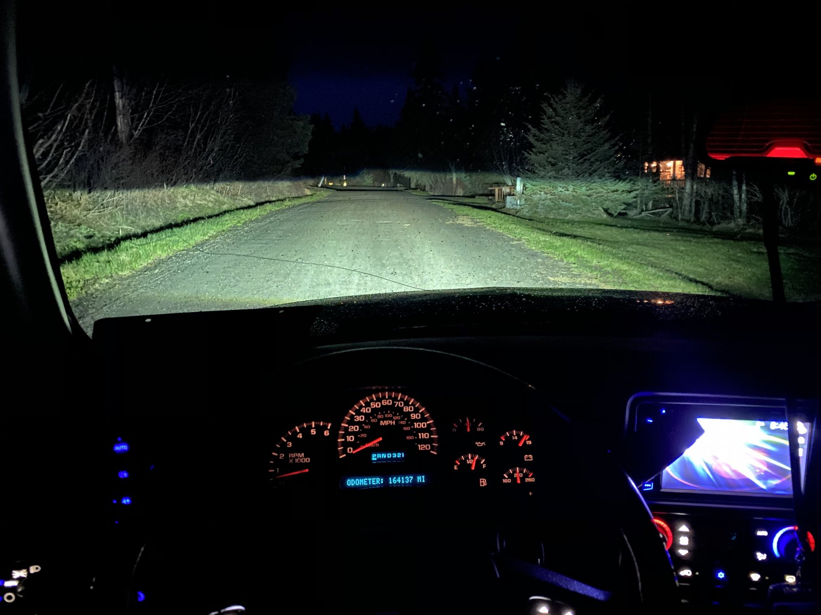

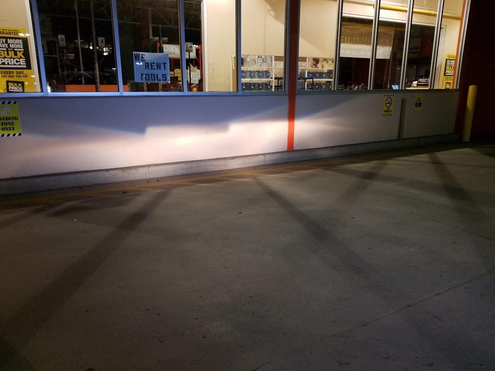

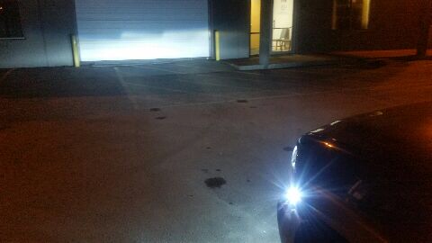

Apc projector headlights right out of the box with supplied 9006 halogen bulbs
Apc projector headlights right out of the box with 9006 hids 6000k temp
Apc projector headlights, but projector replaced with acme super H1 bi-xenon projectors 5000k temp
You decide for yourself which is brighter, more practical, and just plain cooler looking :cool:

That's a no brainer to me Dave. Nice work. Curious about the bi-xenon projectors. Does that mean your single bulb assembly has a hi/low switch within the single projectors? Have any pics to help me understand? Thank you sir!

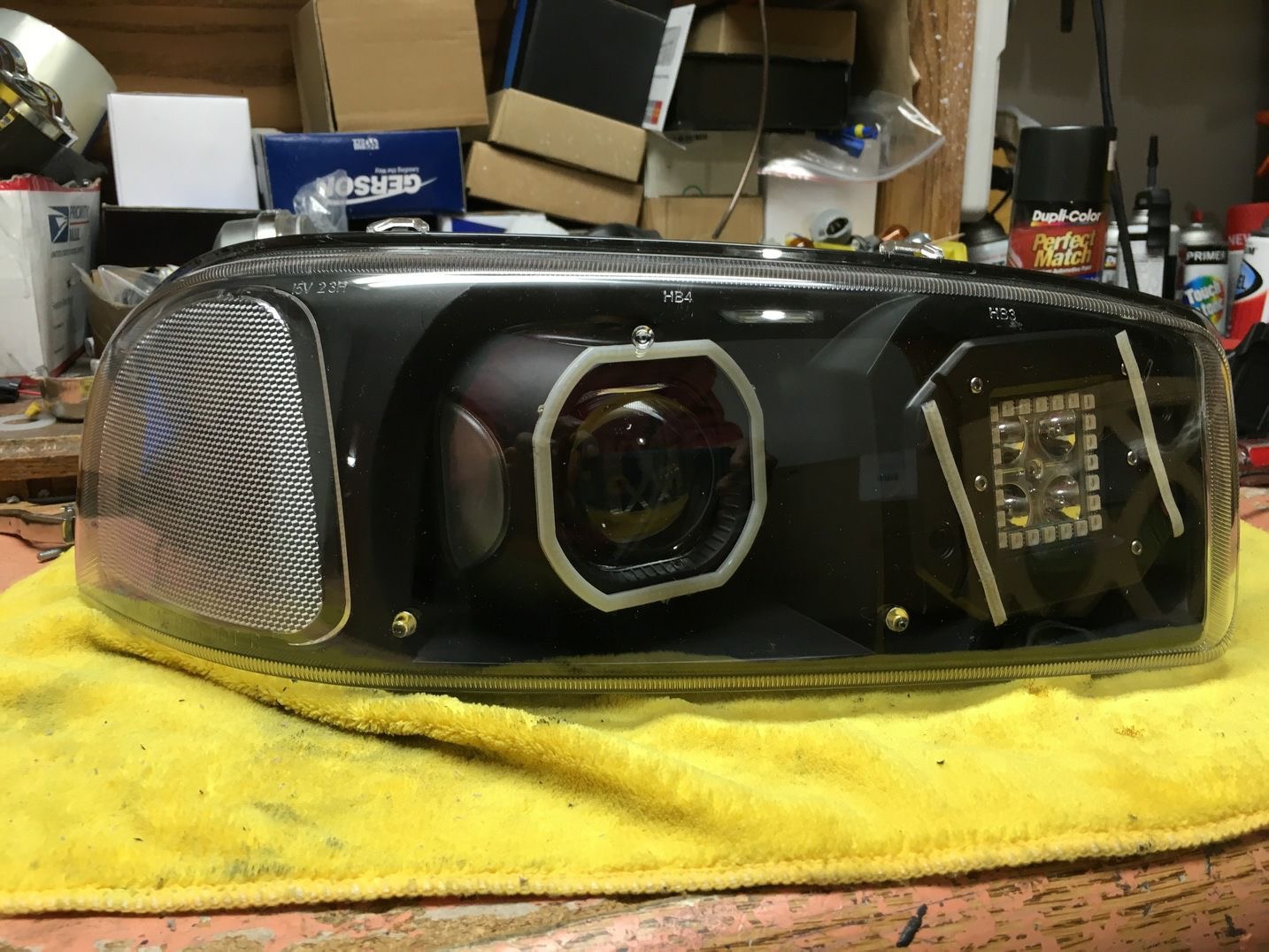

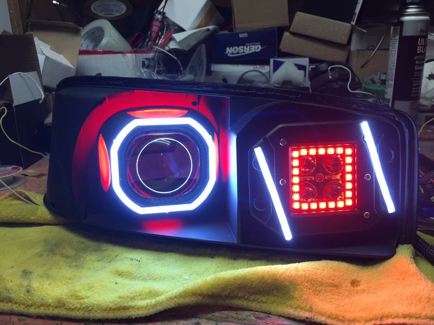

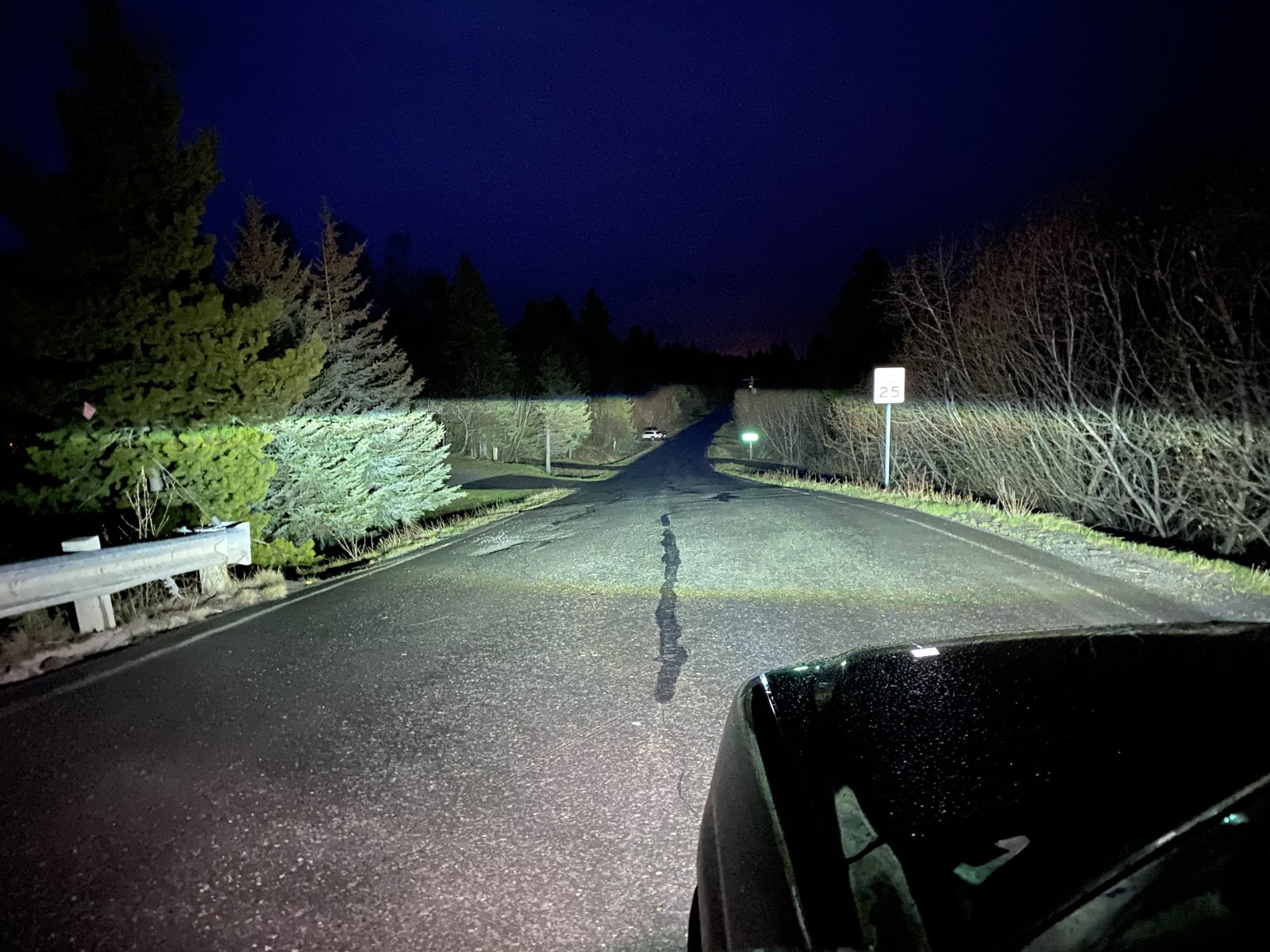

Yep yep ,here’s the high beams. Having a high beam built in a projector it obviously “projects” and magnifies the light out. That’s why my oem high beam spot is blacked out and I relocated my drl in that spot.
Looks great! I need to figure out something better for my Yukon LEDs..
Thanks . Lots of options these days for our trucks

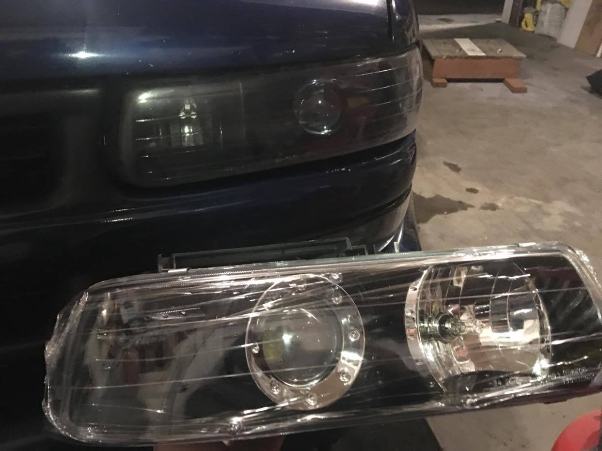

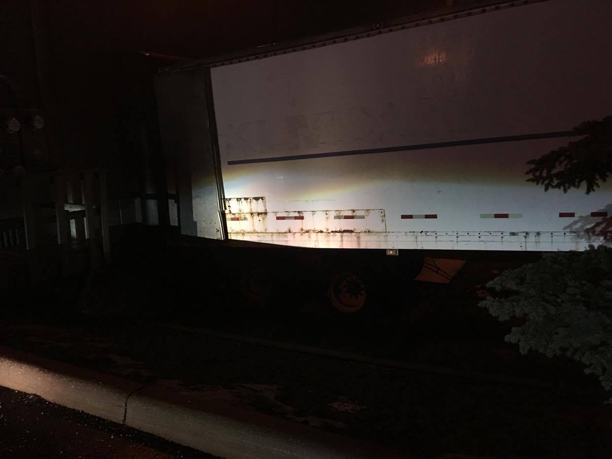

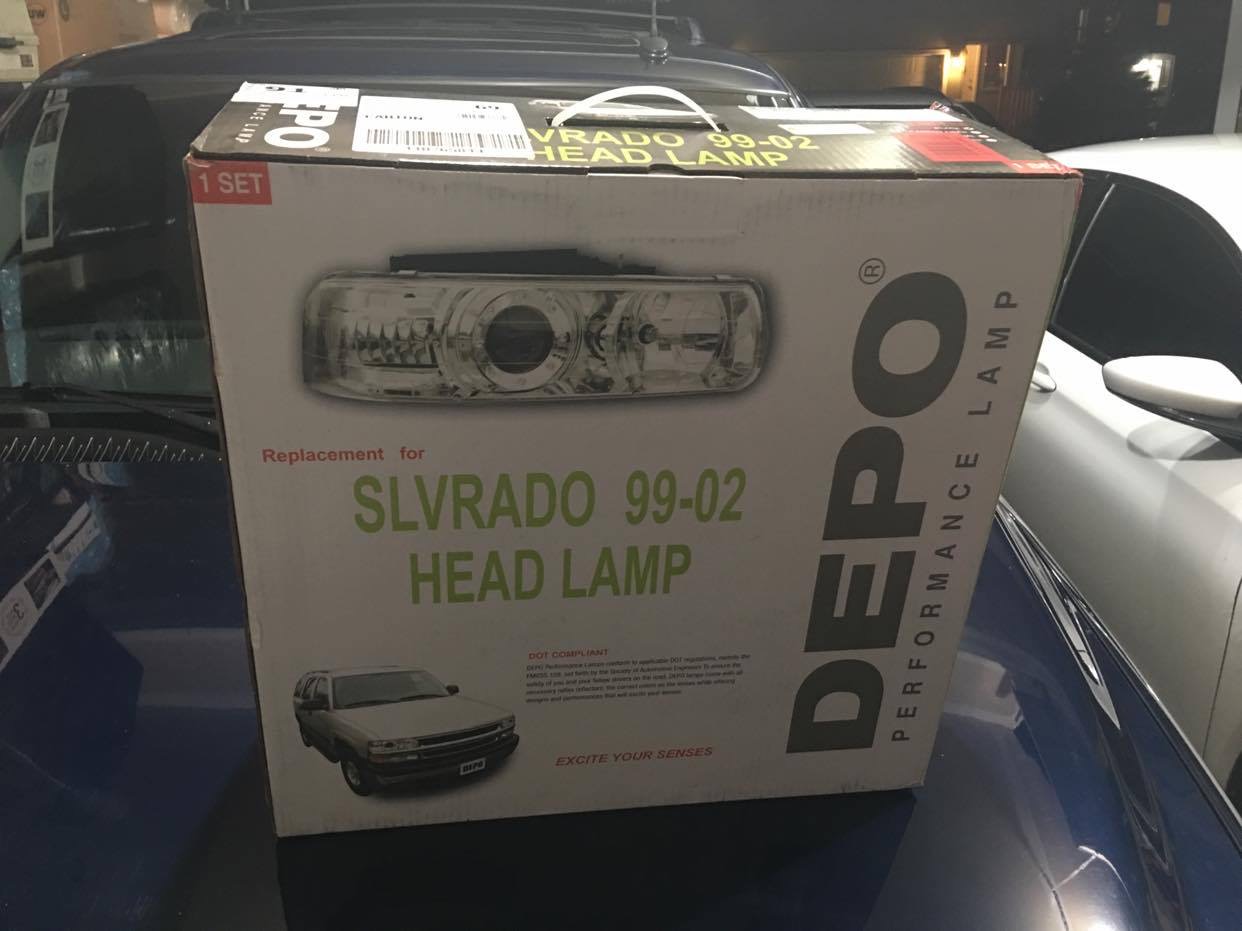

Depo projector headlights. Out of the box the output isn’t terrible, better than stock for sure.

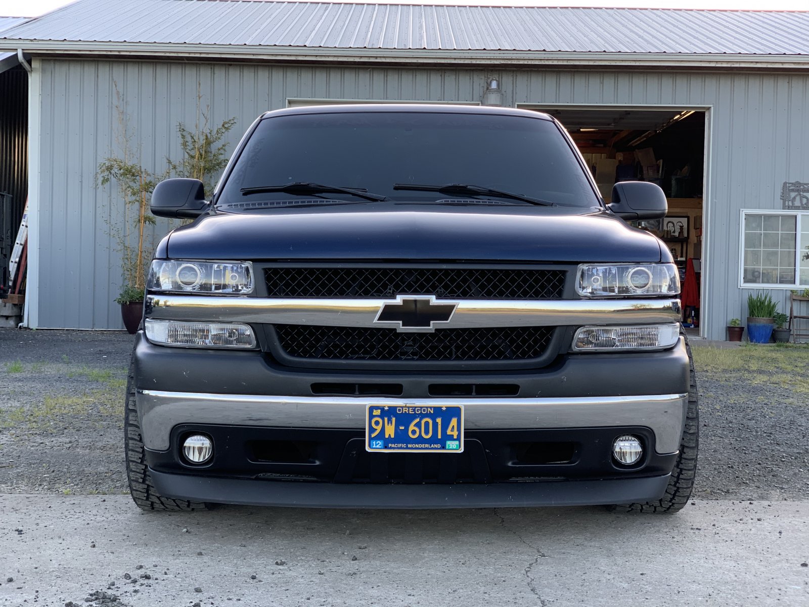

I did oem+ style kind of. A little custom still but kept it simple View attachment 247544
