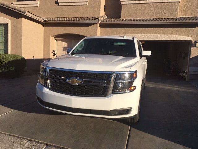

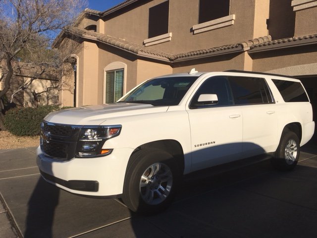

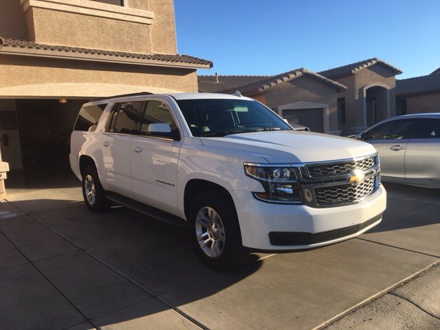

Tahoe PPV Deflector installed on 15 Suburban (shorter lower valance that comes on Police model)

Was this a direct bolt onto the Chevrolet? Or did it require alterations? How much did it cost?
100% Direct bolt on for tahoe and suburban, cost about 225 to 250$, and I paid an hour of labor or 2 to get a body shop to remove the stock piece and install the new one.

The new one is about 1/4 the size of the original one, I will measure it this evening to give you an exact number

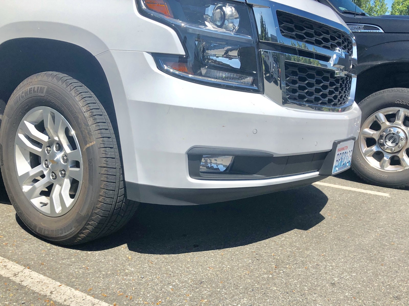

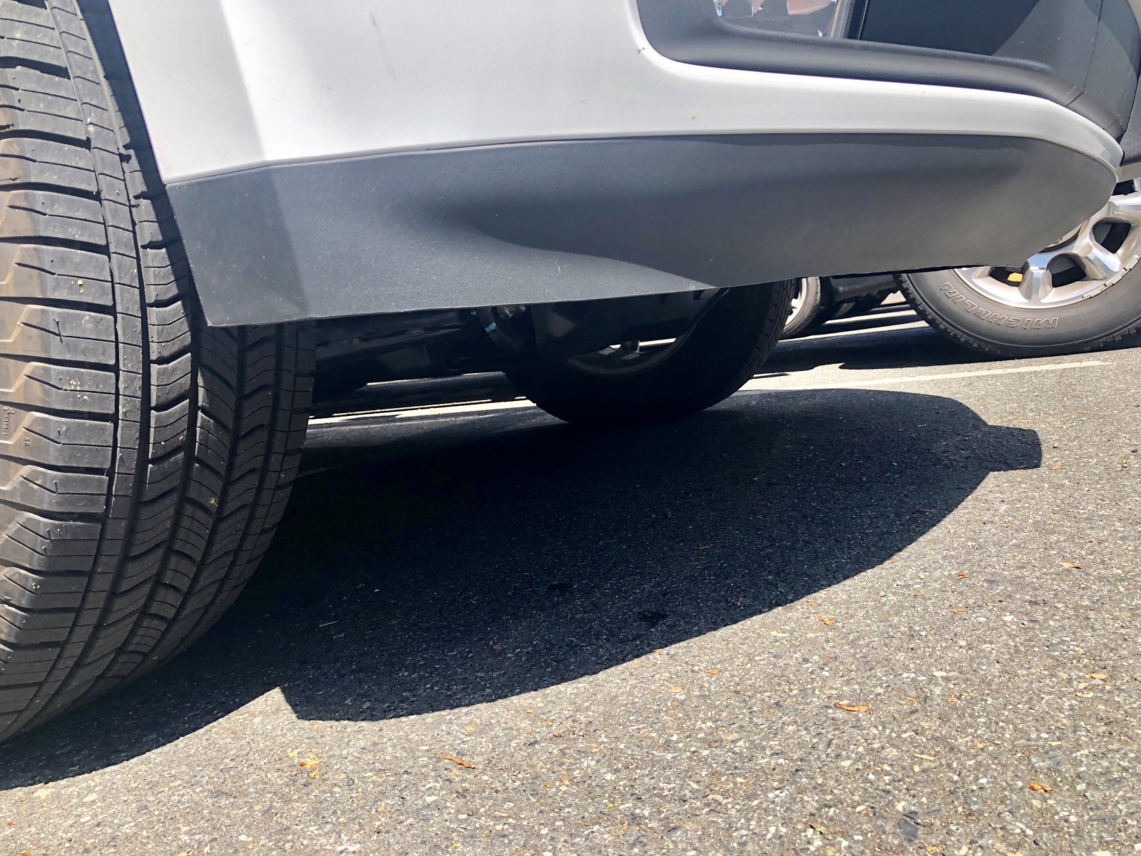

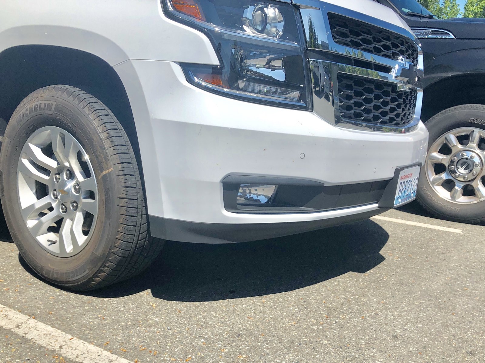

We just finished putting on GM Part # 23365760
It is the Lower Deflector that comes on Tahoe PPV. it is about 1/4 of the length of the stock piece.
It's a small mod but I believe it has changed the look on our suburban quite a lot, we like it.
I got it at, for 281 plus shipping
https://www.gmpartso...lector-23365760
The main reason was to gain ground clearance, for these off-road times, like when parking at a mall to clear curbs smile.png
Also already helps on steep driveways and coming out of parking lots...
The removal of the old piece and installation of the new one was quite simple. Remove some bolts/ torque screws, pushing down some clip, partial removal of front wheels liners.
I can't comment on any decrease in MPG on highway, as we use this truck in town.
