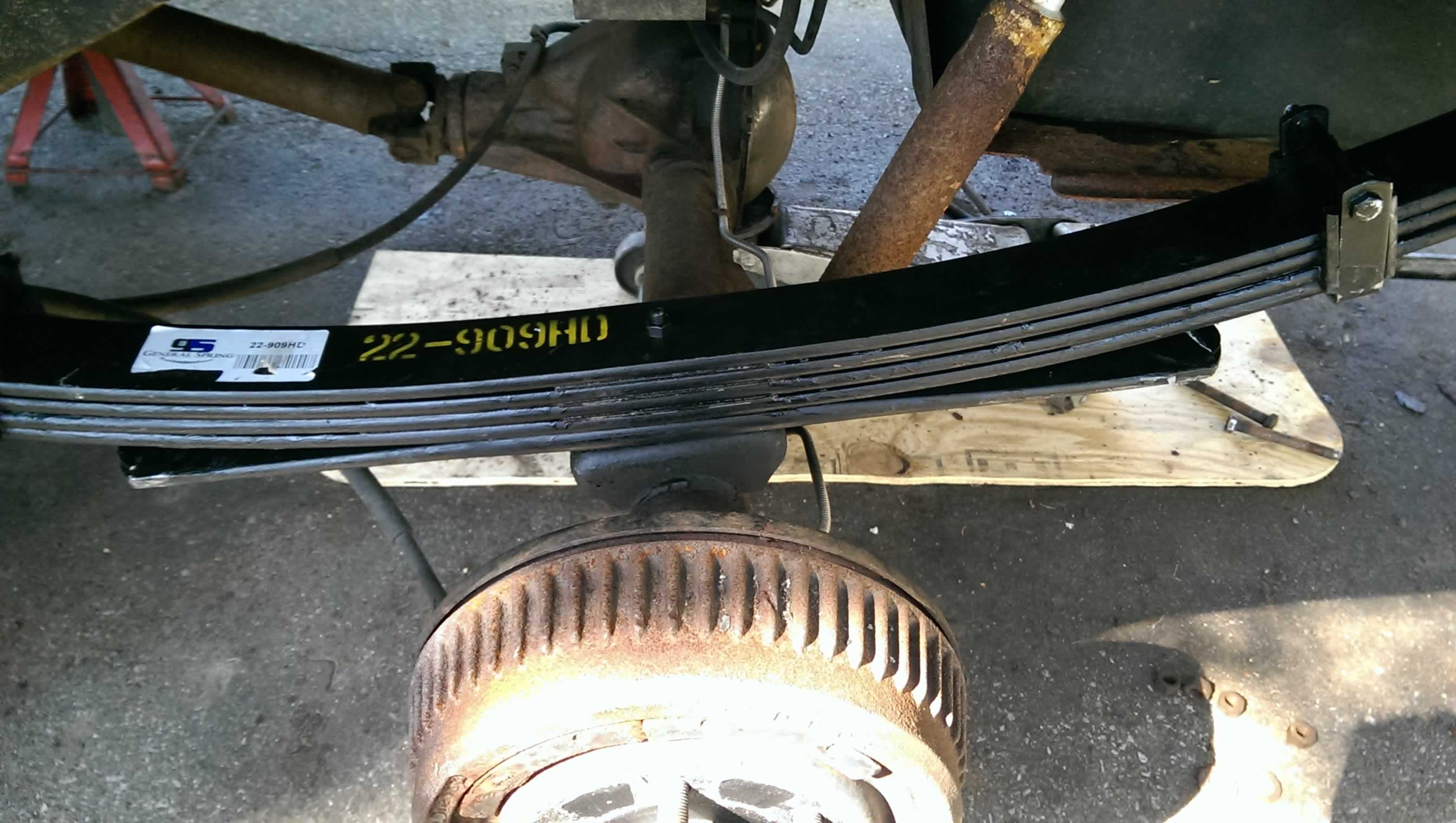

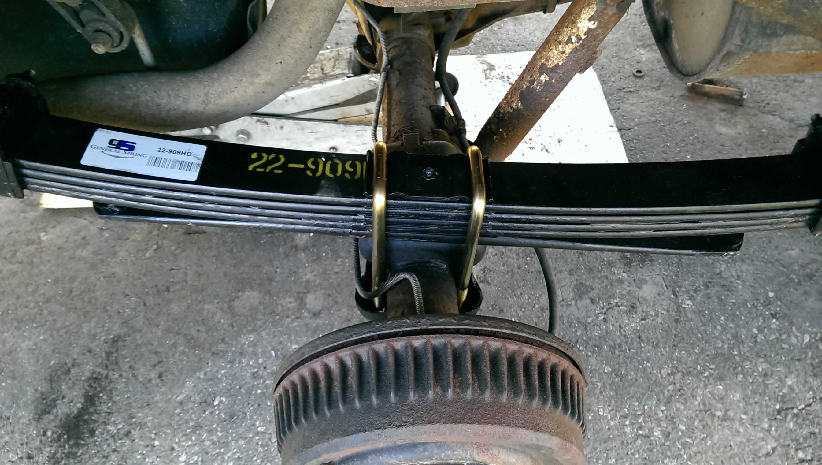

Hey Movie,
Saw your posts late, sorry. I do have a stock set up except for a pair of torsion keys. The bounce and sway I was feeling were definitely due to the worn springs. Going highway speeds in a turn was just awful. The rear was sagging more on the drivers side believe it or not. It all changed with the new springs and shackles. Whether or not you get the HD type, new springs should help your issue. Like I said though, the HD versions are STIFF! It rides a bit harder than I would have liked. Also it raised the back up about 1 1/2 - 2". She sits with a very slight rake and a lot more space in the rear wells which is just fine.

Install all your bolts and tighten accordingly. The one thing I didn't like about the new shackles is that there was a lot of space between the bushing and the shackle steel. I tightened the bolt enough to close the gap a little without binding.
The ride overall is a little stiffer. Im thinking its because of the HD springs but the lazy bounce and sway is gone. Also the back raised a good inch at least. I have torsion keys in the front at the minimum and even with them, the back is a little higher. Overall, im happy with them.
