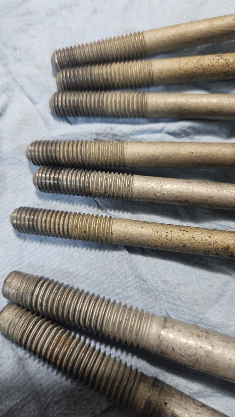

Thanks Again Everyone.
Cleaned the bolts with a wire brush on a Dremel
Blew the holes out,
Put anti-seize on each bolt and screwed them all in without the water pump.
Installed the water pump.
NO leaks
We are good!
Good work. Always clean bolt threads, and clean threaded bolt holes with a thread chaser making these replacements.
