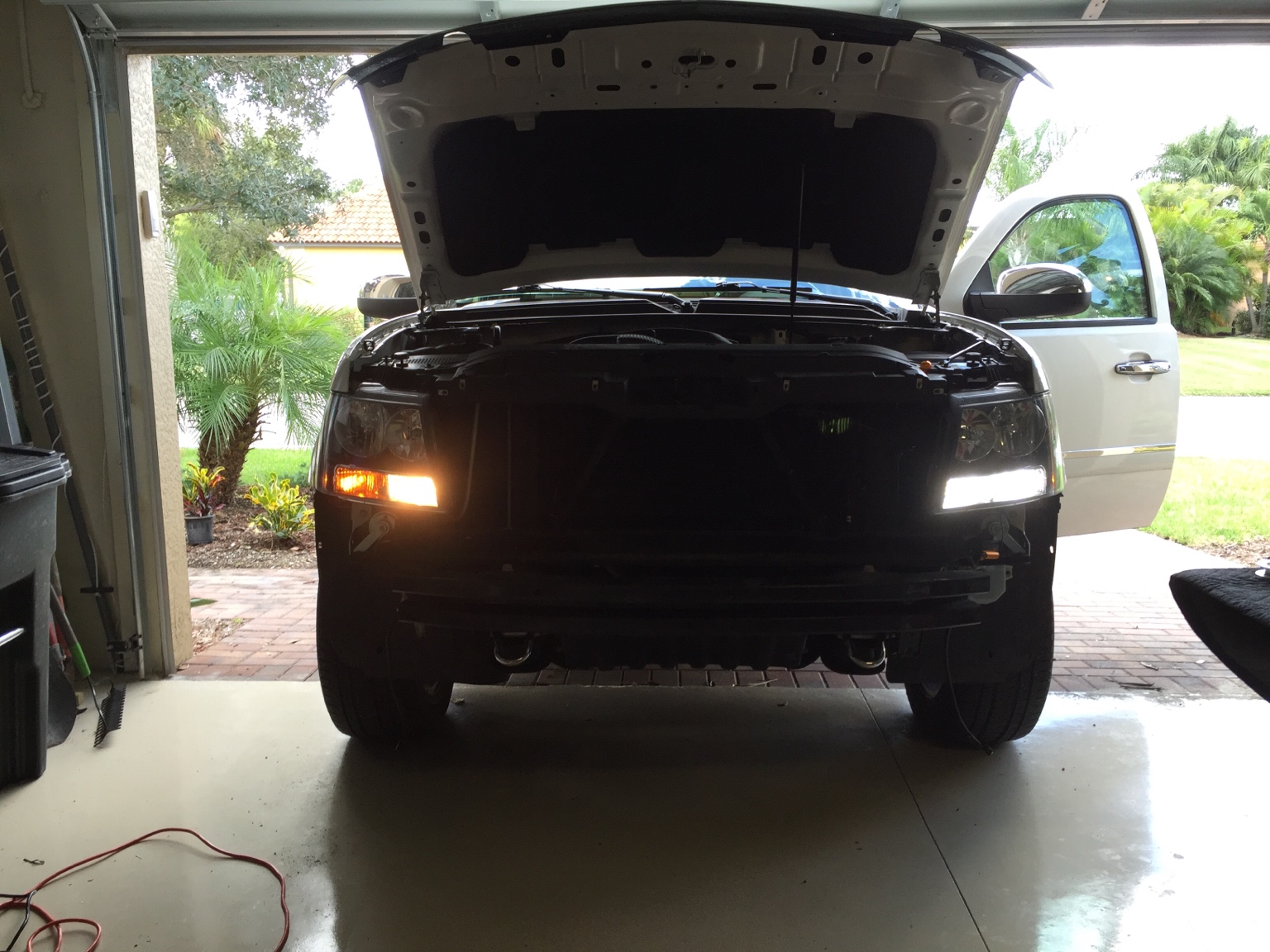

Here is a picture comparing stock to the new switchbacks. Such a great mod!
I will get a few tomorrow of the finished product w/ the matching fogs.

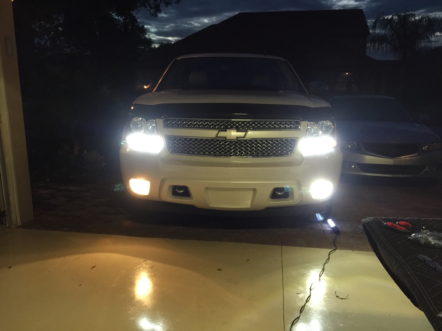

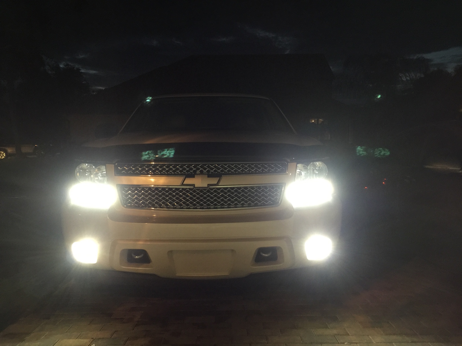

A little delayed but as promised here are a few pics. I will try to get a few more if needed they are just so bright the camera has a hard time focusing at night. I will get some day shots maybe tomorrow.
Stock fog bulb on left, new 5K VLED bulb on the right
Both VLED fogs and switchbacks
Ground beam pattern w/ switchbacks on(note headlights are not on)
Beam pattern w/ switchbacks on(head lights are not on)
