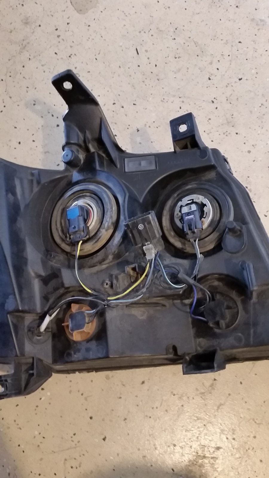

I couldn't find a clear write up on how to do this, figured I'd give it a shot.
[yt]O6OjKAc9e0o[/yt]
Parts:
--(2) Epoxy Rectifier Diodes #276-1141 By RadioShack
--(4) 3157 60SMD DUAL COLOR SWITCHBACK
--(2) Pico Light Bulb Sockets 5447PT
--(2) 50W 6ohm Load Resistors
1. Remove Headlight housing and wire harness
2. Cut the wires from the DRL bulb
3. Using a dremel tool, trim the two smaller tabs off the bulbs sockets
Normal:
After cutting tabs:

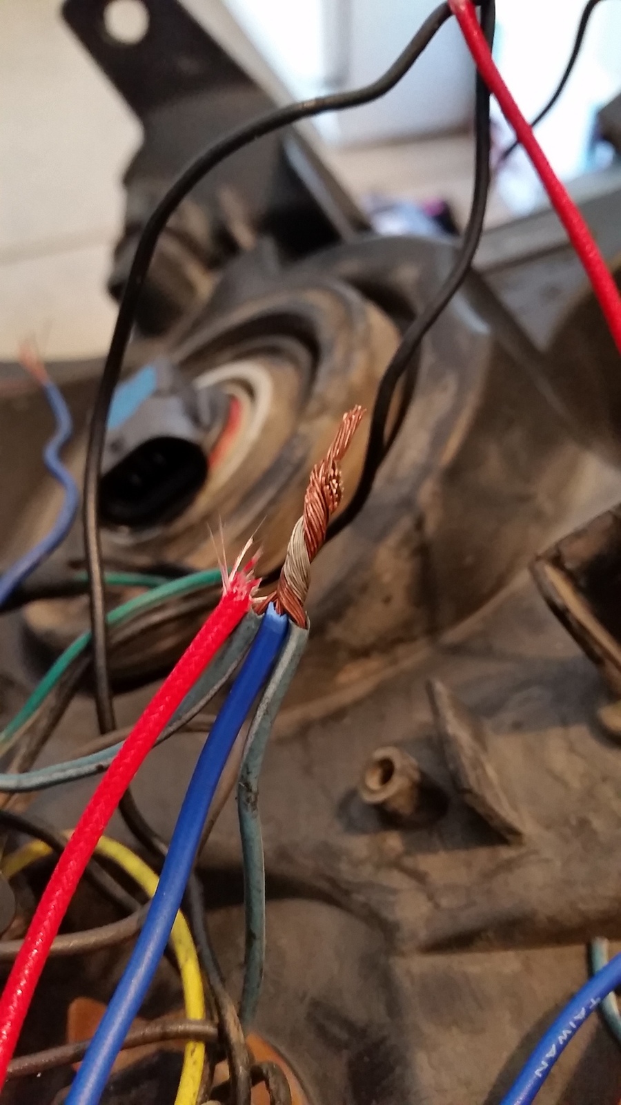

4. Wire one side of the resistor to the negative wire that was cut from the DRL and the other side it was cut from to the negative wire on the new bulb socket
5. Wire the other side of the resistor to the blue wire on the new bulb socket to the light blue wire with white stripe.

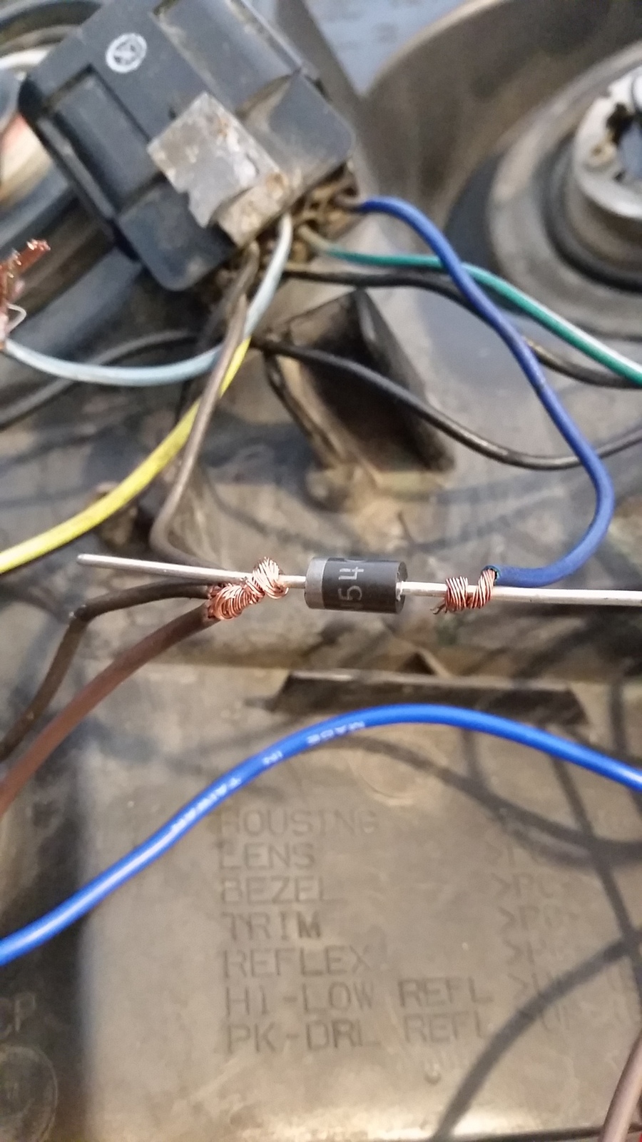

6. Wire the blue wire from the harness that connected to the old drl bulb socket to one side of the diode. Wire the other side to the brown wires on the blinker socket to the brown wire of the new bulb socket
7. Solder everything up and use heat shrink wrap to make sure nothing is touching. I put a layer of electrical tape over everything as well.
[Just realized I don't have a picture of this]
When I do my projector retrofit, I will figure out where to mount the resistor.

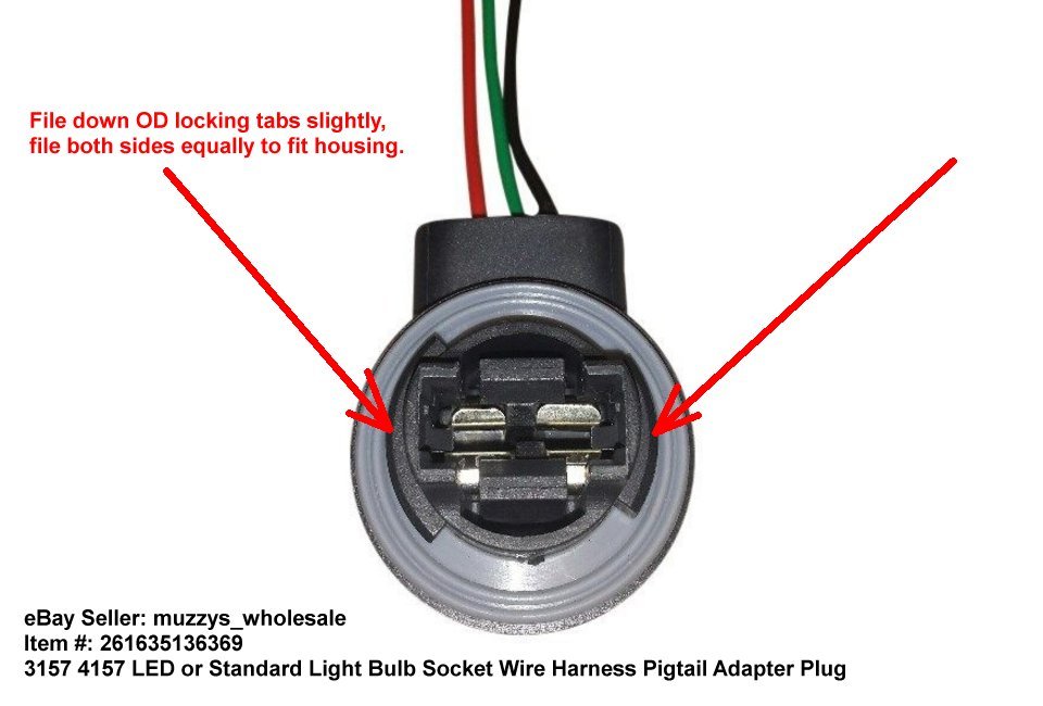

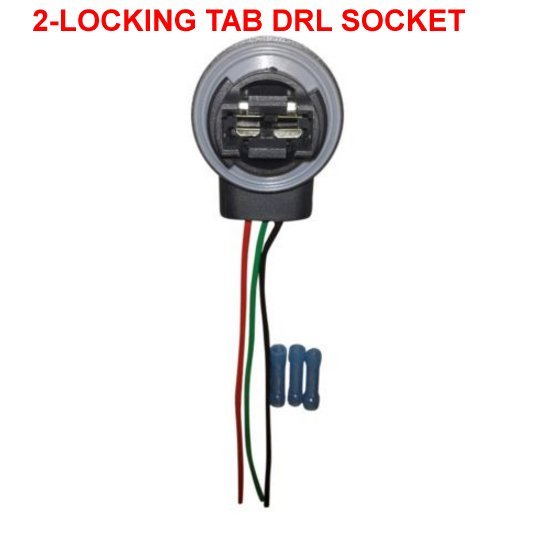

As I've gathered all the parts you've suggested, I did change one part, the DRL socket. I wasn't real fond of having just one locking tab engaged to seal the socket to the housing. I found a 3 wire that has the full locking tabs that'll fit perfectly after filing down the outside diameter of the locking tabs. The diameter is a little too big, simple hand file to knock .025 off each side and they'll fit perfect and provide a 100% seal......."BUT" this does bring about another problem, the wire color of this plug is obviously different than the one you used and that's where I'm having a little problem trying to figure it all out. I'm no electrician by any stretch, and need all the help I can get. If you can provide me with enough information I can make out a simple to follow color coded wiring diagram that would become a true DIY project and post it up here for all to use as I did notice there were a few still confused on the wiring.
Thanks again for the mod....:)

You can use process of elimination. If you have the bulbs already, plug one in and use a 9 volt and test that way first. Black is usually ground, so hold the black to negative on the battery, then try the red to positive. If it lights up white then you'll know the green wire will be the turn signal. If it lights up amber, then the opposite.

I am no electrician either... This is me just providing my .02...
The black wire on the socket you have should be the negative, I am going to say the red wire on your socket would be the blue wire on the socket I used, and the green wire on your socket would be the brown wire on the socket I used. Worst case, you would need to swap the red wire and green wire on your socket to the brown and blue sires on the socket I used.
Based on what I think you are asking, what colors from the socket you used would be the same as how I wired everything up... you would have to test my hypothesis to make sure the wire combinations line up.

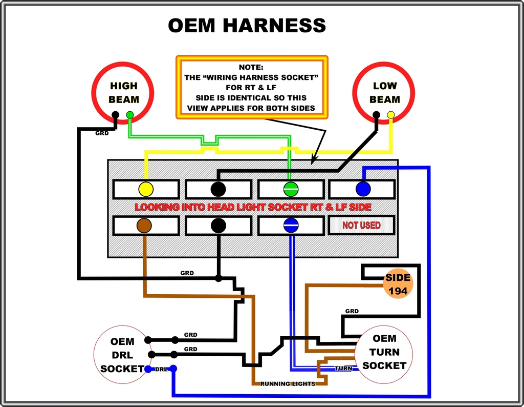

DwebPro,
With your help I'd like to detail your mod into an easy to view/understand wiring diagram, as I and another member are a little confused. As an example, I've attached the OEM wiring diagram (color correct) to start with, this diagram is for right & left side head light buckets as the harness's are the same. With your advise and help I'll add a new diagram to reflect all what you've done, cut's splice, diode etc. etc. You'll have to help me out on that as I'm a little lost on what went where in your mod.

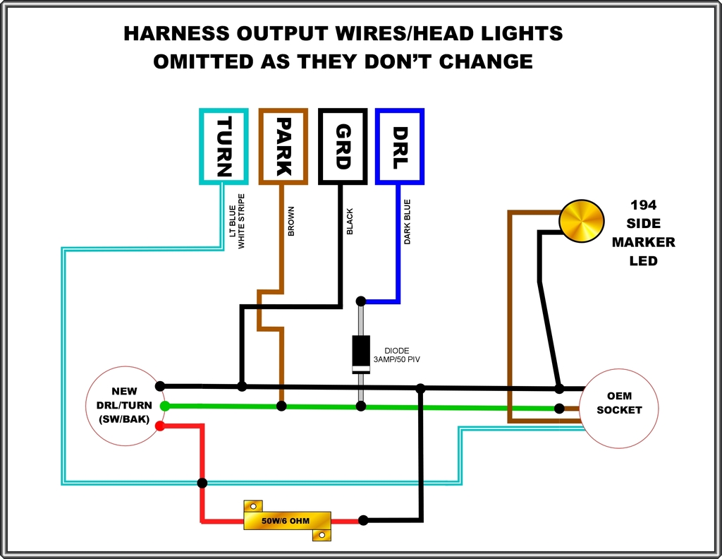

DwebPro,
I attached a picture of a diagram I created. It's pretty straight forward. The colors should match up with the stock wiring and the new 3157 plug.

Alright, pardon my ignorance but here is the OEM Harness layout:

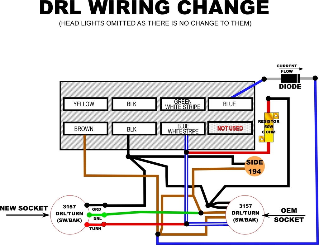

And the way I'm looking at the mod is this wiring harness (change from OEM), correct ???????

Graystone,
Thanks for the diagram, I finally had a chance to sit down by myself (in peace and quiet) and study your sketch, it now makes total sense. I think I was getting hung up on all the looping done on the OEM harness. Thanks again.
So based on your diagram, this is what I'm understanding the wiring to be, redrawn so I can envision it (for dummies) like me to understand:

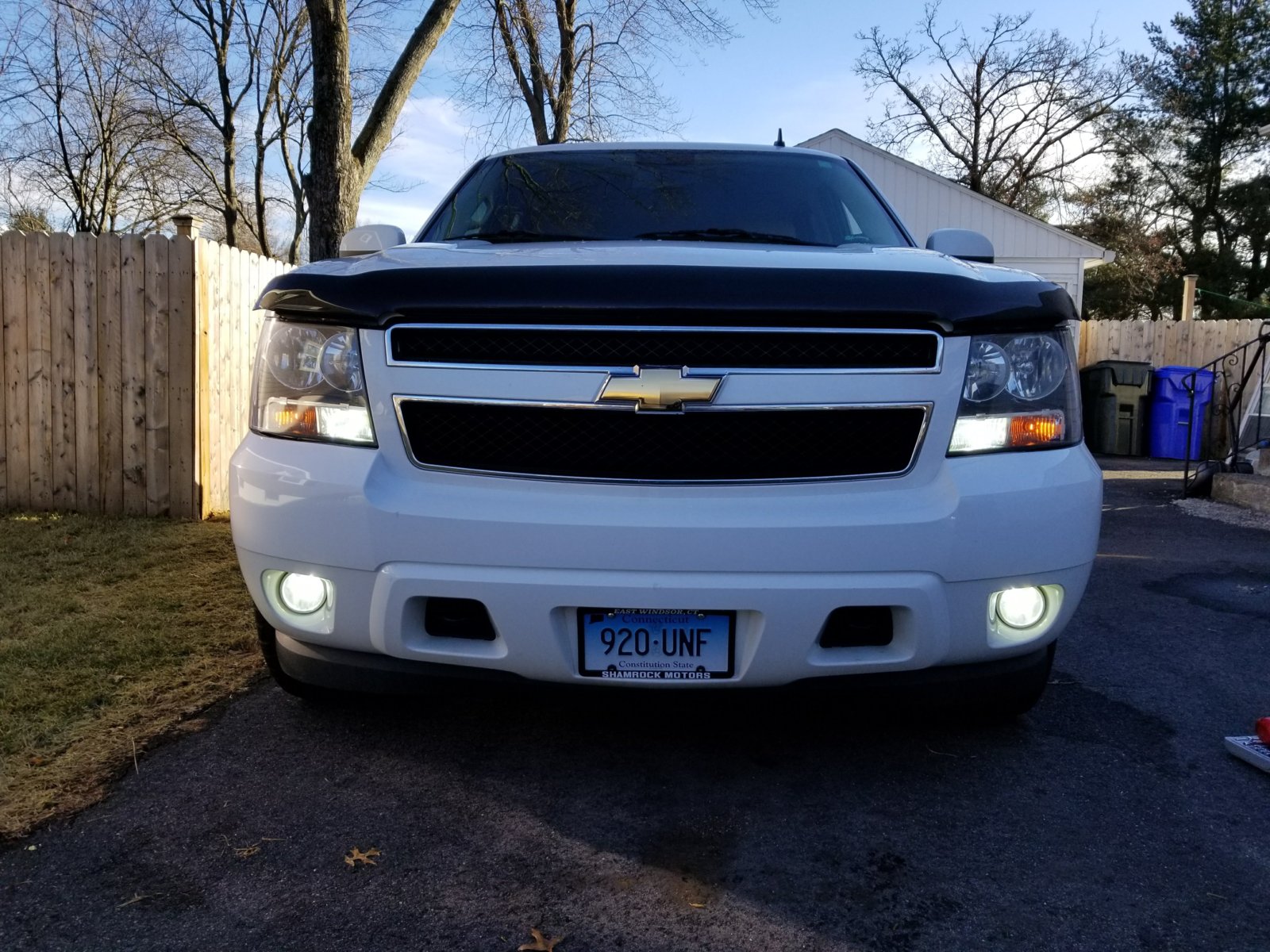

Bumping an old thread
really need to do this thanks for the write up
