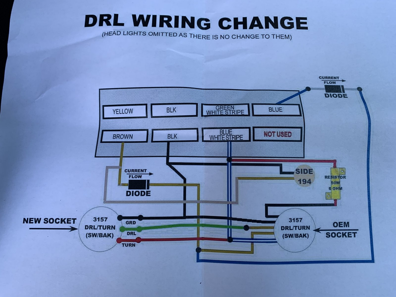

Yep missed 1 or 2 diodes... it's feeding power from the DRL circuit.
yup, added another diode to the brown park wire and connected the side marker before the diode. Works perfectly now. The wiring diagrams in this post is what i originally followed but they aren’t correct. I’ll see if i can add upload the way I wired it.

I know this is an old thread but I just picked up a 2011 burb LTZ and I swapped out the oem hazed headlights for spyders. Well I'm removing the sypders as they don't have a flash to pass feature. I decided to open up the stock housings and retrofit them and I'm doing the LED DRL/Turn signal mod now. Instead of hacking up the stock headlight harness I purchased some cheap ones off amazon and got to work last night using the latest diagram in this post #105. My issue is when I started the harness mods the amazon harness had the pinouts wrong on both headlamp plugs. The pins for the grounds were reversed as well as 2 other pins for the Turn signals (DRL and Turn were reversed). I depinned and swapped everything to stock via the diagram but just wanted to make sure I didn't just screw this up more. I won't be able to test till probably the weekend when I'm able to remove the spyders and swap these in. I'm holding off on doing the other harness till I make sure this one is correct. I went with the auxito switchbacks with internal canbus and resistor in the hopes of not needing external resistors. I'm also running 10A 1000V Rectifier Diodes in the hope they don't get as hot and can handle the stock bulb resistance if the Auxito LEDs resistance is true to a stock bulb.
