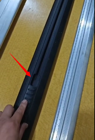

Hi, guys! why one of my bar with a bigger slot in the middle?and the strip is cutted in half.But another bar is ok,without bigger slot,and the strip is whole

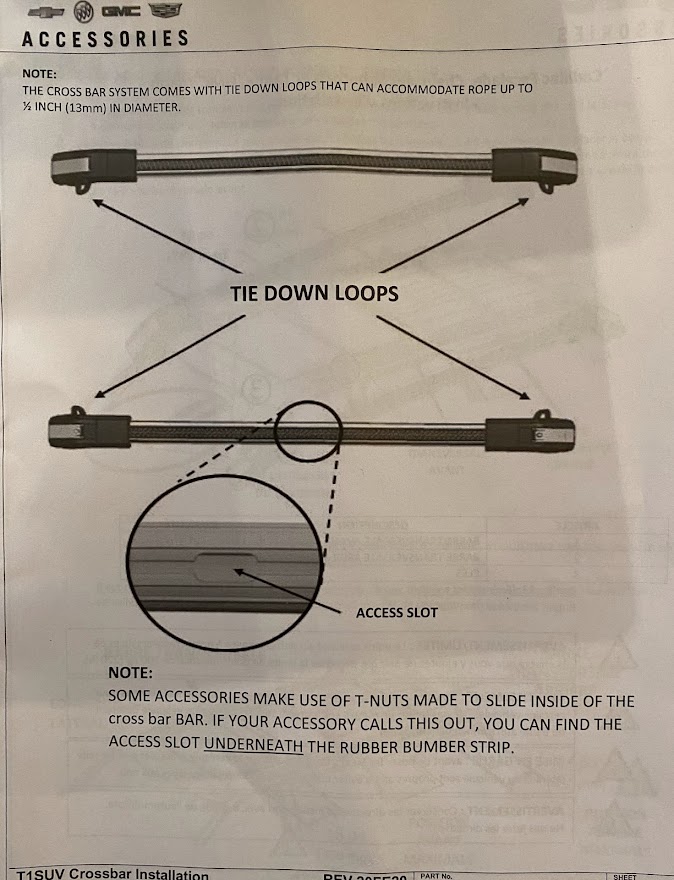

This is what I found in the installation instructions. They call it an Access Slot for accessories to slide into it.

Thank you very much,Which bar is install on front?has bigger slot one?In fact, will you use the access solt?thank you again.
