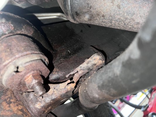

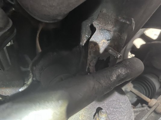

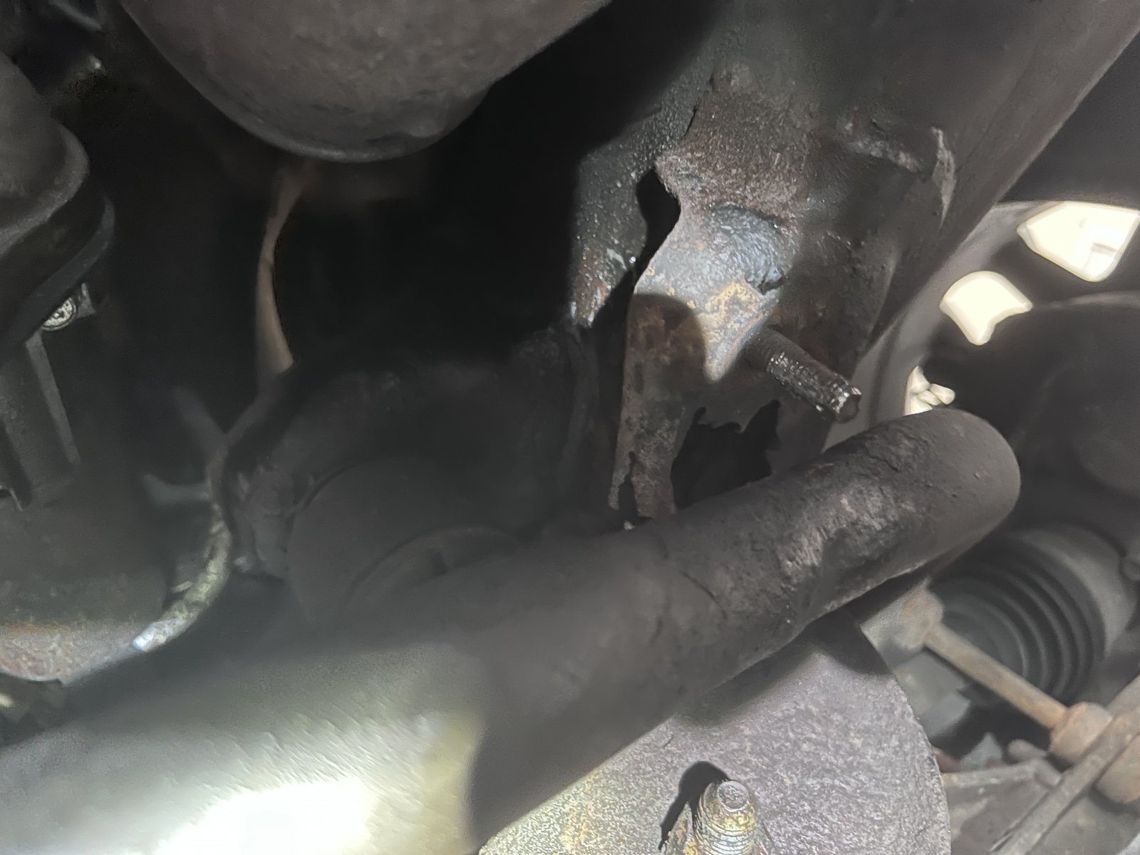

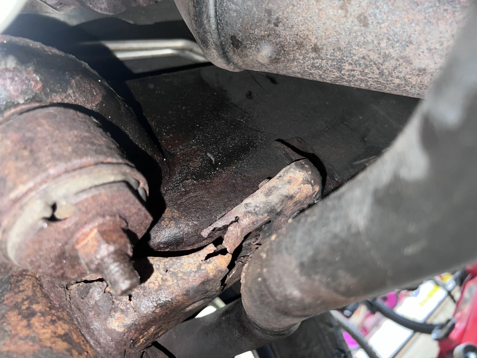

Noticed my sway bar bushing bolt was broken, ordered new ones.
Unable to get old one out so far since it’s melted in there, but also noticed the frame piece for attaching bushing is basically rotten out in the middle.
The holes for bolts are still there and other side is fine, however I’m worried it can break the bolt area as well in future.
Is this salvageable in any way at all or at this point drive until it falls apart then have to cut and weld a new piece onto it?
Or maybe any other way to install sway bar bushings to hold it in place?

well, providing if the rest of the vehicle is not a moving death trap then at the very least those mounts need to be cut out and replaced and the sway bar is done, throw it away and get a new one. it's been eaten away by the rust monster
Rest is fine, everything around is fat and solid, just one side of the area around that bushing, probably water got stuck and was pooling in that hole.
Checked car market to see if it’s in better state than 1-2yrs ago, Looks like time to get a welder!

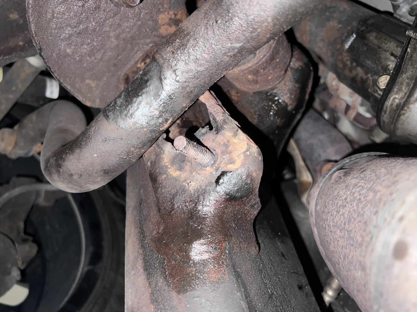

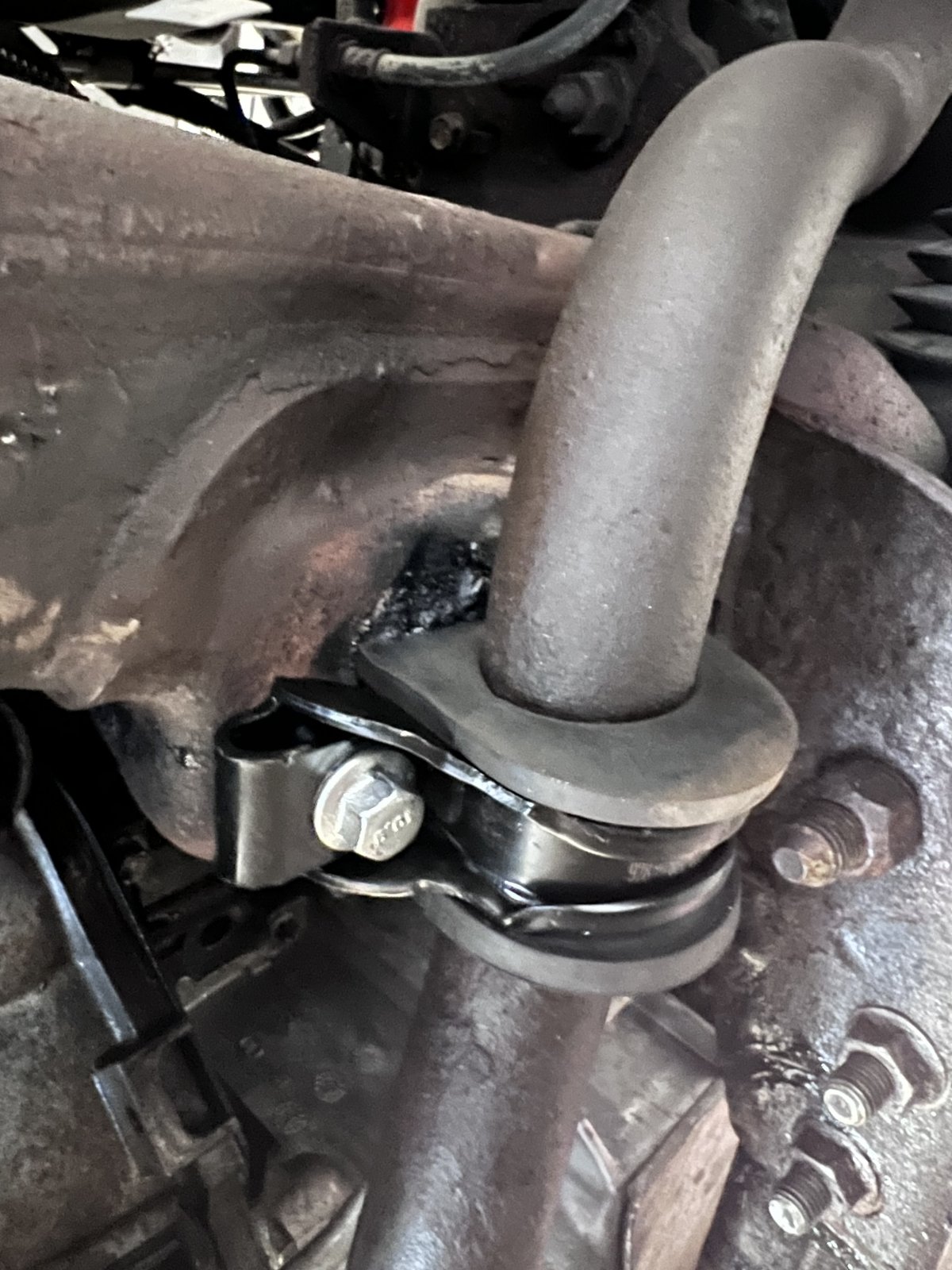

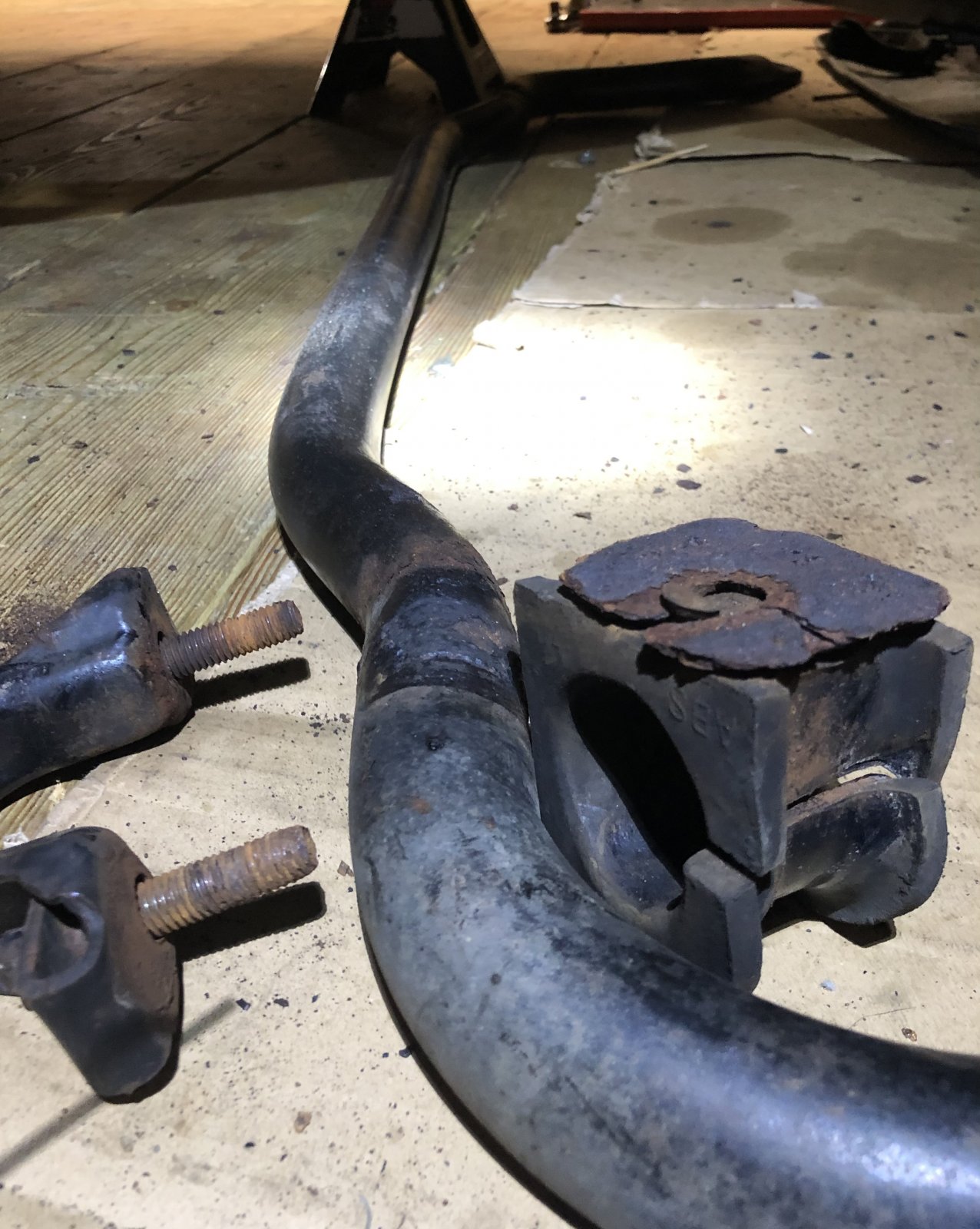

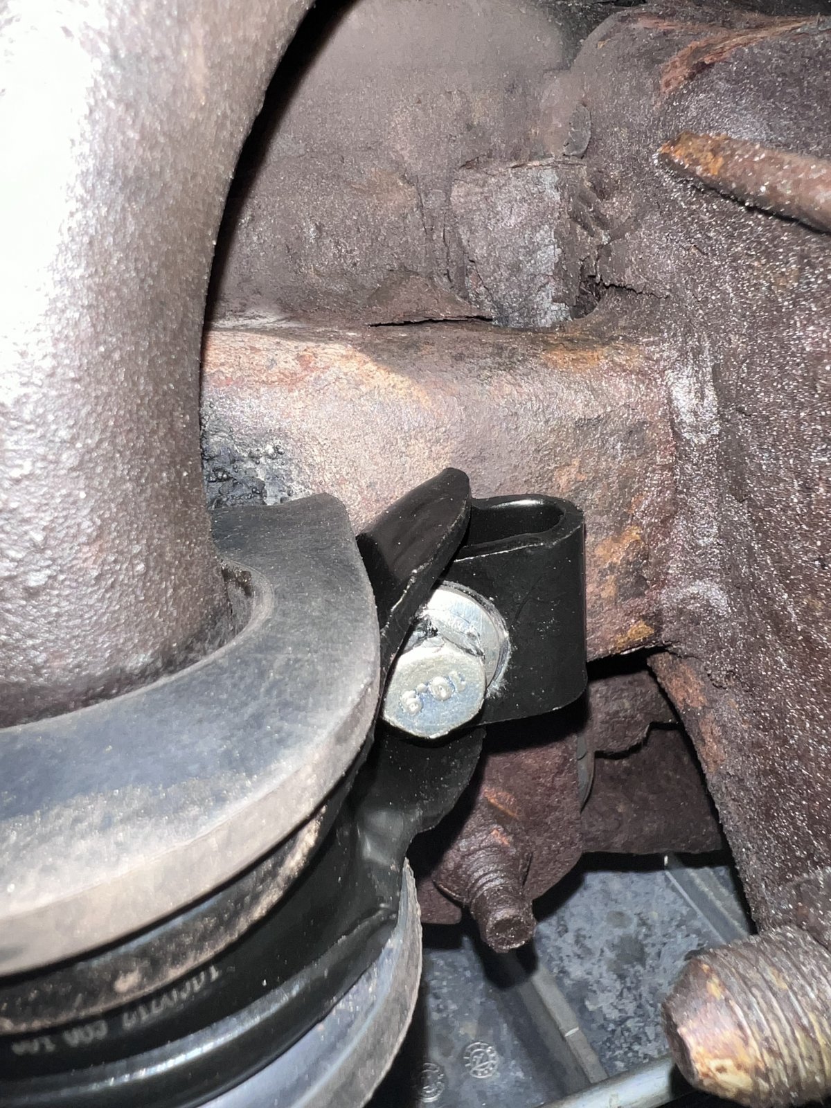

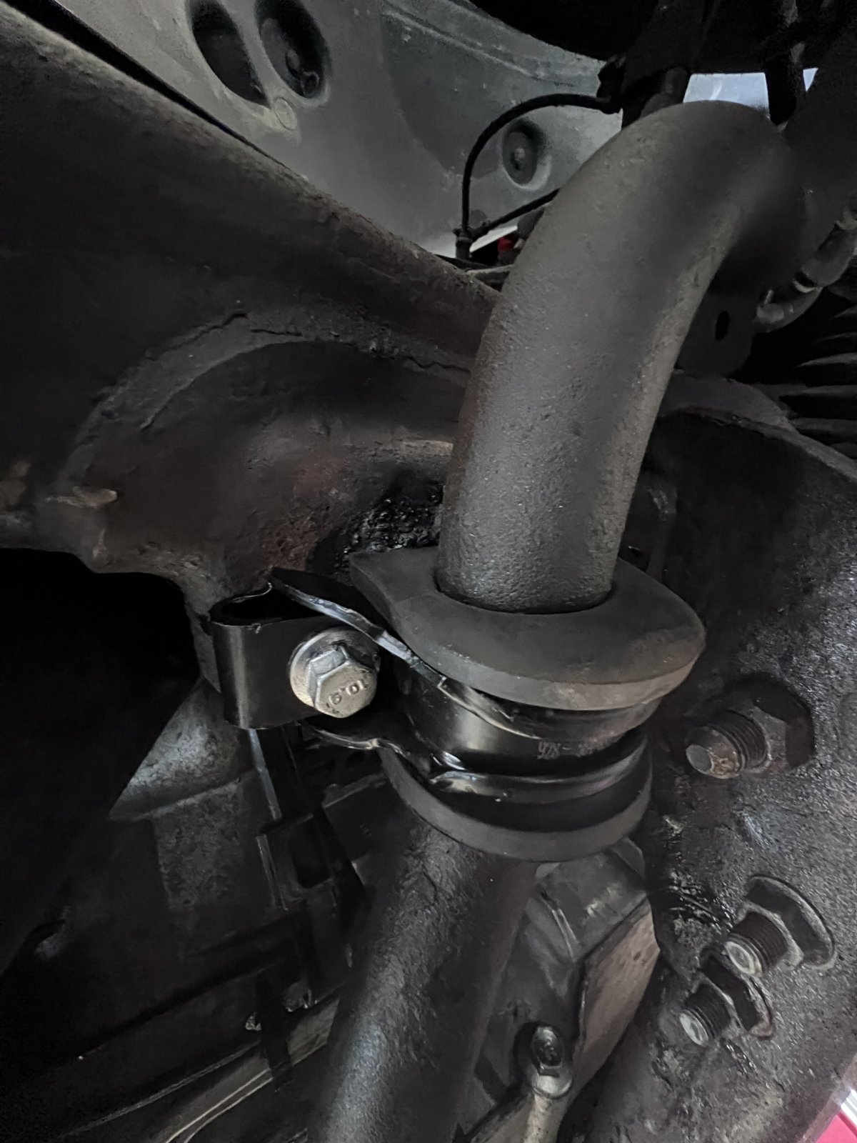

Anyways, here’s the results.
Took me hours to get bolt out, it was melted inside.
Welded until it break apart, then drilled and tapped for hours.
Once it was out, cleaned area and temporarily welded sheet metal piece where it was rotten out and painted with rust remover.

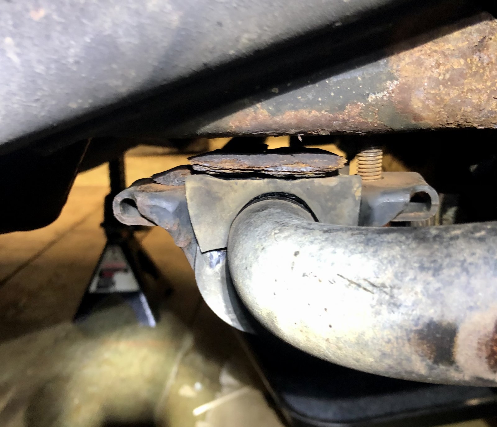

Yesir! Same here. I snapped the rear bolt off and fought like hell for a couple days to get it removed. Broke a couple different bits and removers in addition to tons of soaking, heating and cooling.
