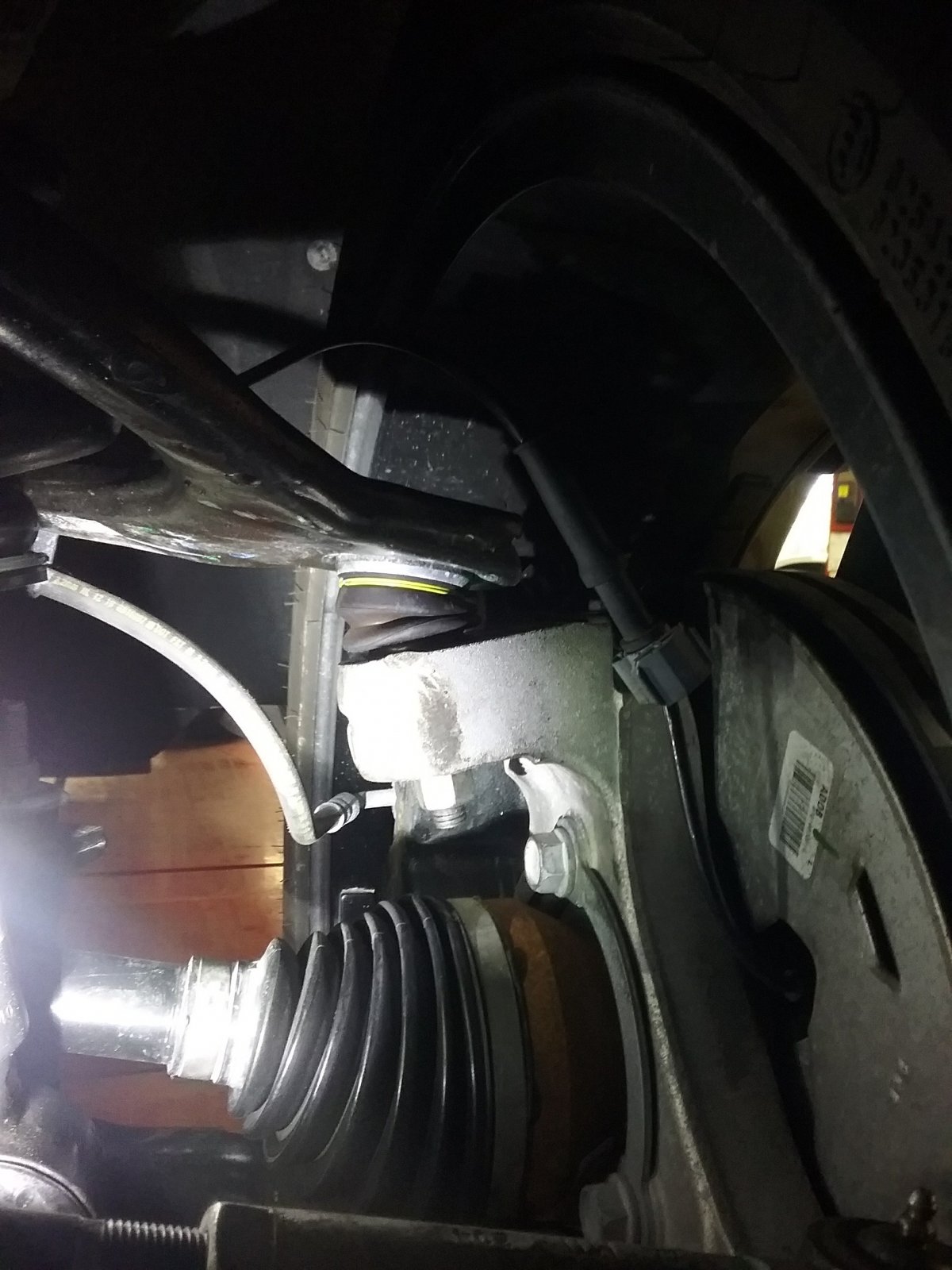

in for the pics...really debating level/lifting the wifes 17, i would like to see front ball joint angles if possible.
just level ground and wheels can be turned.

I’m going to install my rear spacer (1.5) with the shock extension tomorrow. I’ll take pics of the front ball joint

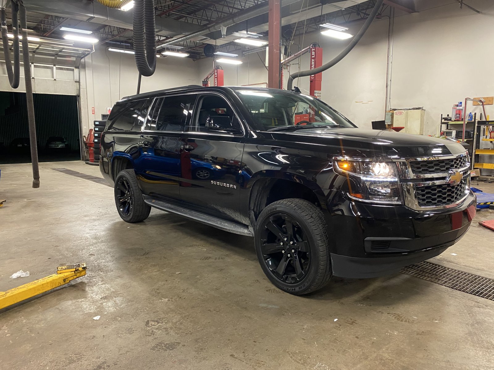

Here’s the complete 2.5 inch front, 1.5 rear spacer set up with 1.5 shock extension.
I took pics of the ball joint but it’s on my other tablet. I’ll upload it tomorrow. Now I need to do a alignment.
I did a small half hour road test. Everything is fine, rides just like stock.

thank you...the height is what i am looking for, but this does indeed tell ME, that i want replacement upper arms.
i do recall on my 2011 Tahoe, after level and alignment, the steering feel was slightly tarty until i did upper arms.
