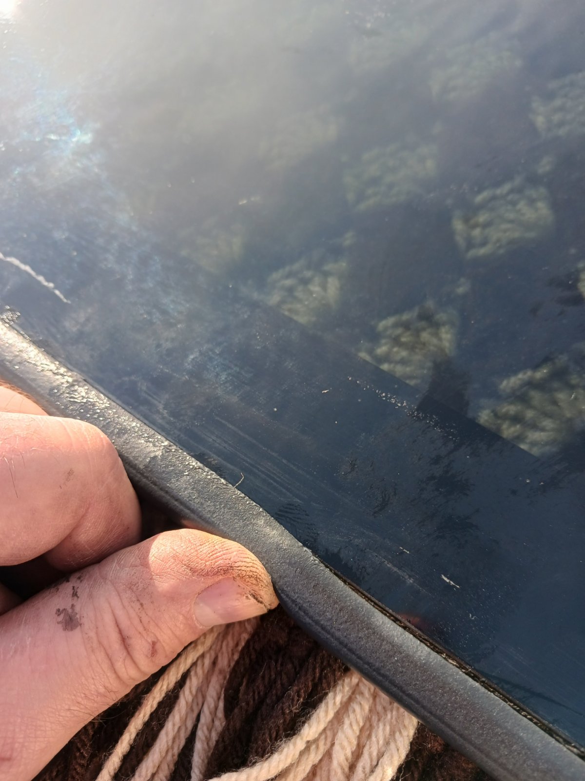

Unfortunately, I have early signs of the glass permanent seal chipped off. No idea how:

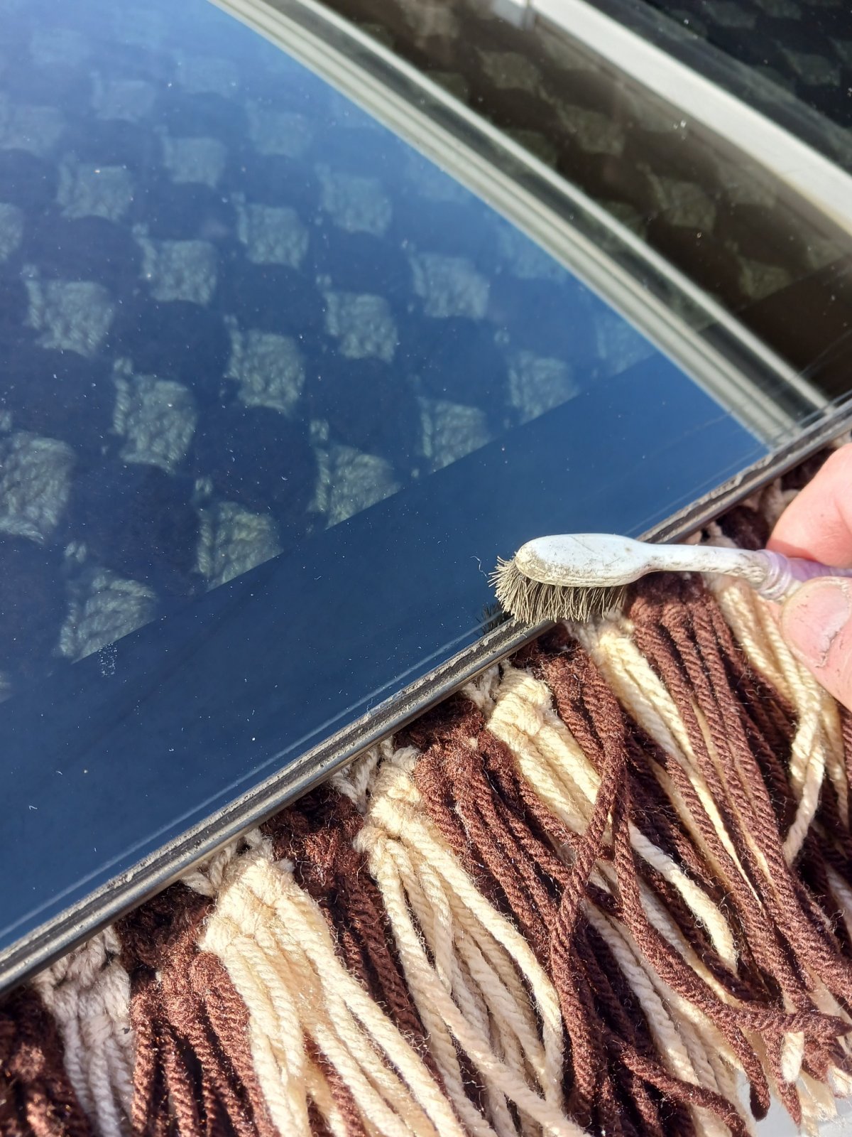

Start applying new seal from the glass outside. Silicone spray helps to slide it over the mating edge.

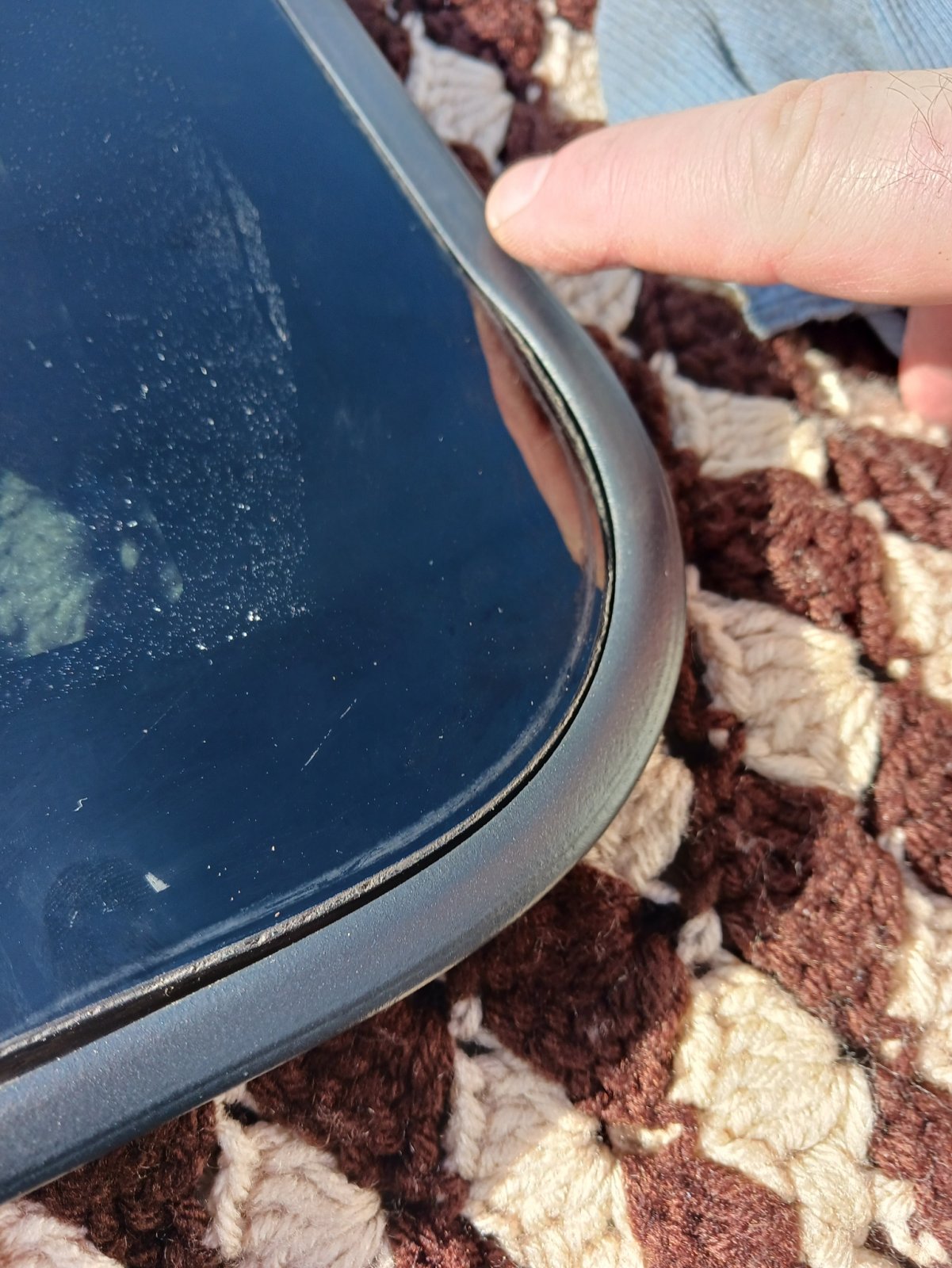

Now, you can see how the new seal does not completely overlap the glass, as it should:
So flip glass outside surface out and, I used my thumb to drive seal all the way onto the glass. Took several complete rounds like this around the entire seal. It gently pops where it should.

Just wanted to update this, I cleaned the absolute heck out of my gasket and under it as well as in the groove. Applied some WD-40 silicone to a rag and wiped the entire gasket and then re-adjusted the heights of my sunroof. One rainstorm and 1 pressurized car wash later "knock on wood" no leaks so far. I'm hoping that it will hold up over time lol
