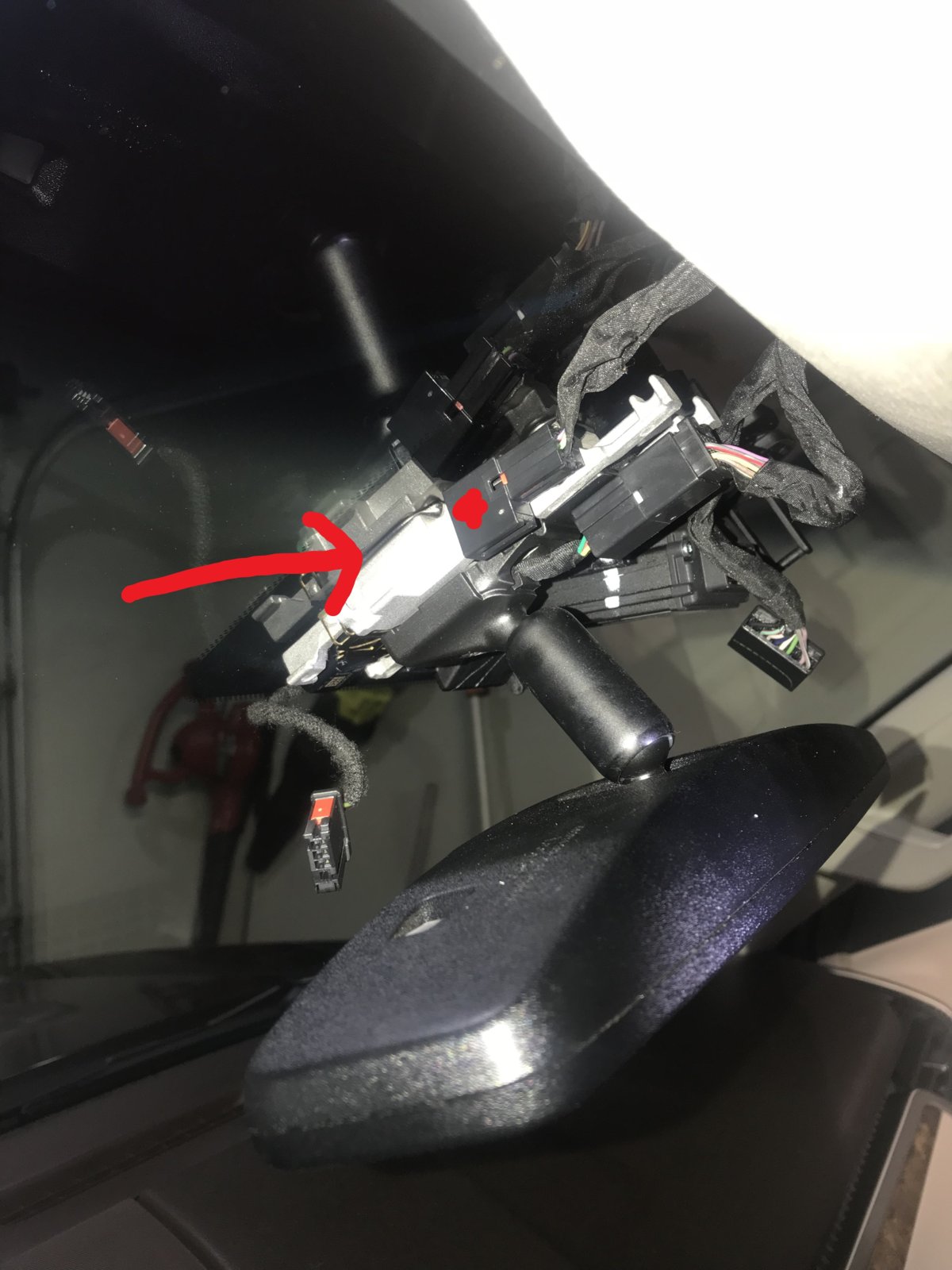

Thanks for the suggestions, as i am out of warranty and cannot listen to dealership BS I went into this myself, I downloaded the schematics from www.bbbind.com. Excellent site have all the diagrams of most cars and TSB announcements.
I traced my sunroof switch all the way back to the fuse in drivers panel, it was a 10A called RAP SEO. Swapped the fuse and bang it blew again.
So i then traced this line back to the front windshield behind the plastic cover behind the mirror, and then bingo in dawned on me, i had a new windshield replaced a month earlier and never thought of checking the sunroof.
I started removing cables and when i got to this device marked A and unplugged it the fuse didn't blow.
Now what is this strange device in picture one because the weird part was, the rain sensor works, the Adaptive cruise control works, now what really pisses me off I then plug everything back in as its getting late and the fuse didn't blow.
so i am searching google. I hope this may help folks in the future

It may be part of the sensor for the compass. Rainsense works? Just confirming. Is it possible that the connectors we're missing-aligned somehow and you corrected it? Moisture on the pins?

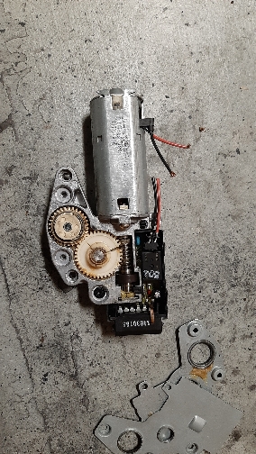

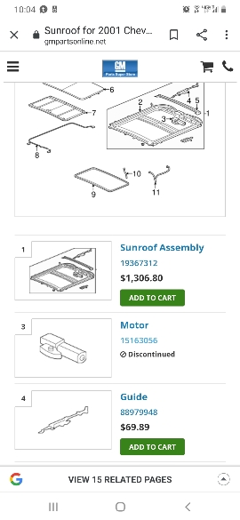

15163056 is the acdelco part number
i would assume most all in junkyard have same problem. more of gm's famous plastic gears.
wonder if perhaps somebody sells the gears?
Sent from my SM-A505U using Tapatalk
30,746
48,428
I may have to call back junkyard and see if there are anymore sunroofs.
I wouldn't assume just because a car is in the junkyard that the sunroof motor's are all bad, it is the most common failure but some people never even open the sunroof so plenty of good motors out there.
the motor should be the same for denali, escalade, or any with a sunroof
