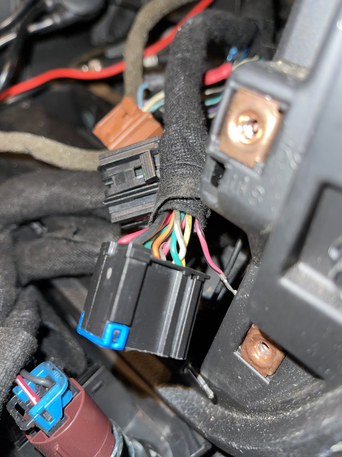

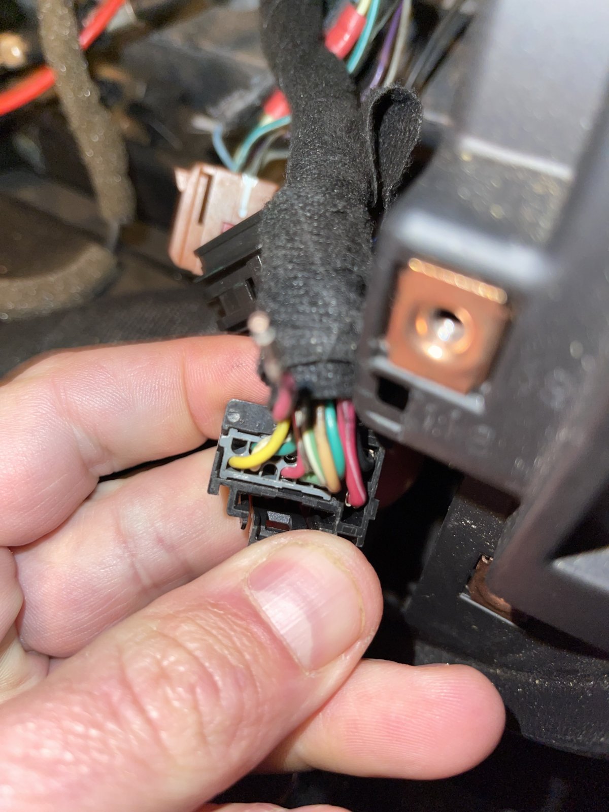

I decided to tackle this project this weekend, but for the life of me I can't figure out what they did to kill the radio. The only thing I've been able to find is a small red/black stripe wire that looks like it was pulled out of the 14 pin connector behind the radio and taped up to the loom. The constant power is good in the connector.

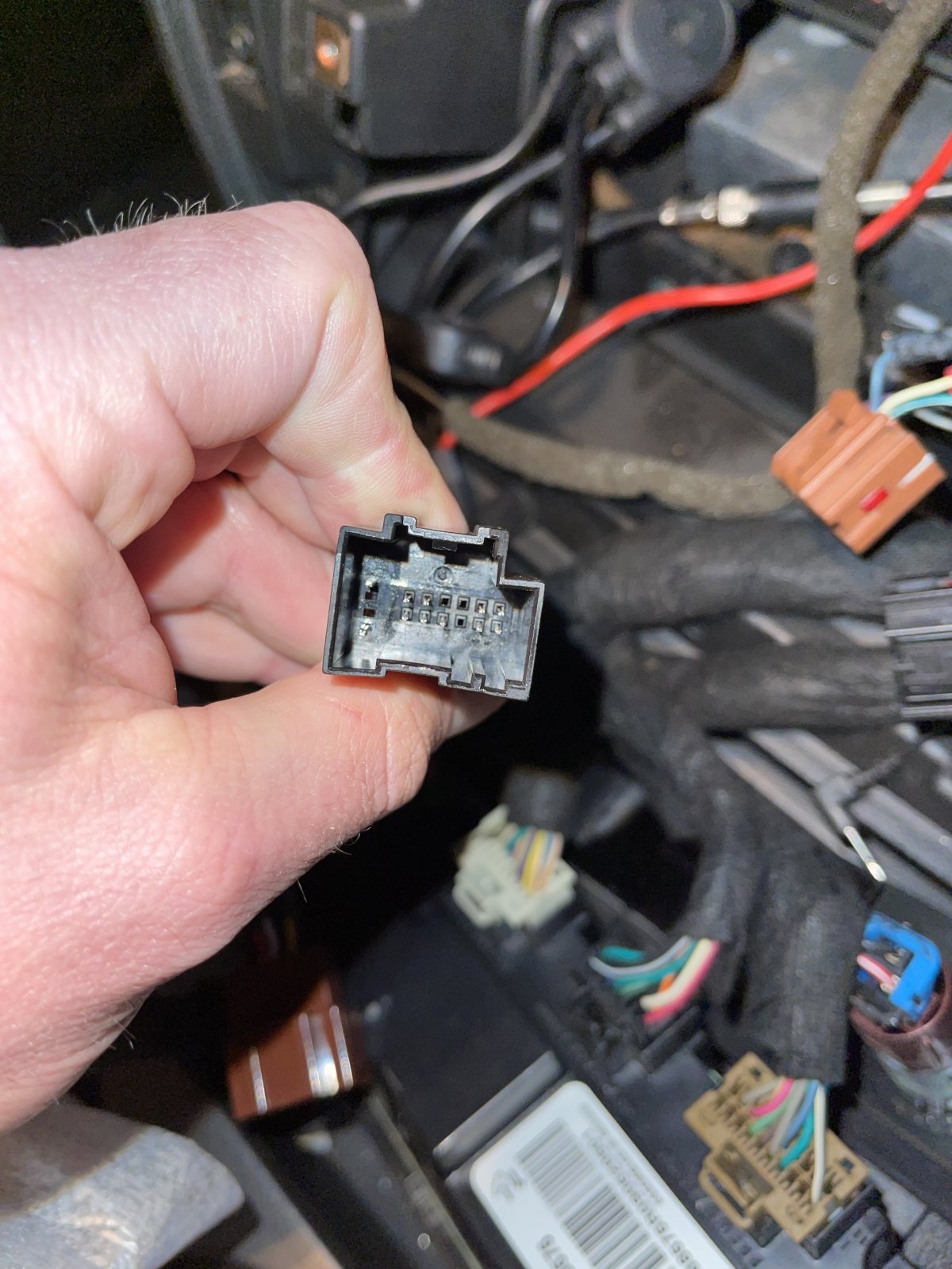

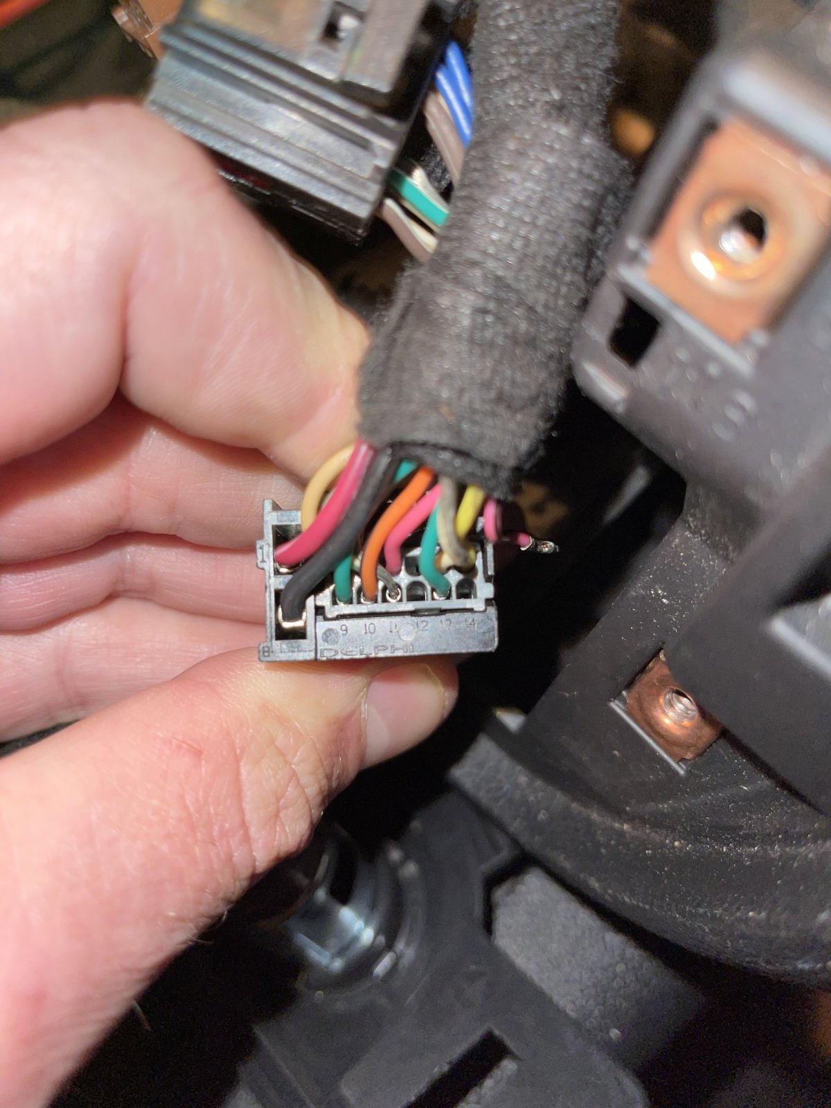

Are you sure it's red/blk or is it really pink/blk? If pink/blk it is pin 5 in the 14 pin connector. There is no red/blk on mine (w/o Y91 w/ UQA). If so, the pink/blk is the low ref. Maybe hook up your new setup and see if pin 5 mates with anything in the GM5+ harness kit. If you still have problems, IDatalink Maestro has a great online tech support website. My two times calling in I first got 5 star tech support and the second time got someone who really didn't want to answer questions on the weekend.

I suppose it is pink/black. The wires are kind of faded, but after taking a pic with my phone and the flash on it looks more pink now. It doesn't appear to mate to anything in the GM5+ harness though on pin 5. Pins 5, 12, and 14 are empty with the pink/black not inserted on the vehicle connector and pins 4, 5, and 12 are empty on the GM5+ connector

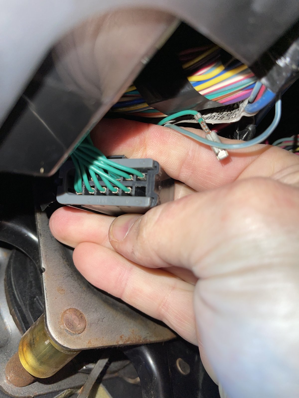

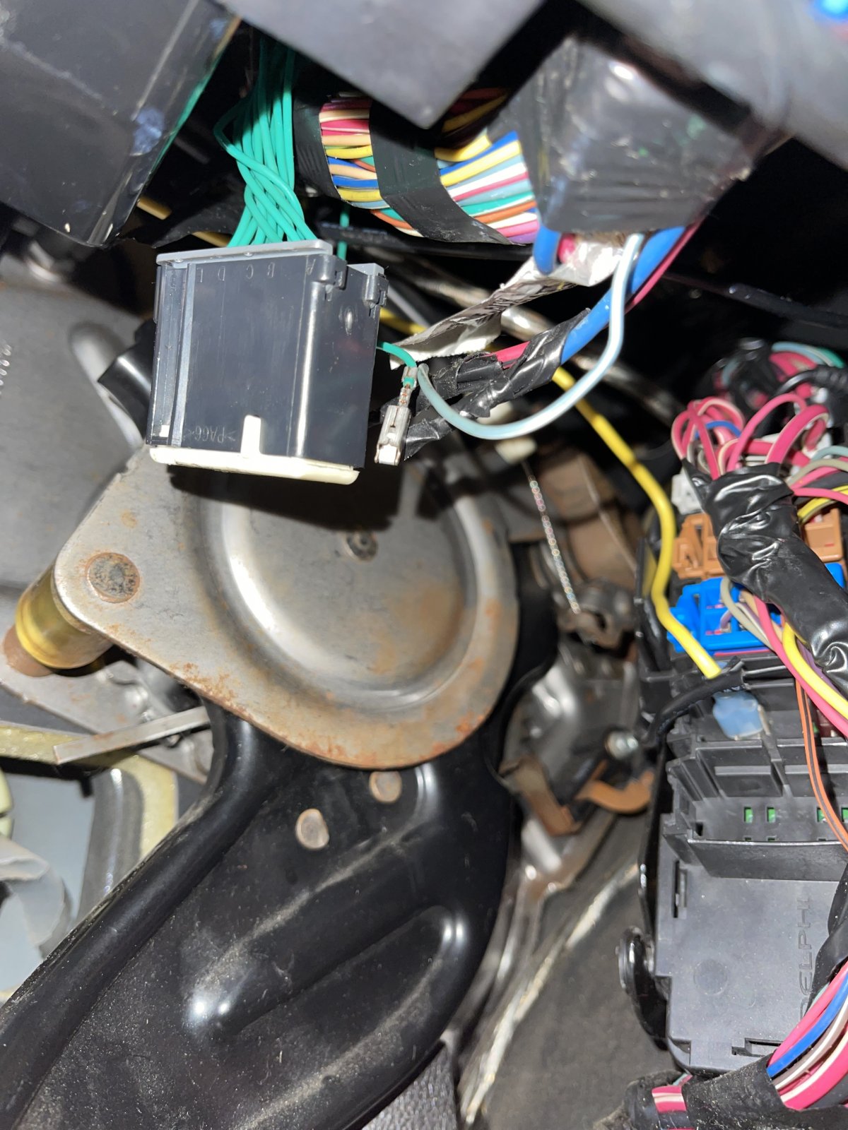

I also found this connector/plug/junction under the driver's side dash. It has all green wires and the white plug in the connector appears to just be connecting all pins together. There is one green wire that appears to have been removed and was just hanging free air.
I've started a new thread related to this plug for more visibility.
