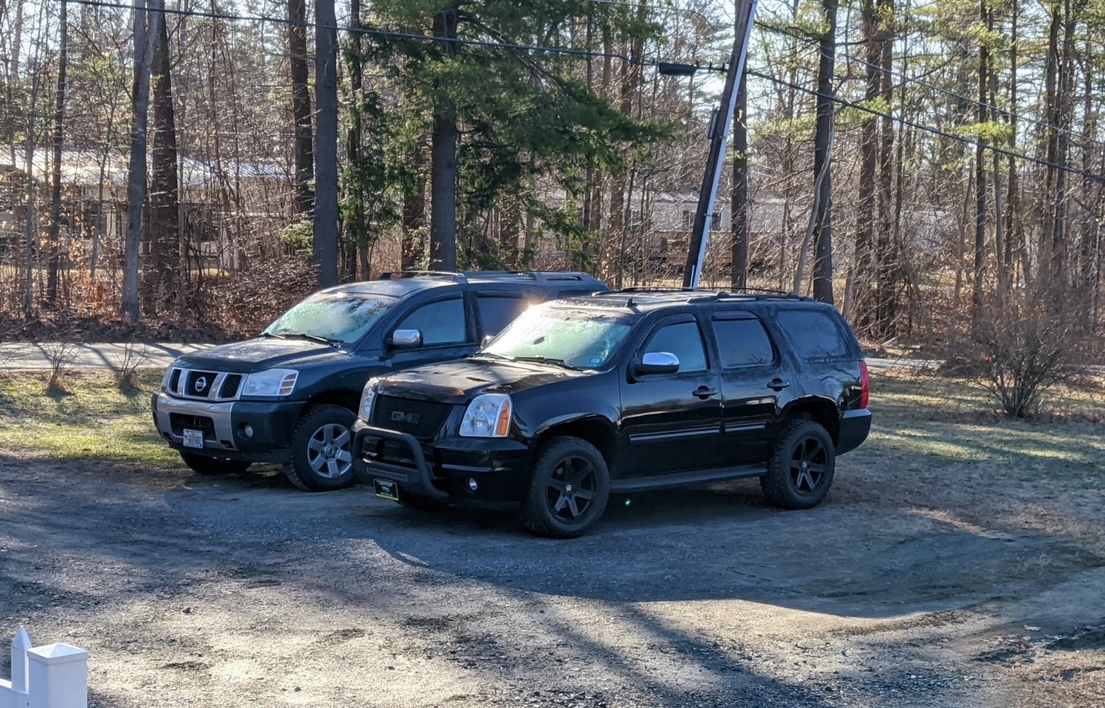

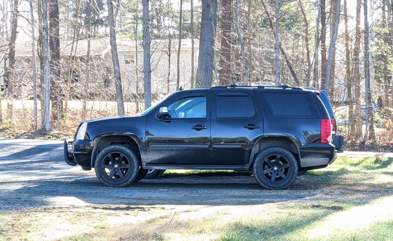

33" tires should work fine. I had some 33" K02s on my Yukon with no front lift/leveling kit when I first got it. But they were on 20" Black Rhino wheels, so the offset probable changed. My winter wheels also have 33" tires, but are also not GM wheels, and fit fine with no rubbing.
I did have to trim my Husky mudflaps on the inner corners, but that was easy.

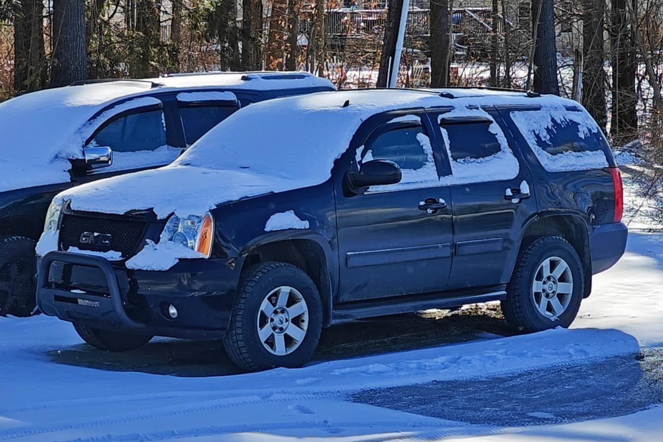

@KevOLTZ : Before/after leveling kit w/33" KO2s

I have 18" winter wheels with the 33" snow tires tires, and they don't rub anything. The caveat is that they are Nissan Armada/Titan wheels (great cheap alternative with identical hub bore & bolt pattern) which may have a slight difference in offset than GM wheels, but it certainly doesn't look like much at all.
