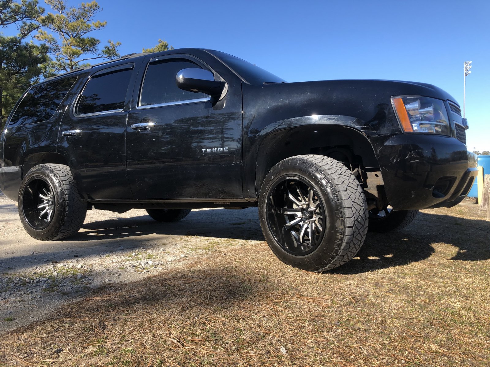

Biggest I could clear with a 3” lift was 20x12s with 33/12.50 ridge grapplers
I could clear 35s on stock wheels

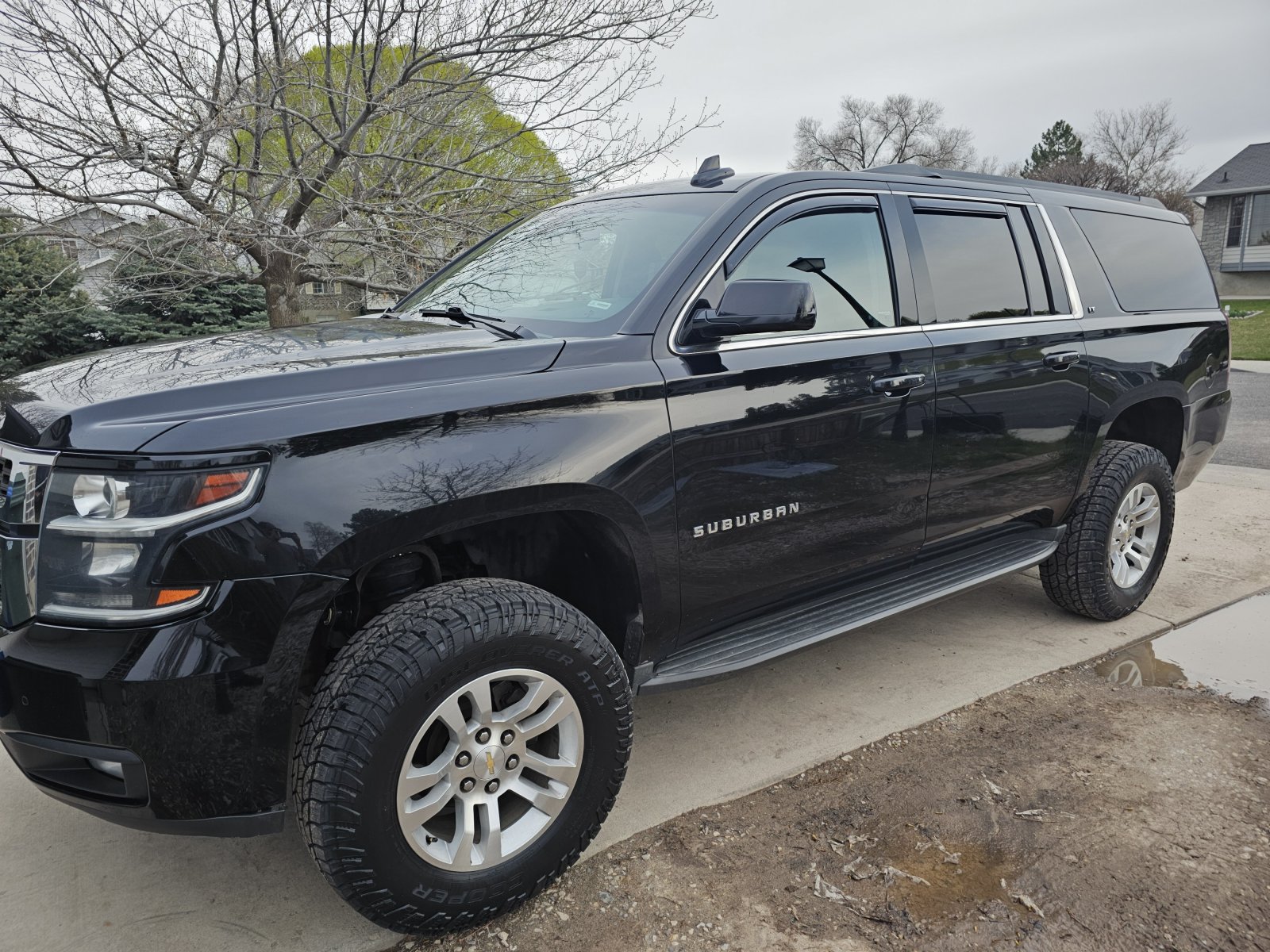

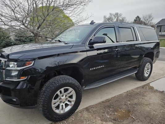

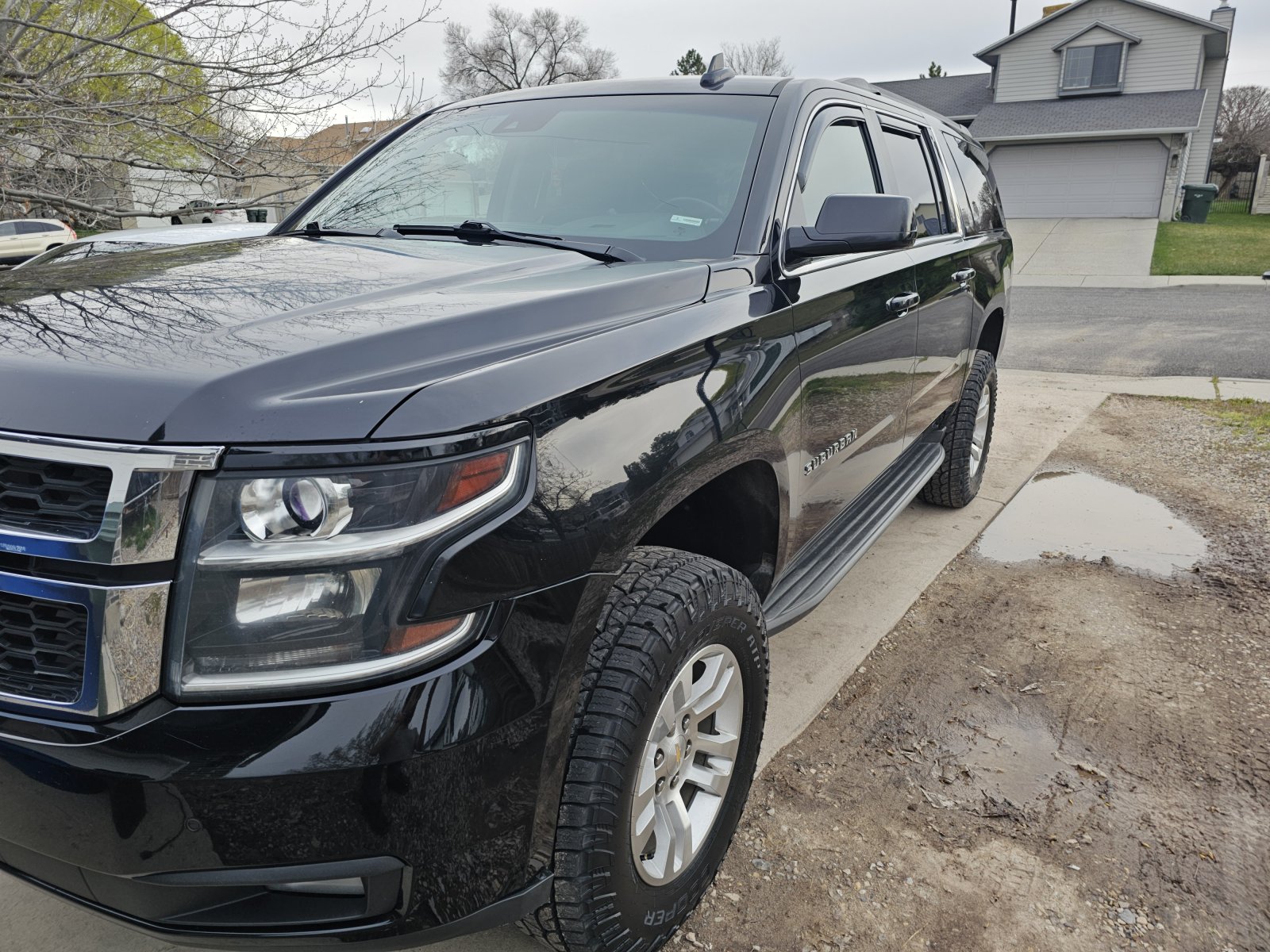

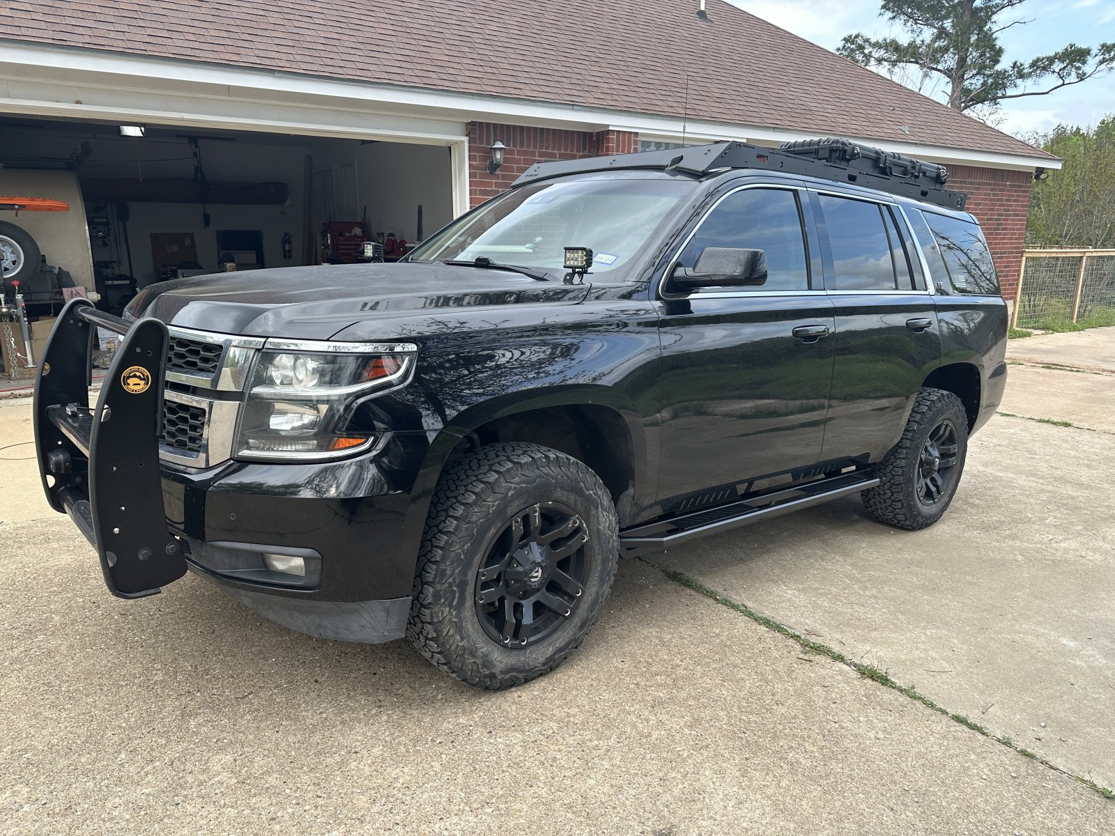

Here it is! LT175/70 r18 tires with 1.25" spacers all around on the stock wheels to give it a little more aggressive look and to keep the tires from rubbing on the new uca's
