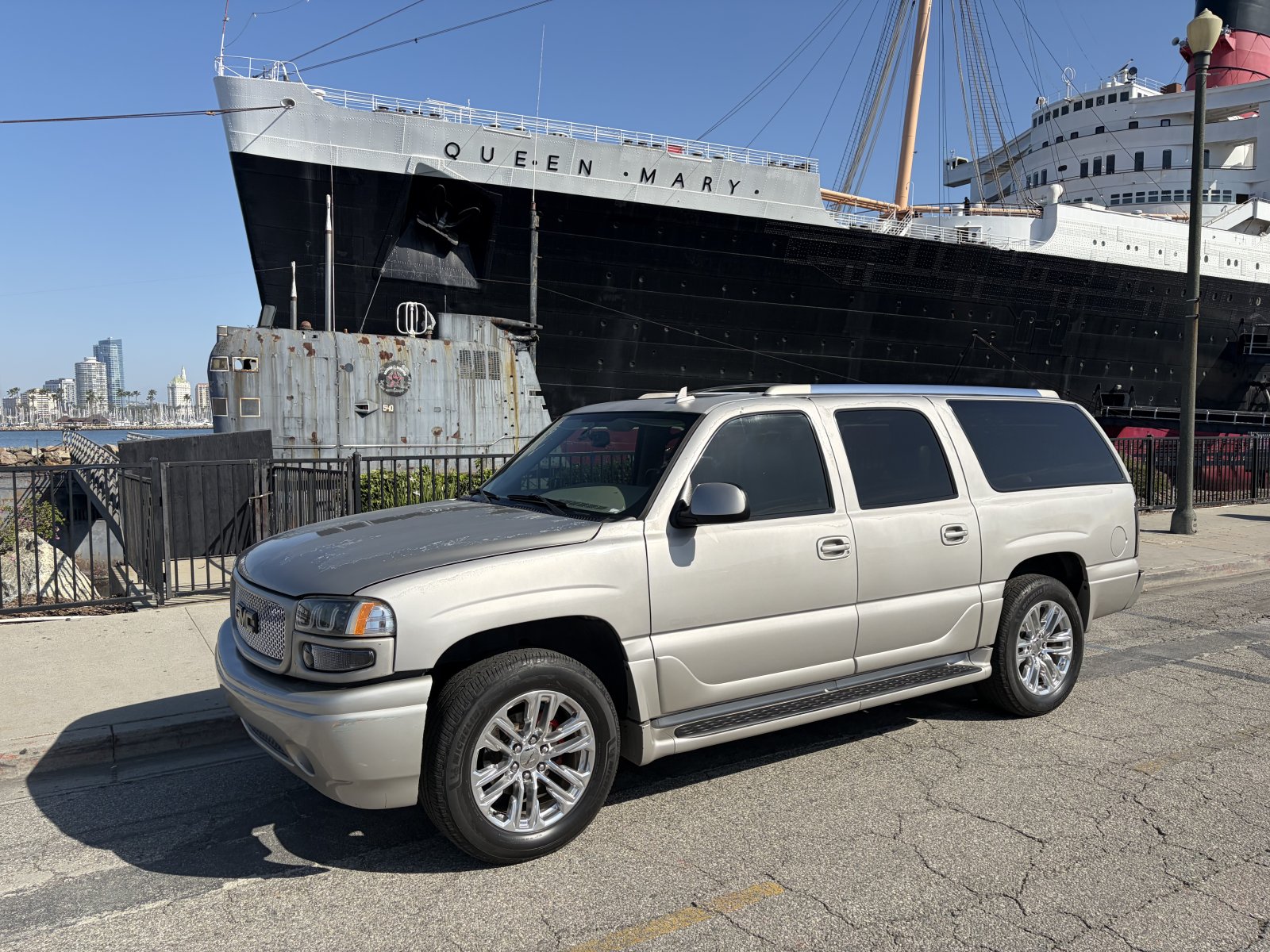

OEM take off wheels are a dime a dozen on FB market place. That’s how I scored the almost brand new 2021 take off a may of 2021. Polished aluminum face wheels with no chrome plating to peel off. Lots of panted aluminum wheels from GM as well. Everything from 2025 models and back will for your 2013. Here’s a photo of my rig with the 2021 take offs I roll on.
