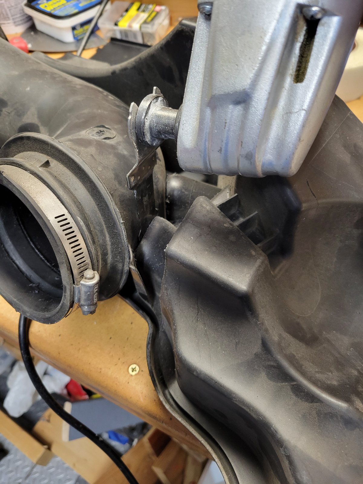

This is what I came up with. I cut slots between the chambers and the main intake tube to push in some custom cut blockoff plates:

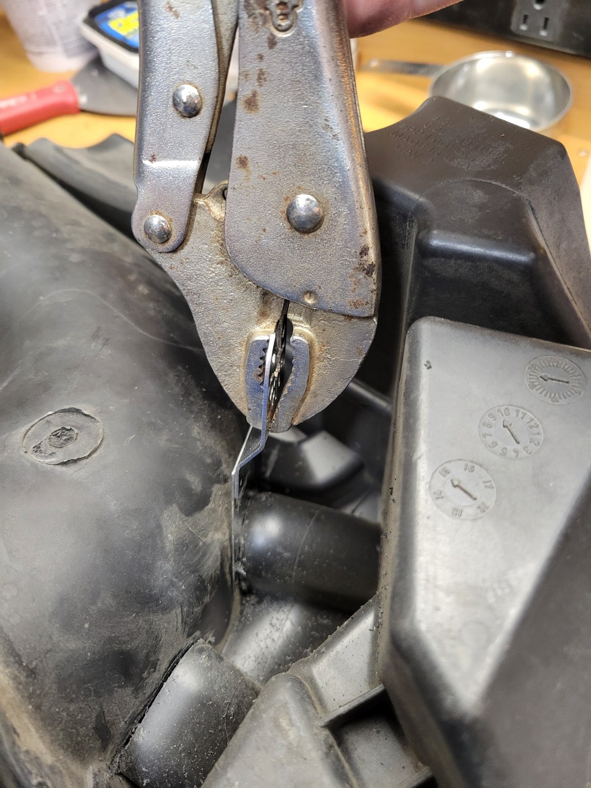

for when the oscillating saw couldn't reach far enough, this got me the rest of the way:

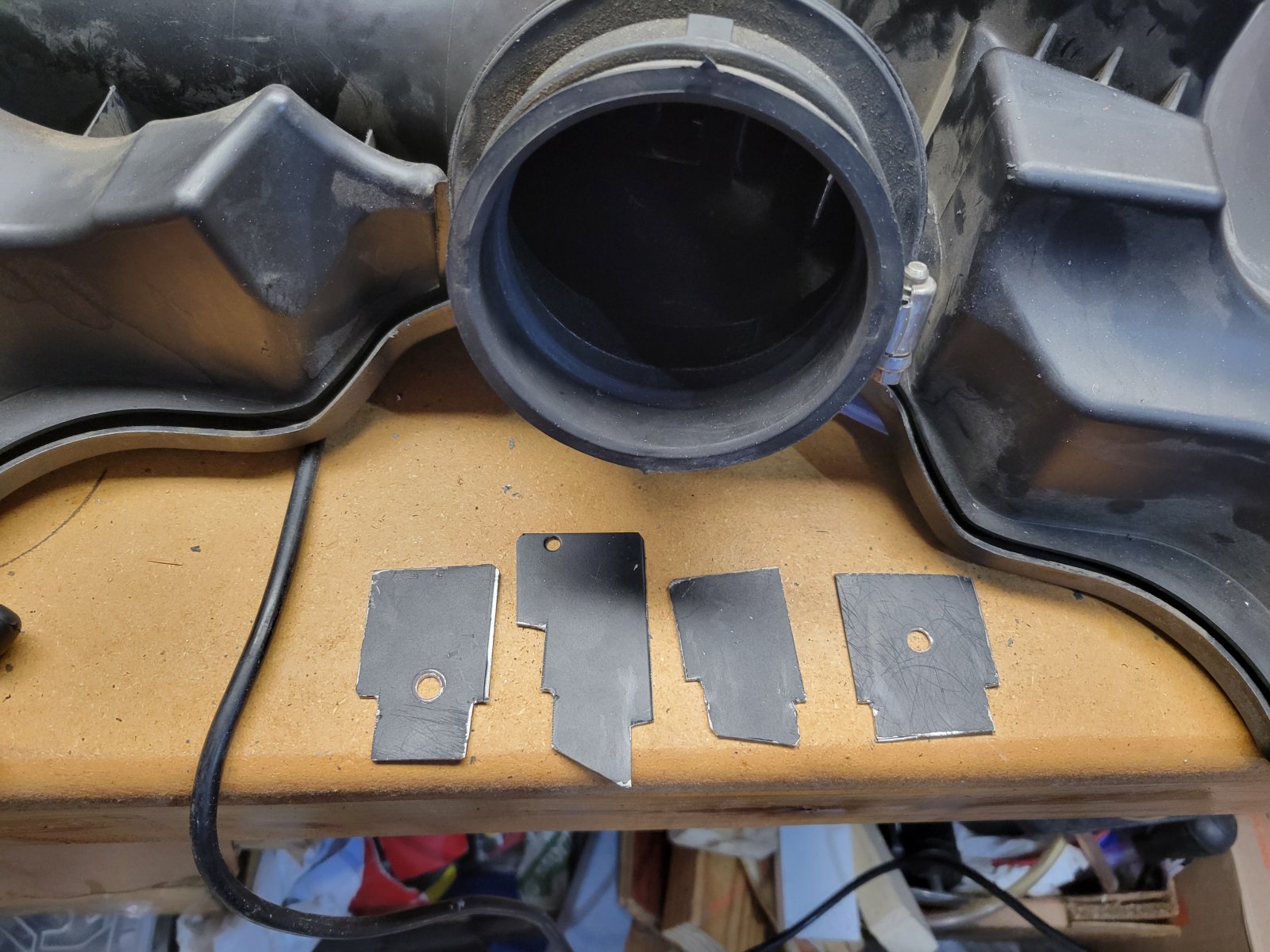

I cut .8mm scrap sheet aluminum into some funny shapes to push into those slots (note the 3/8" holes for the 2 crankcase vent chambers). It was a ton of cut, check fitment, mark, cut again, check fitment, etc. to get to these shapes. I left extra metal at the top to have something to press the plates in with and remove them for trimming and sealing. The little hole at the top of the tall one is a leftover from the scrap metal's prior life and is completely outside of the port so it has no effect.

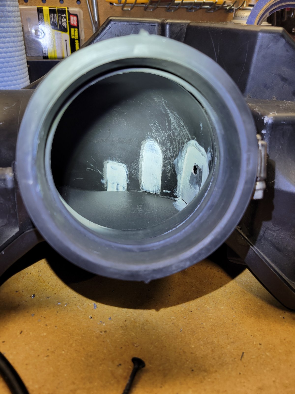

To make sure I didn't have any external air leaks, I globbed way too much high temp RTV on the plates before sliding them in and covered the outside edges with more RTV:
Here's what the 3 visible plates on the inside look like:
I didn't try to totally seal off the chambers (especially the crankcase vent ones that I drilled holes through)-I just got them mostly blocked off to prevent them from doing their "muffling" job. You can't see the 4th plate from the inside but in the RTV pic, you can see it slotted in. Forgive the random ugly scratches which are blind misses from 60 grit sandpaper I used to get errant plastic blobs off from the slotting process.

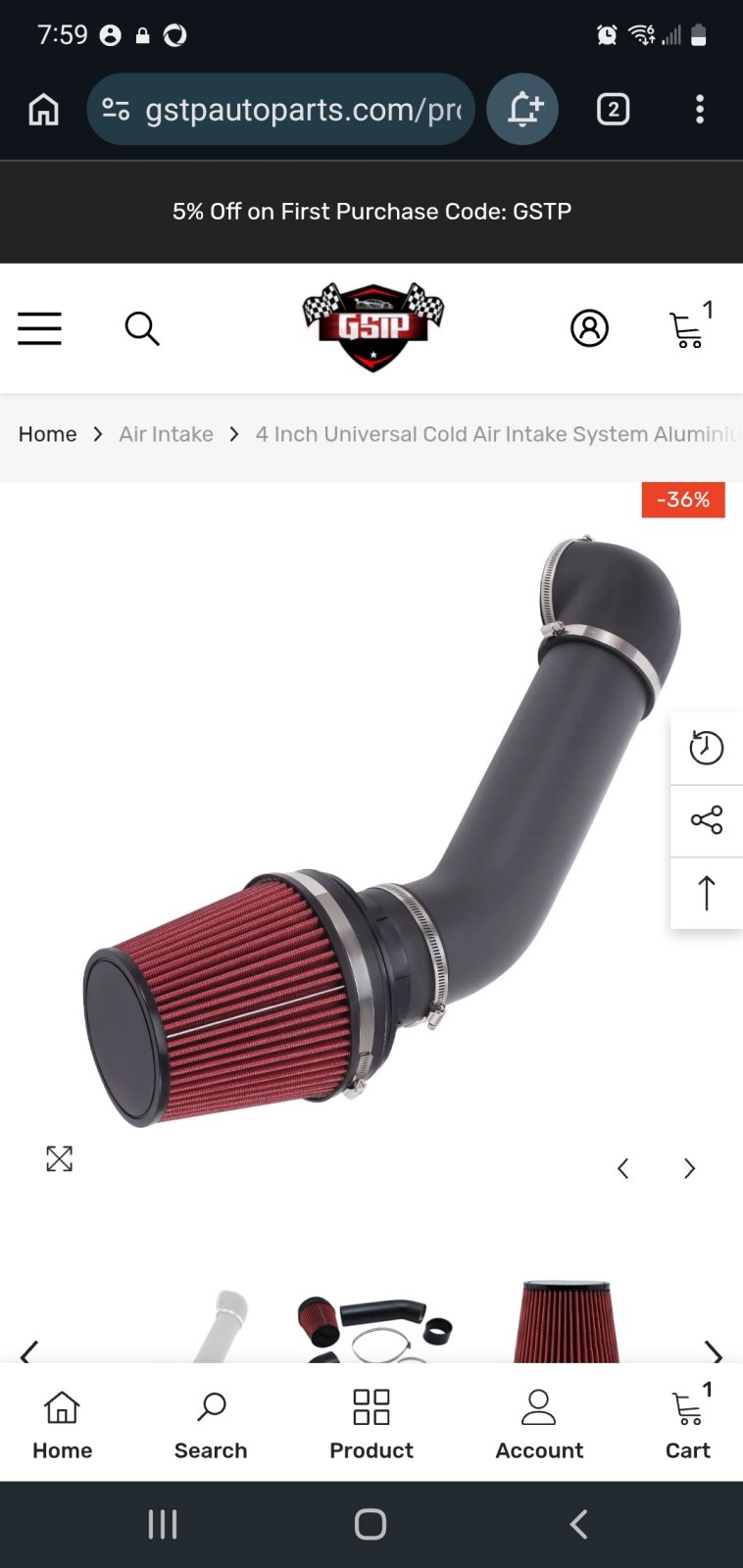

LsHart
Senior Member
Dec 31, 2025
710
664
This one is 89 bucks.
madmax032
madmax032
Mar 22, 2026
27
27
Leesburg, VA
What I don't like about those ones is the tube is usually metal (heat conduction), they usually have an iffy oiled air filter, and their "air box" doesn't seal out hot engine bay air as well as stock or something really good like an Airaid intake (or in G8 land, Rotofab). Didn't stop me from being quite tempted by one like you posted, though I went a different direction: the super cheapskate+way too much fabrication effort route.
