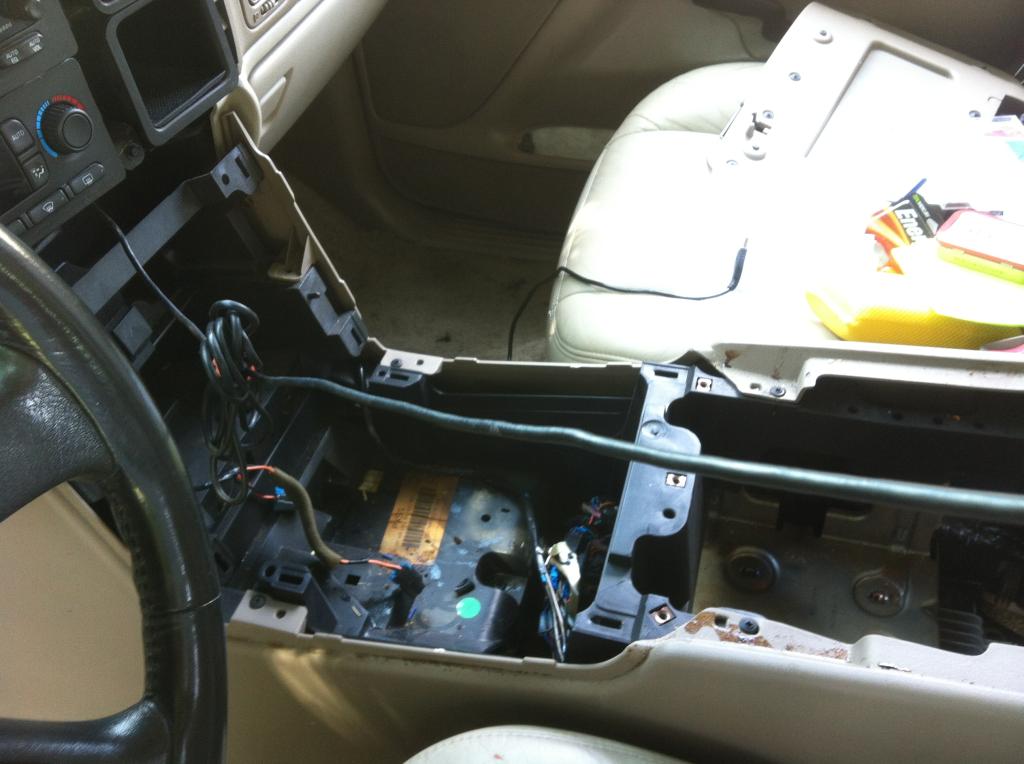

Got it installed. Ended up having to cut off the face of the box and use MDF board. It's a little offset from the grill but it's recessed enough that it shouldn't hit the grill while extending.
Does anyone know the wattage of the factory amp?

I installed 4ohm DVC subs wired in parallel and they sound pretty good. The stock bose amp pushes quite a bit of power at 2ohm. I just replaced the console sub (6.5") in my 04 with a Kicker CVT 2ohm and it drives the heck out of it.
I'd replace everything in mine, but I don't want to lose the rse functions, or have to worry about my windows being knocked out.
justinlw
Jun 25, 2014
102
You have to remove the seats, then the console. It's under the front section of the console, no other way to access it. Go to JL Audio's website and download install PDF for your truck's stealthbox, it walks you through it.
