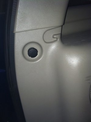

How did you get to the factory sub? More specifically did you have to and how did you take this thing off ImageUploadedByTapatalk1405558401.819464.jpg

The little black knob unscrews like any bolt. Pull the upper pillar covers. Then the top and bottom door sills for the cargo area. Then you should be able to wiggle the drivers side cargo panel loose. You won't be able to remove it unless you also remove the drivers side rear seat belts and C pillars.

I've been hesitant about messing with the bolts because I wasn't sure if they screwed in or not
