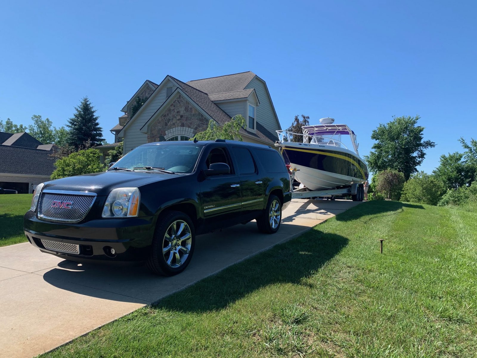

Yeah, the Yukon can handle ANYTHING.....
Thats a Donzi 35ZF Center Console
