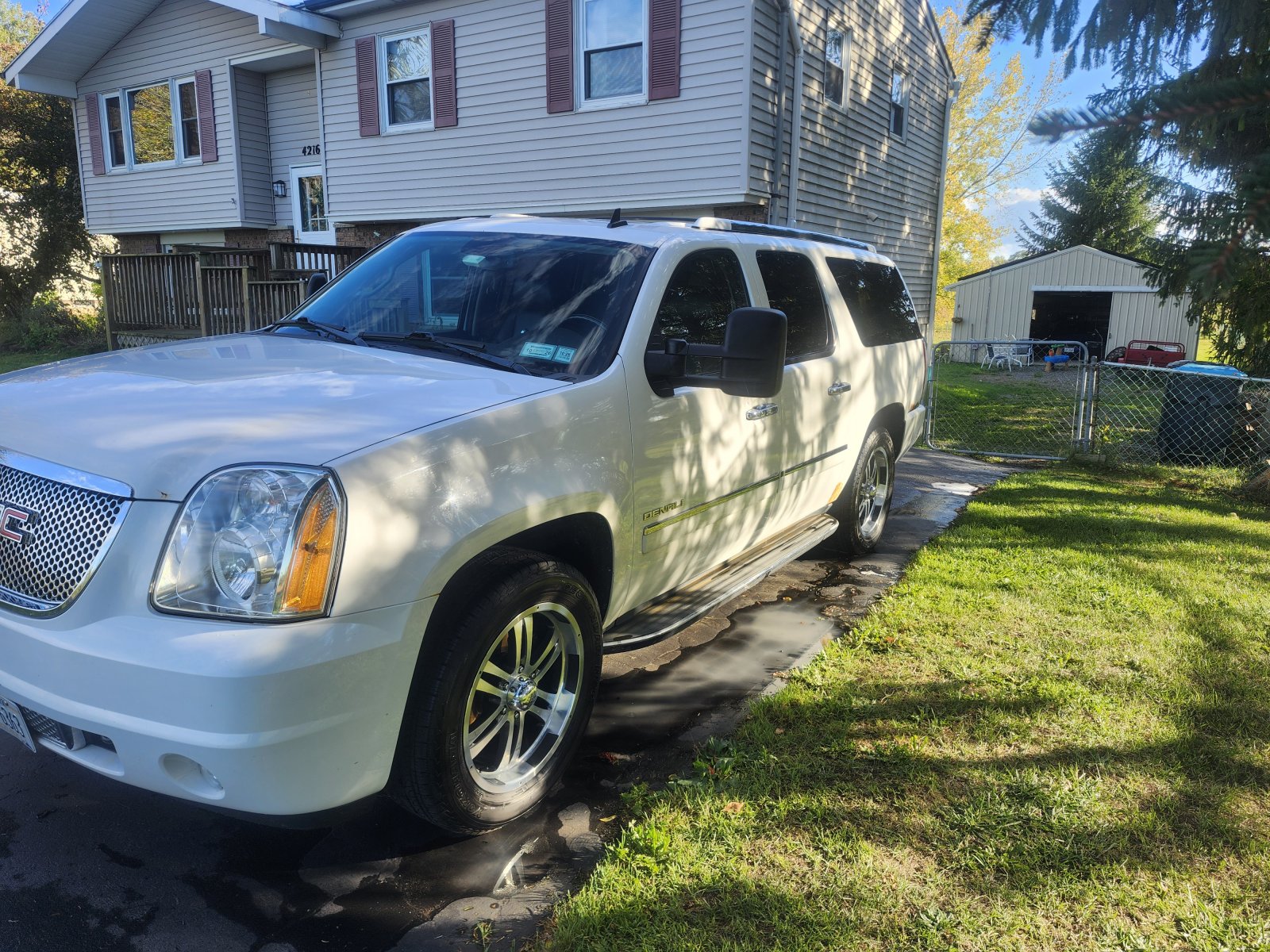

Hello all,
I've got a 2011 Yukon XL Denali. Had it for about a year, has about 170K on it. Truck has been a blast! Comfortable, smooth, affordable, and fairly easy to work on. It's a GM truck after all!
I've had to do a lot to it. Upper and lower control arms, front brakes, calipers and lines, tires, pcm relay, starter relay, AC relay (pattern here?). Also oil cooler lines amd the heating and cooling unit in the driver seat.
Some things I've noticed while driving it that I want to know if you all see it as well. Oil pressure. Goes from above 40 to under 20 when hot. I've seen it go slightly lower when coolant goes over 210 but never enough to be scary. Truck likes to heat up to over 210 when either the AC is off or when towing heavy. It has never gone above the line between 210 and 240, but in the summer or when pulling our 30ft camper which weighs over 6,000 lbs it goes over 210. This truck tows incredibly well for a half ton, but it definitely works hard and I want to know if this is an average experience.
All in all, great truck. Has been great for my family and has opened my eyes to how fun SUVs are. Would love any input people have on my trucks quirks and if there is anything any of you have done to, shall we say, increase the durability and longevity of your ride? Thanks for reading!
