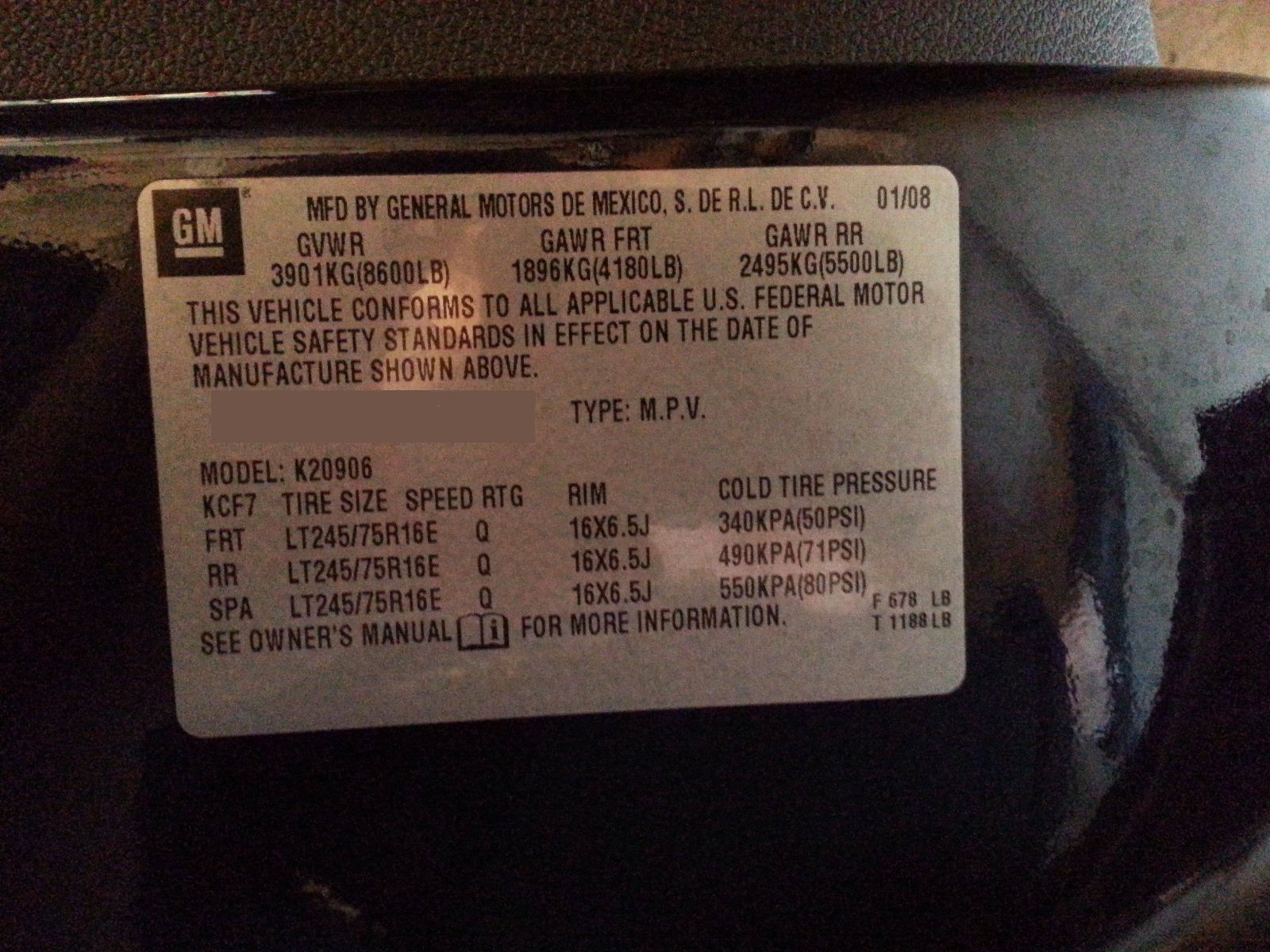

Here's the loading sticker for my 2500:
And the rear axle rating? The limiting factor is actually the rear leaf springs. The axle itself is rated to 8600 lbs, and the two rear tires can handle a little over 6,000 lbs. So I no longer worry about overloading it. And notice the axle weights add up to 9680, even though the GVWR is "only" 8600.
